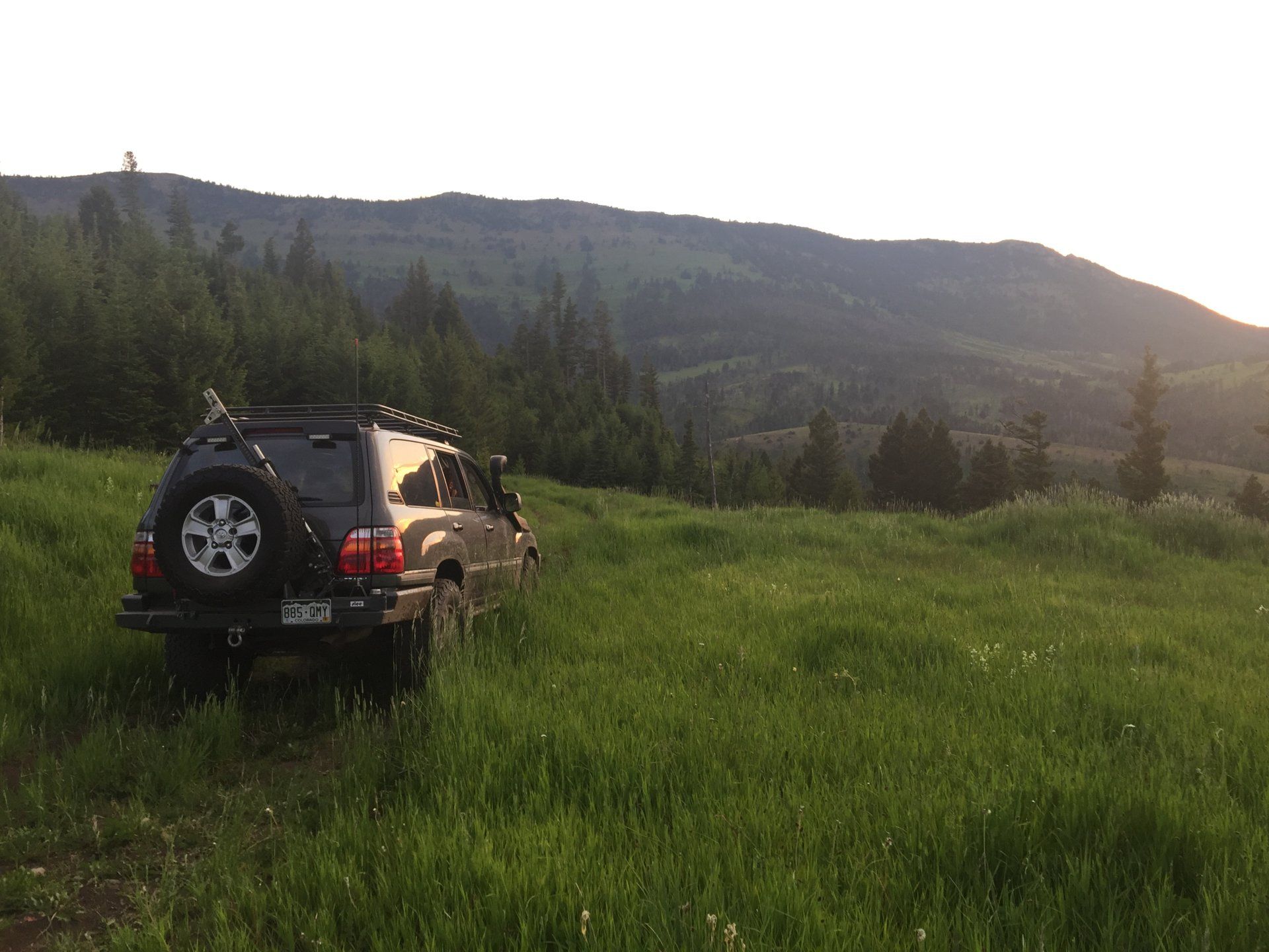

Ripped off my HAM antenna my trusty Comet SBB5 again... I think I am going to go to a hood mount. I am also exploring new antenna options for trail work for the dual band HAM. I have a SBB-1 that I use for trail work, but each time I have forgotten to swap it out when on the trail I have yanked it off. This time it was donated to the forest... the SBB-1 is a great trail antenna but it sure doesn't reach out like the SBB-5.
So what is the best overall HAM dual band antenna for a trail truck. Montana's trails are WAY tighter with brush compared to Colorado. I am adding pin-stripes by the dozen each weekend.
Thoughts on mounts? Gamiviti? Bumper mount up front?
Pic from the other night on another barely there trail...
