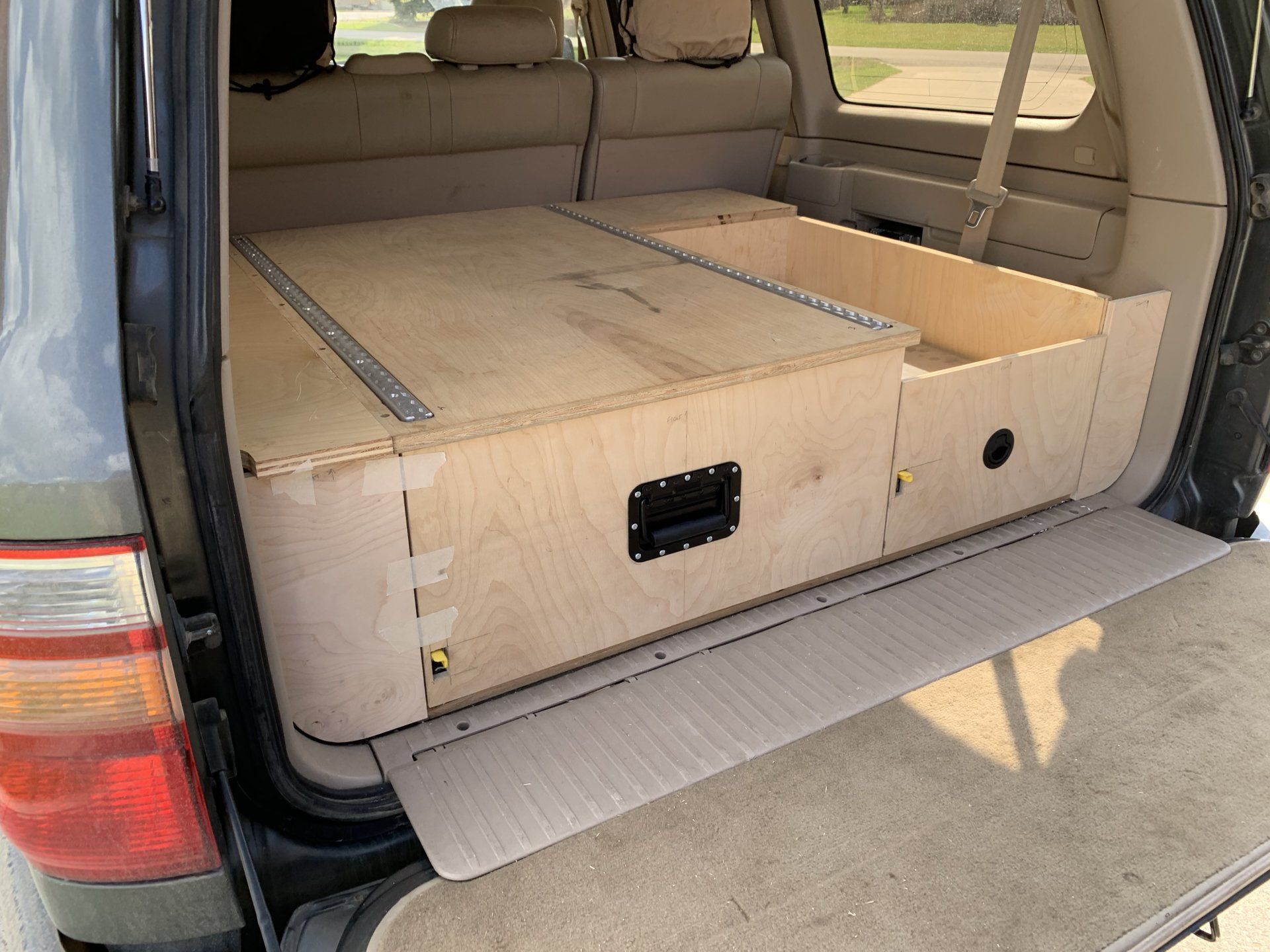

Lots to update. Been working on my drawers...

I'd like to meet up and see these. Very similar to what has worked in my 80 for 15 years and I have plans to rebuild this season. I'm also considering a water tank.

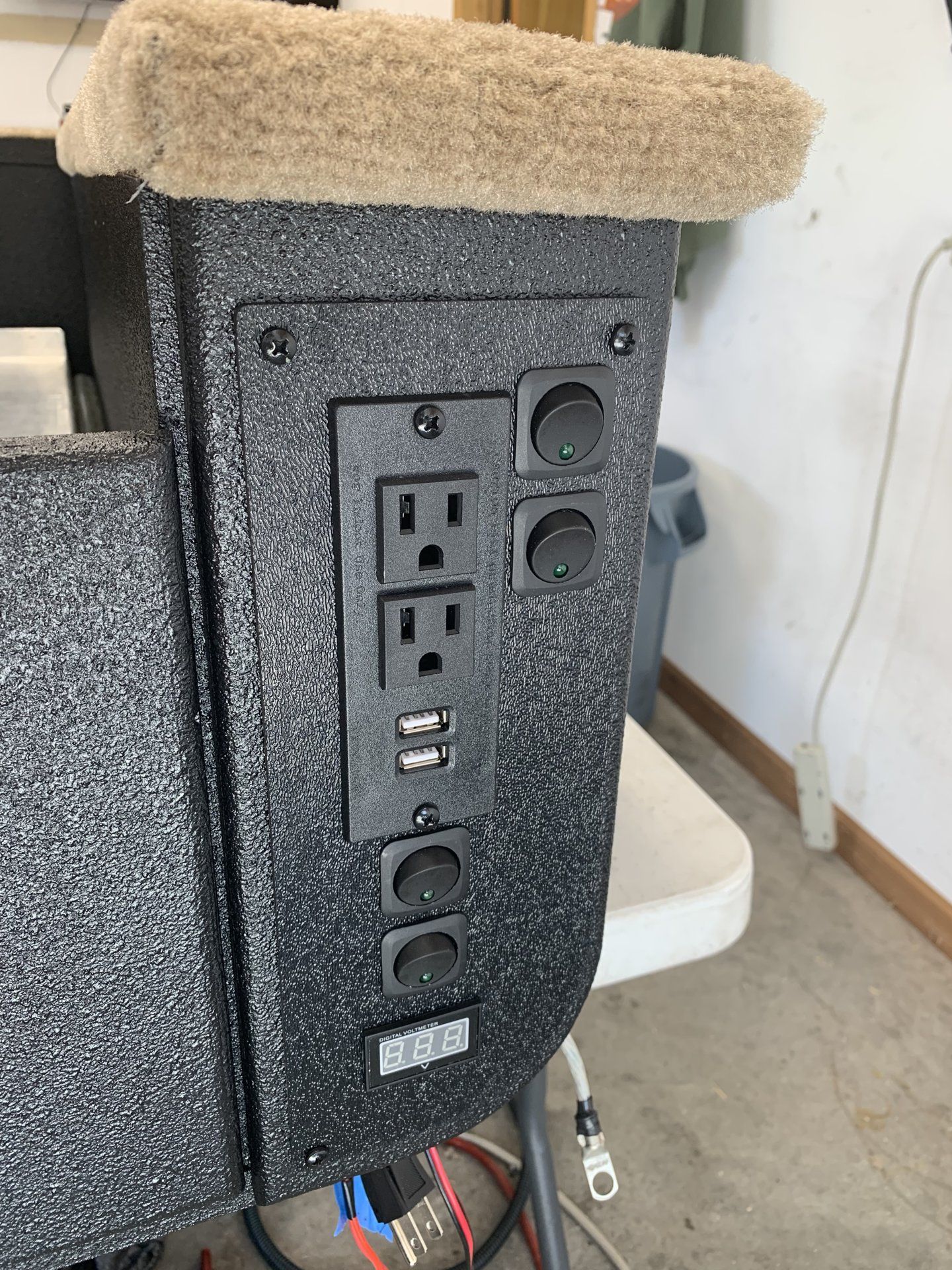

I built a quick and dirty electrical panel to house some of the electrical system. I used a textured piece of ABS that matched nearly perfectly.

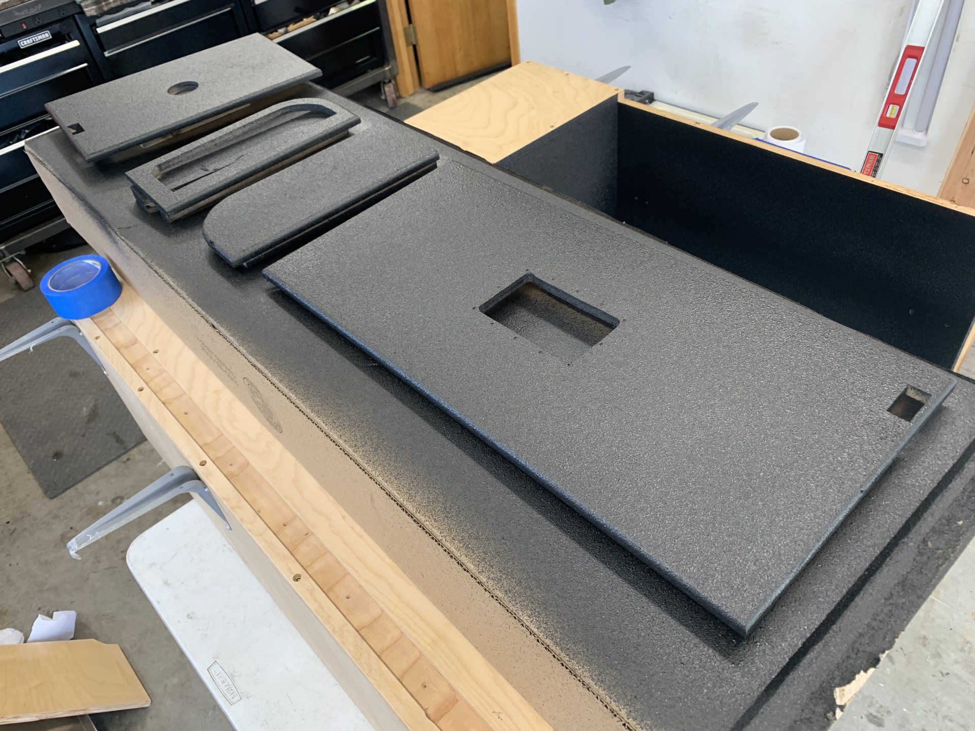

First time using Raptor Liner... what an awesome product that far exceeded my high expectations. I am going to spray this stuff in the tub of my FJ40 next spring and I am excited to use it again.
