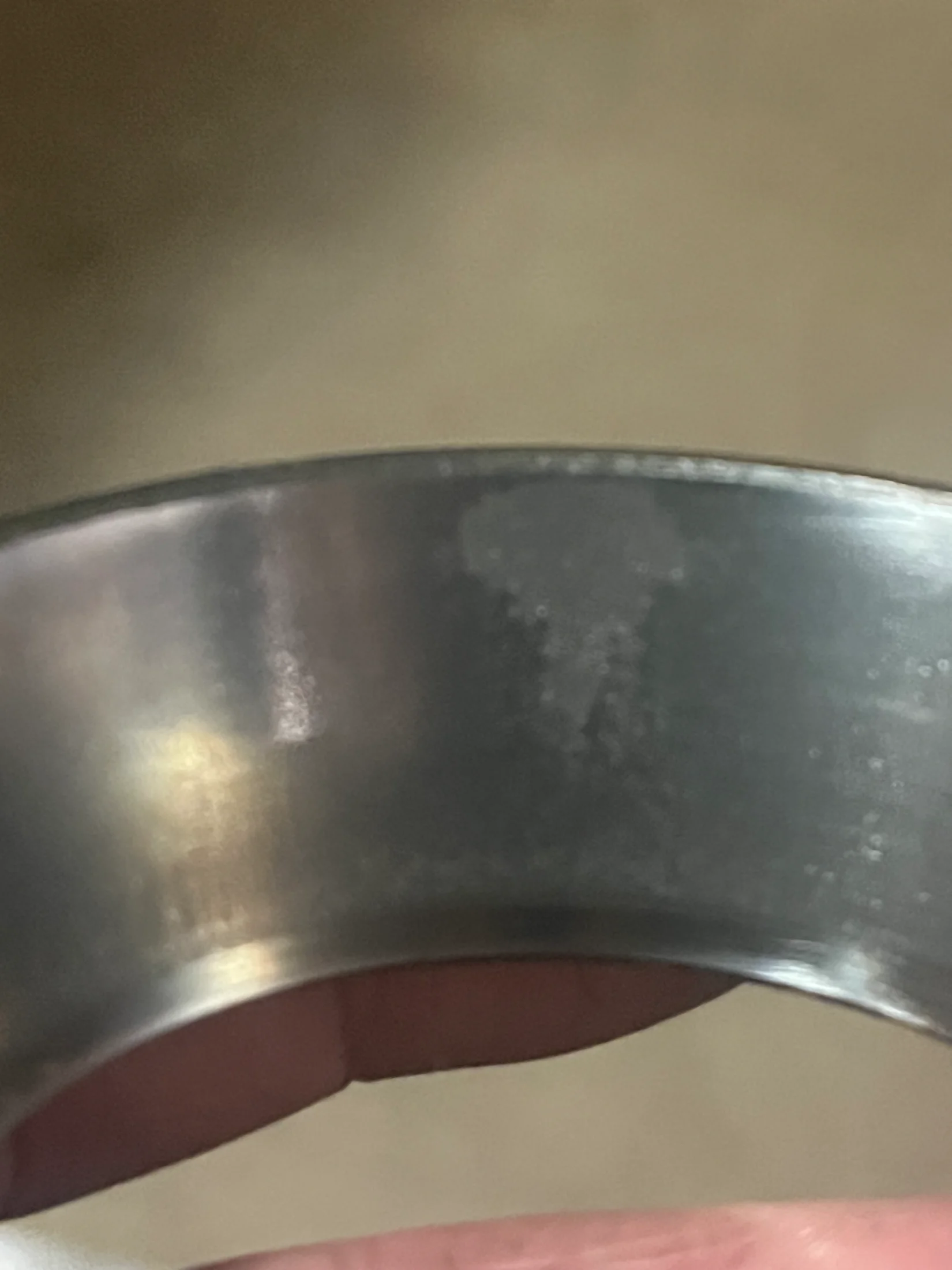

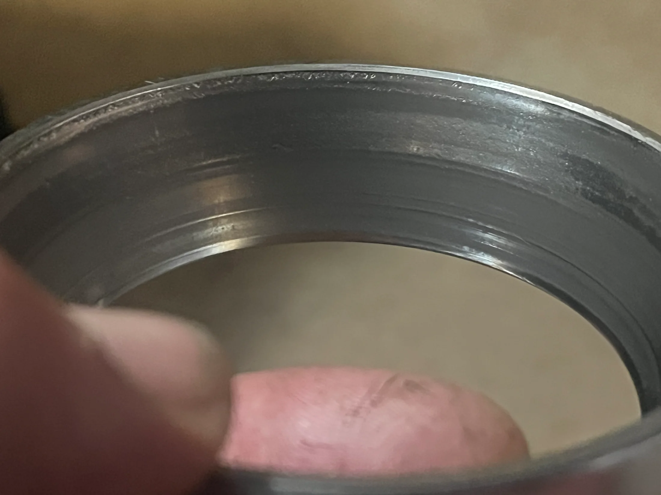

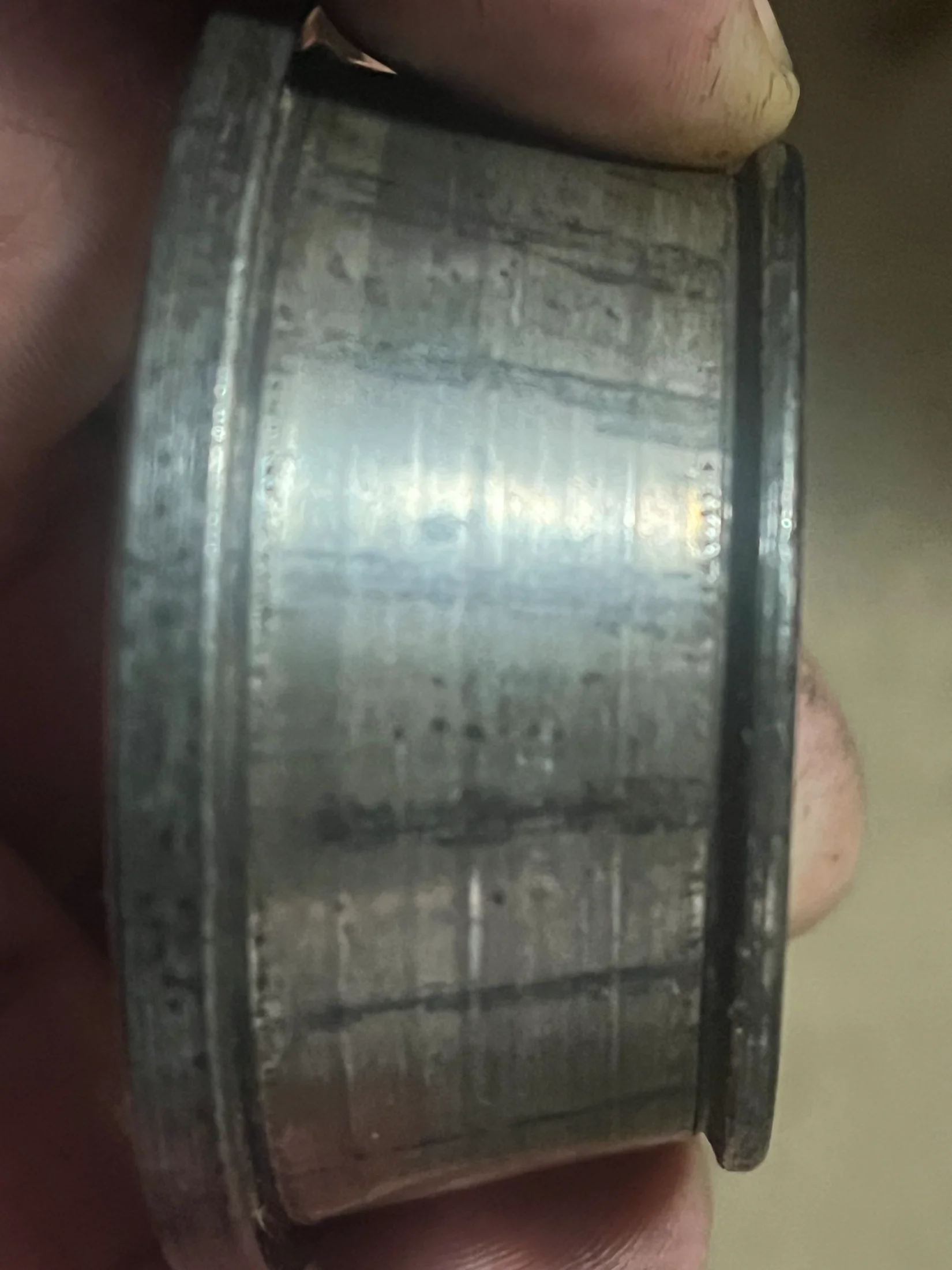

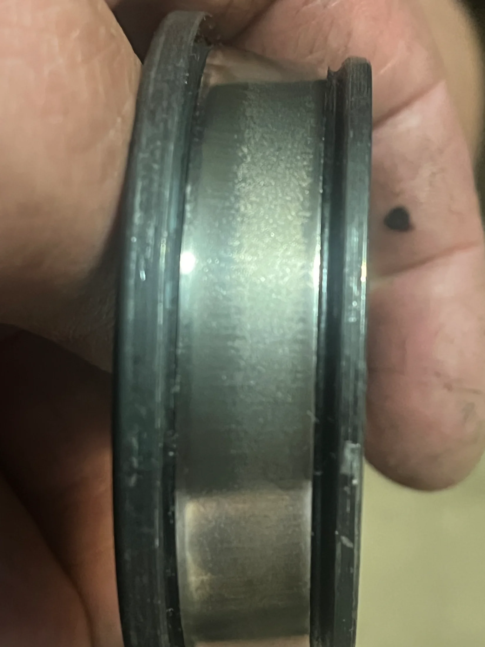

Carrier bearings appear to be the same as the inner rear wheel bearings. If they’re big enough to hold the weight of the truck, the carrier shouldn’t be a problem.
I’d just sleeved the pinion flange and replaced the pinion seal. Despite still being a snug fit and no visible damage, there’s 2-3’ under the ambulance that is covered with gear lube. The pinion shaft had too much play. Hence why the new bearings.
Bikersmurf
As much as I generally don't like to fix things that aren't broken, if you have play in your differential and/or don't have some preload on the pinion bearings, you should pick a good time to service and inspect your differential(s).
If your bearings look like this...
img_5733-webp.3989032
img_5732-webp.3989033
img_5731-webp.3989034
img_5734-webp.3989035
If I'd looked at these before the last road trip, I'd have replaced them before leaving. I don't know how many more miles were left in these before they'd self destruct... but I'd rather not find out. I've replaced bearings that were in much better shape.
