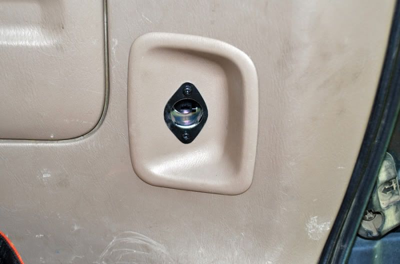

Wired up an Engel Posi Lock in the factory cigarette lighter position. I tryed to fit it in so I could have both plugs, but due to the body panels behind the plastic there, that position is the only place with room behind for the long plugs. Maybe I will eventually squeeze the cig plug in next to it if I can find a way to mount it.

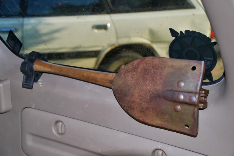

Mounted an old WWII shovel on the window sill in the rear. Got this idea from Weezerbot and her flashlight (I'll be putting a mag light in the same spot as her too :snorkel:) I did this because I don't feel it necessary to carry a full size shovel around all the time, but I do want this along all the time, and don't want it just loose.

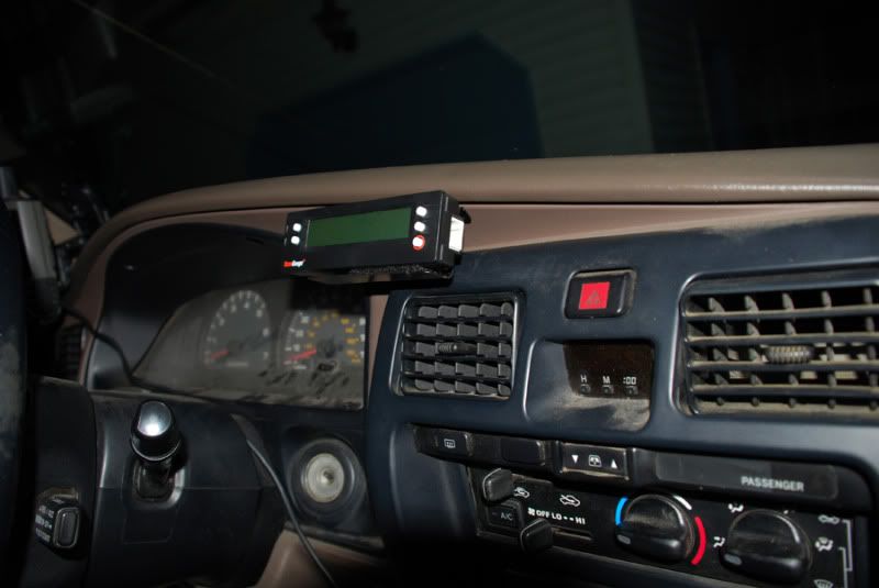

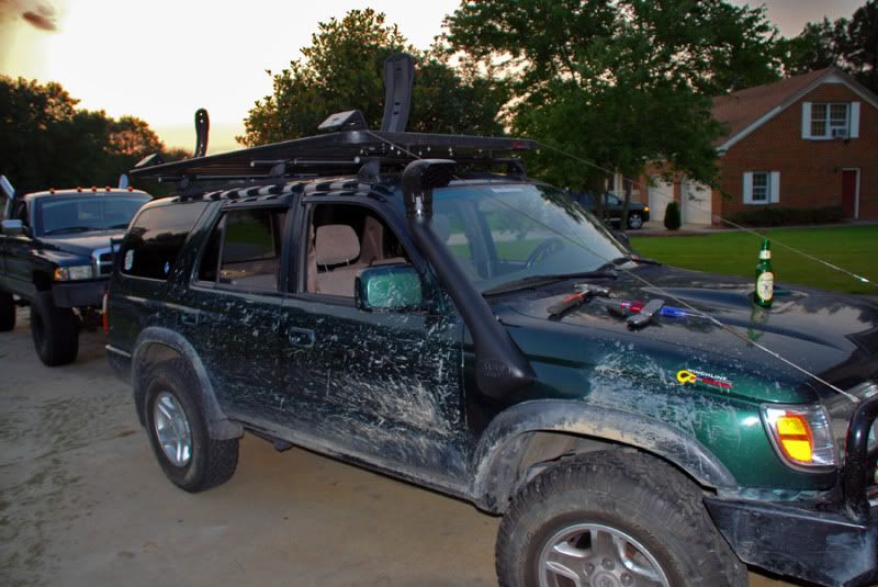

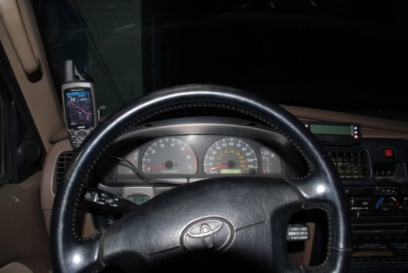

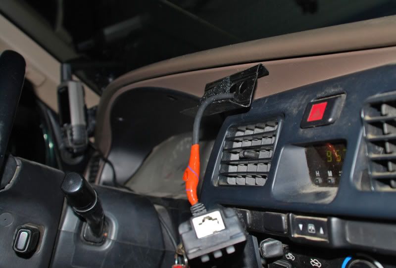

Small update for the night:
Installed a ScangaugeII and made a little bracket to mount it to the dash (you can also see my thermometer peaking out left of the steering column).
I also installed a Tacoma Safari Snorkel. Here is a pic of it soon as I finished. I will do a write up later when I have more time and am not so tired.

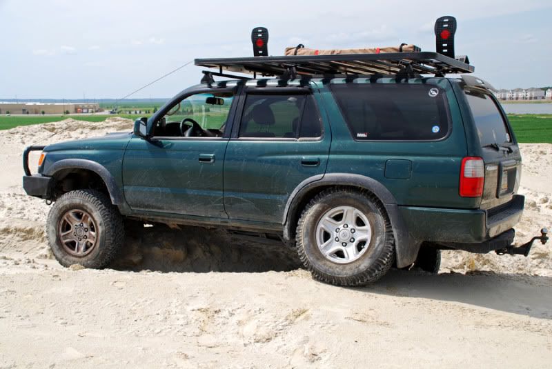

Where did the roof rack come from I could have sworn it was mine then realized it was a frontrunner.

I got the Front Runner from Paul at Equipt. I think my rack is almost identical to yours (think I looked at buying yours?). I went with this one because it was supposed to be narrower (48") then yours, but as it turned out it's pretty much the same dimensions (55") as yours is/was.

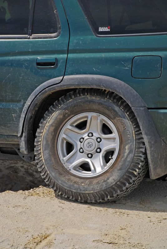

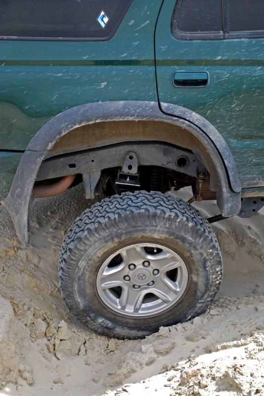

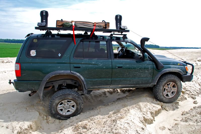

I got the Sonoran Steel lift installed quite a while ago, but have been quite lazy in posting the few test pictures I took the day I installed it.
I am very pleased with the ride quality of this setup. It rides almost as well as a Cadillac but with far better off road performance. The one thing I need to change are the 10mm bolts that hold the fender flare in place. One in particular sticks out and at full stuff on the left side it catches the tire lugs and makes for some horrid noises (though fairly harmless).

Thanks! I'm really liking these tires. I got this size only because I got an awesome deal on them and I didn't want to re-gear. Now that I have them though, I love em! Their plenty big enough, a re-gear might still be nice, but definitely not necessary, and I'm really liking the look of that size in the wheel well. :sombrero:

Sorry to bring back the dead, but did you do a write up on the snorkel install? Thats coming for me soon and trying to get my ducks in a row.
Nice truck!
I have a 2001 sr5 with the fat flares so it was a bit different than you have but also had that same annoying bolt head grabbing the tire lugs. It actually started to cause some damage to the tires so I ended up just removing the bolt. Havn't needed to replace it.
What kind of cross bar are you using at the front of the rack? It looks nice and low, which is where I want the rack to sit. How tall are the spacers you needed? I am thinking of building a full length rack and need an additional crossbar option. Thanks.
