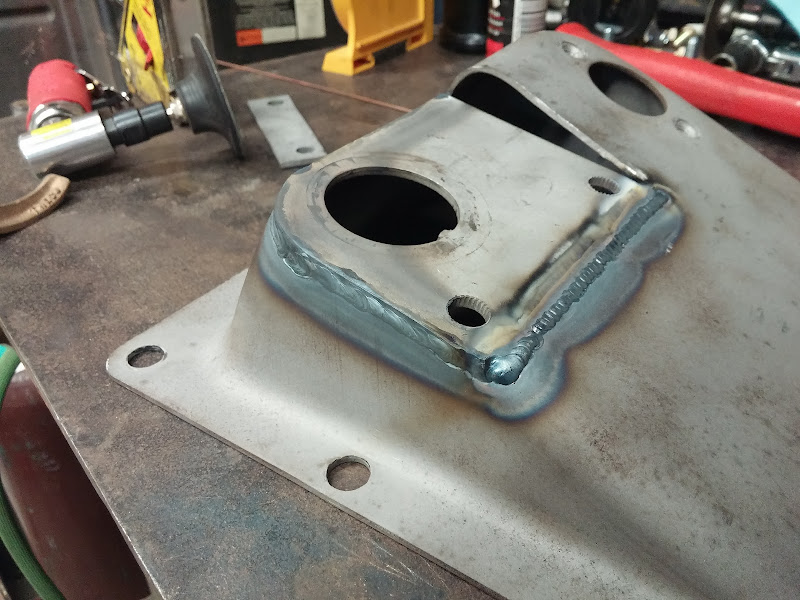

Modified brake mounting plate to tilt the hydroboost/master cylinder up enough to clear the top of the inner fender.
I'll use a spindle nut with a modified socket to bolt the HB unit to the mounting plate, so that if I ever need to remove it in the field I'll have the tool with me, rather than using the stock large square nut that came with it.

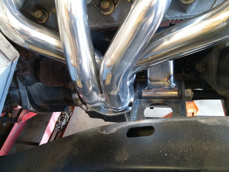

Motor is in and bolted up to the transmission. I built new motor mounts, the drivers side matches the location of the existing frame side motor mount (for the old TBI 350), the passenger side is more like a normal LS motor mount to clear the AC compressor. I didn't like the original mount I'd built off the frame on that side anyways, so it was an opportunity to re-make it better.

The passenger side motor mount needs to move forward a bit more, the header flange just hits it. Not a big deal, I can move the mount forward and inch easily and have lots of clearance.
