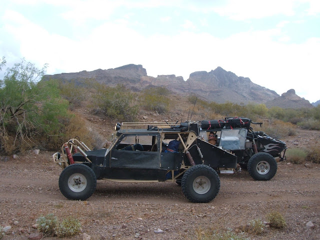

Reading someone's travel blog I clipped this pic because I thought it would make an awesome ride and a good project some day. I know the person took the pic in a museum in the NW but that is about all I can remember of the details.

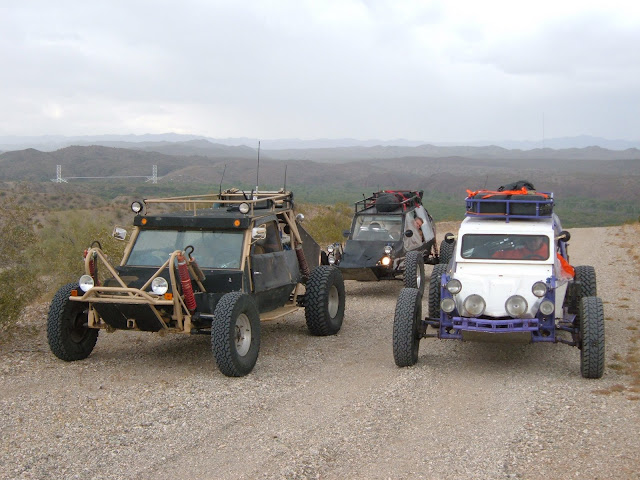

You'll like this Bug. 1965 Factory convertible, Full Cage-- Tied together from the front to rear torsion tubes. A and B pillars Corssbraced to the tunnel and tied together over the rockers. Very functional and kept the original body and pan intact. The three pillars are welded to the body at the dash, window frame, door frame and the package tray.
Fuel cell is a 10 gallon Jazz product sitting on the package tray behind the rear seat. Rear seat is made from 3/4" marine grade plywood. Used as storage and for kids and small adults.
I've owned it for 10 years and it's been everywhere; Mountains, Deserts and Sea....It's a blast. An awesome tow vehicle behind the motor home..
The Bug is a keeper.
