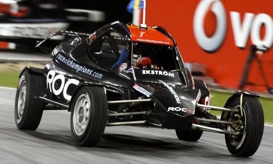

The buggy photos reminded me of the ROC Car, the tube chassis buggy they drive in the Race of Champions. While the ROC is on pavement, the vehicle suspension could be modified to soak up off-road obstacles, too.
This photo shows Mattias Ekström, participating in the 2009 Race of Champions in Beijing earlier this month. Ekström won for the third time, beating drivers from several racing disciplines, including Formula 1 and World Rally Championship.
