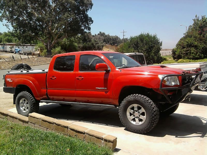

i picked firestone destination M/T's at 285/75/r16. they're great tires: quiet, grippy, and tough. here she sits with the 33's.

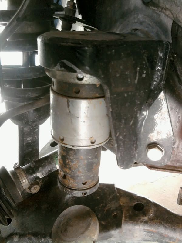

so i said previously i had timbern bump stops. well i didn't like them. at higher speeds they act more like pogo sticks then bump stops. so i kept an eye open for chubbys. after many months of patiently waiting i found a pair for about half price. it took a couple of day's to install the front ones because you need to cut off the stock mounts and drill and bolt the new ones on. the rear needed a modified strike plate so i took it to Demello off road. WOW i love um. the ride is so much better and i never fully run out of travel. but here in lies the rub, no really the tire's rub the bumps at full lock. thankfully the tire are ten ply, and i just remember to make wide turns.

A buddy of mine works at a Firestone and could get me a good deal, but I was reading that they are very soft and wear quickly. How long have you had yours?
phatman
actually they wear nice. i've had mine for 40k and they're at about half tread. i'll give them another 20k and replace them. i'm bummed the they don't make this tire it a 255 size becuase i like them so much but need a narrower tire.
