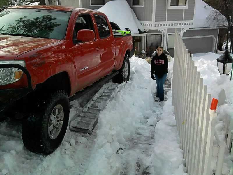

Curious why you still have the stock tires? All that protection and lift is kinda moot if you are still running P rated tires.
Also, why relocate the spare to the bumper? Even a +1 tire fits in the stock location.
phatman
future plans!! i plan on running 33" or 35" tires in a year and those wont fit. protection was first because i didn't want to damage the truck while i was saving for other mods. i found the lift at a great deal that i just couldn't pass.
i'm now saving for a regear, locker or lsd, rims, and tires, while planning out tire fitment.

Depending on the time of year/type of trips, I swap between the stock tires you have (265/65/17 Duelers) and 265/75/16 BFG AT's. The Sport will easily go further off road in 2WD with the AT's than in 4WD with the Duelers. In other words, you won't have to worry about damage as you won't get very far on the trail with the Duelers. FWIW- 265/75/16's will fit your truck without any trimming.
Doesn't your truck already have LSD?

ya 17's are ugly. i got new ones a year ago but never updated the pics. now I'm running 33's on 16 inch FJ SE rims
