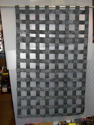

I have a couple of these that I might make into cargo net. They are very strong. I just have to figure out a way to mount/secure them. 58"W x 37"H
http://cgi.ebay.com/ebaymotors/Heav...007QQitemZ170108811825QQrdZ1QQsspagenameZWDVW
