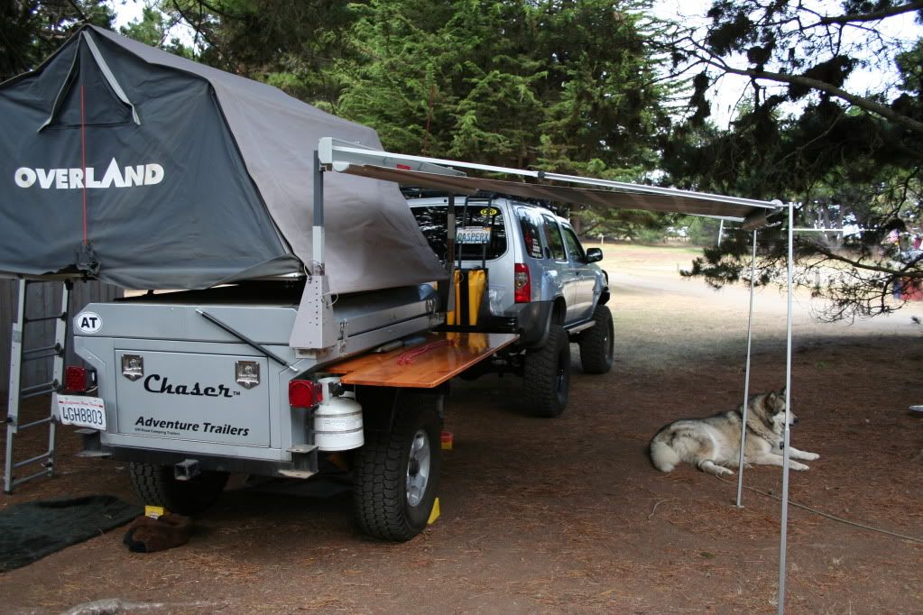

Ok, on to the next part of the Rig. The trailer.
It is a basic Adventure Trailer Chaser model. It has:
Overland RRT with queensize air matress w/pillow top (I like to be comfortable)
19 gallon water tank
2 5 gallan fuel cans
Deep cycle battery in nose box
Engle 45 freezer/fridge
Easy Awn Awning
and tons of cargo room.
The trailer tows like a dream and is the perfect wheel base for the Xterra. It will go ANYWHERE the X can go and more.

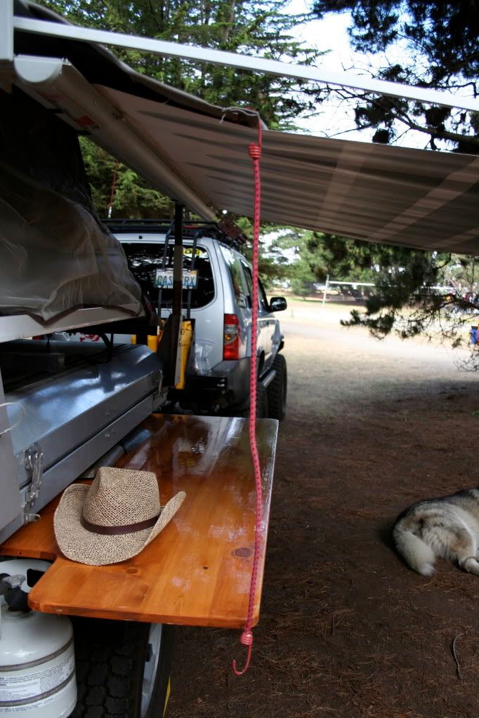

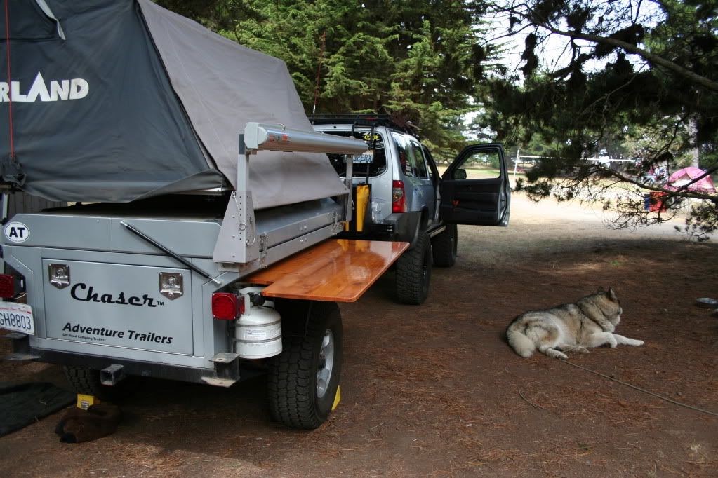

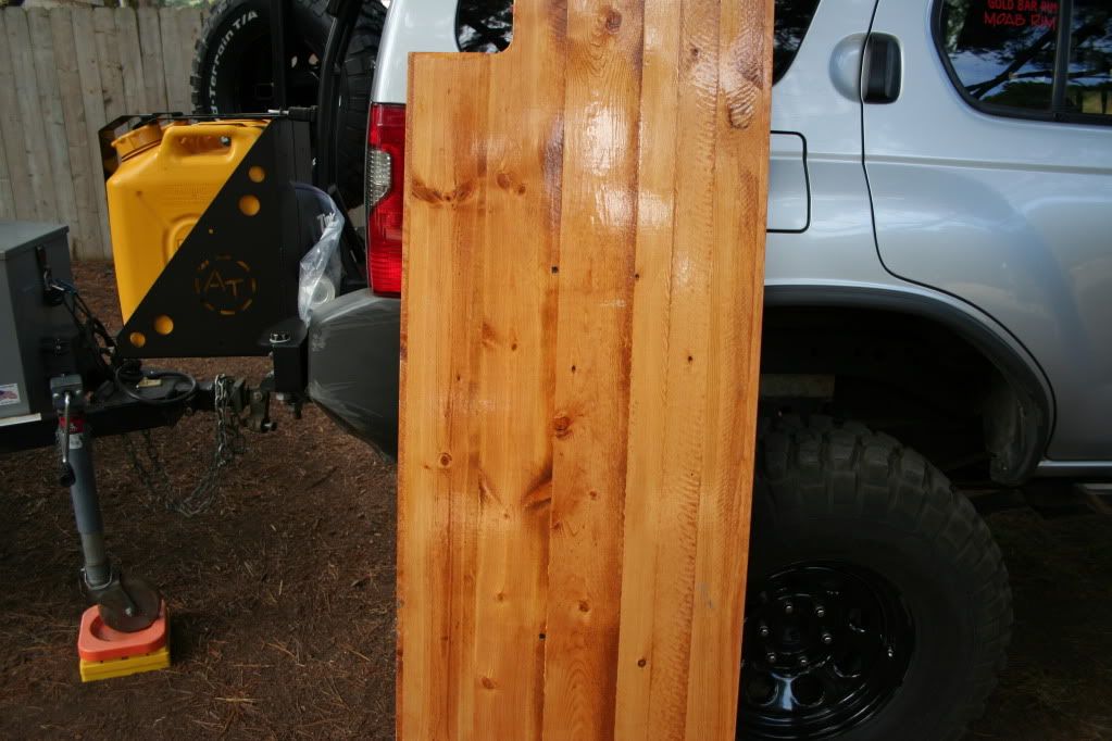

You can get a set of stainless steel trays that attach to the sides for a kitchen setup. I had these at first. They are nice. If you are cooking for yourself, and maybe a significant other they will work fine, however I tend to find myself cooking for 3 to 15 people, so they were too small. Adventure Trailers then designed a table to attach to the fender. I decided to try my hand at making one.
First I added 2 small plastic "bushings" to the fender.
These will keep the table from sliding out once it is on the fender. The side of the trailer will keep it from tipping over once istalled as well.
Next was the table itself. As I am not very good with wood working I chose to buy a pre-built piece. It is made from 5 pieces of 1x6 pine joined together on the ends. I cut it to size and rounded the corners off. I then gave it a light coat of stain and about 7 coats of spar-urithain.
I drilled 2 holes for the "bushings"
Vala, nice big table for cooking and food prep.

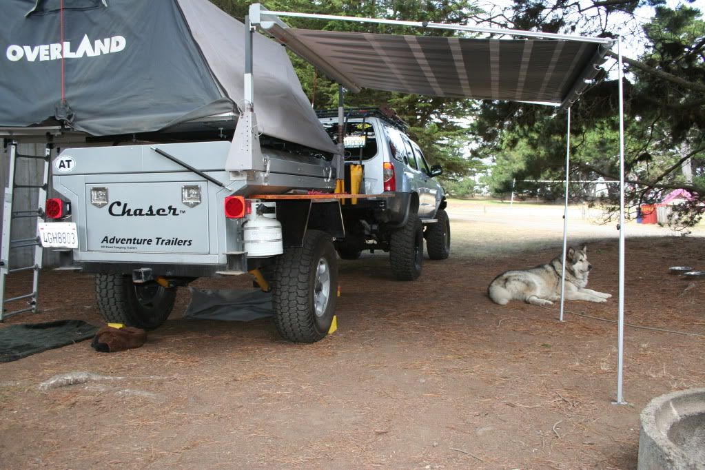

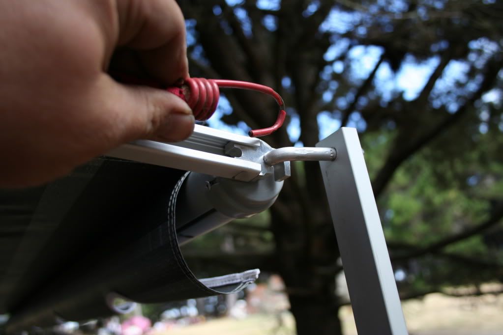

Up next, cover for the kitchen. I added the awning since at least 2 or three times a year I end up getting rained on. I have to say I use it every time I camp. It is nice to have shade, and keeps the pine needles and sap from falling on the kitchen.
One drawback to the awning is the fact that you can't use the poles that hold the tent flap open with it. To fix this I searched around and found the perfect length bungy cord.
One end attaches to the tent flap via the hole for the tent pole.
The other end hooks to the awning leg.
This also fills in the space between the awning and the tent.

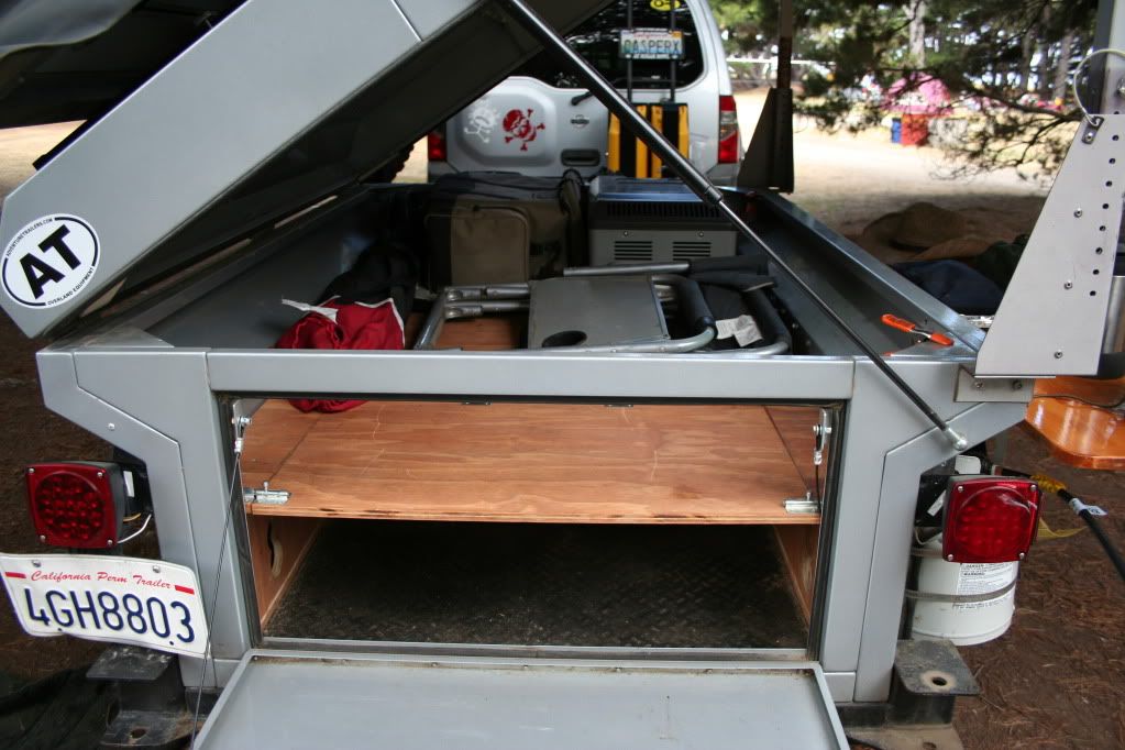

On to the storage.

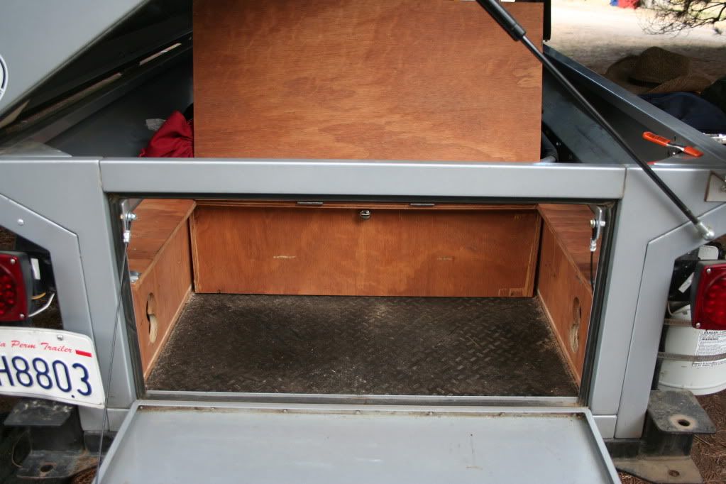

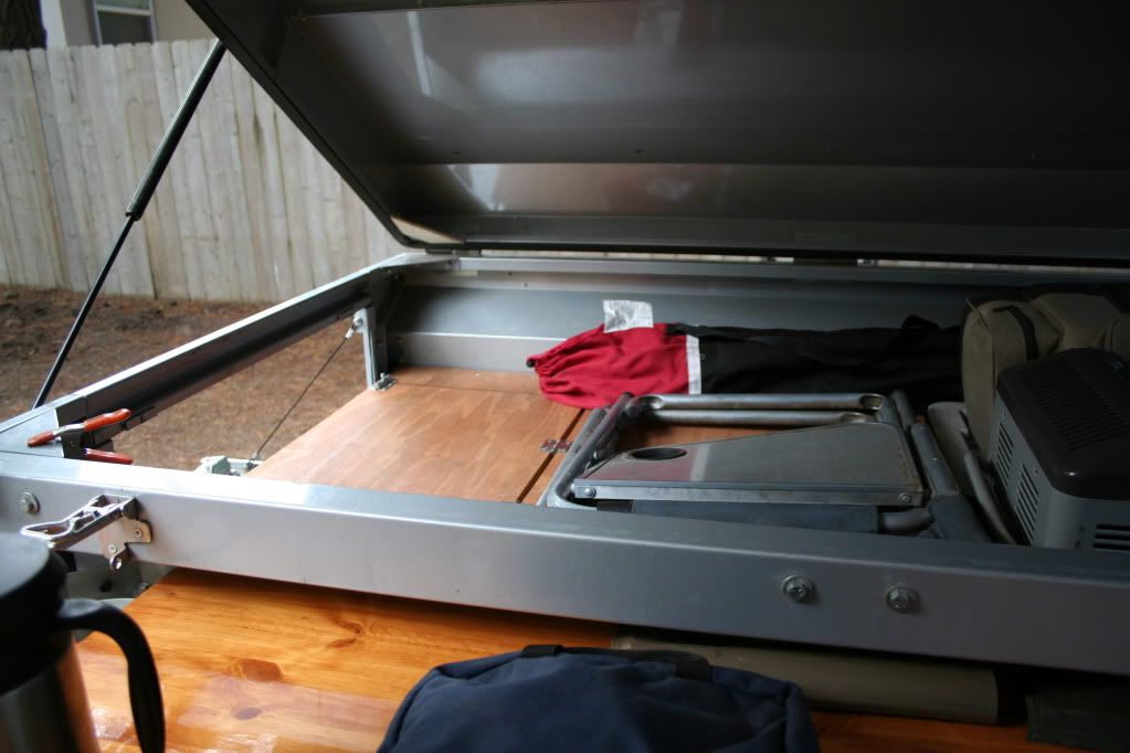

The inside of the trailer box is very big and open. I have tried a few different things to keep it organized and make it easy to access everything.
The fridge is stored towards the front of the box, which gives me easy access to it. Behind that I have a plastic storage container with stuff I like to keep it the trailer "just in case" Games, extra batteries, toys for the pup and such. To the left of the fridge is a platform I made. this supports my chairs, cloths and such and still alows access underneath it.
From the back you can see the storgae for the grill.
The top lifts up to alow access.
Behind that you can see the drawer that sits under the platform.
This houses all of my cooking supplies. Pots, pans and the like. As I said I find myself cooking for more that just me, so I like to have everything I need.

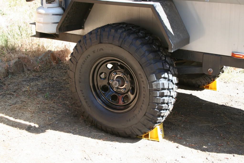

Ok, a small update. You probably noticed that the trailer tires didn't match the trucks. Thanks to ORI and some extra funds I now have matching rims and tires on the trailer.
I have to say it looks much better now.
