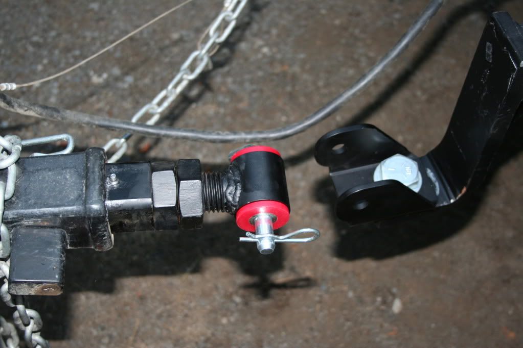

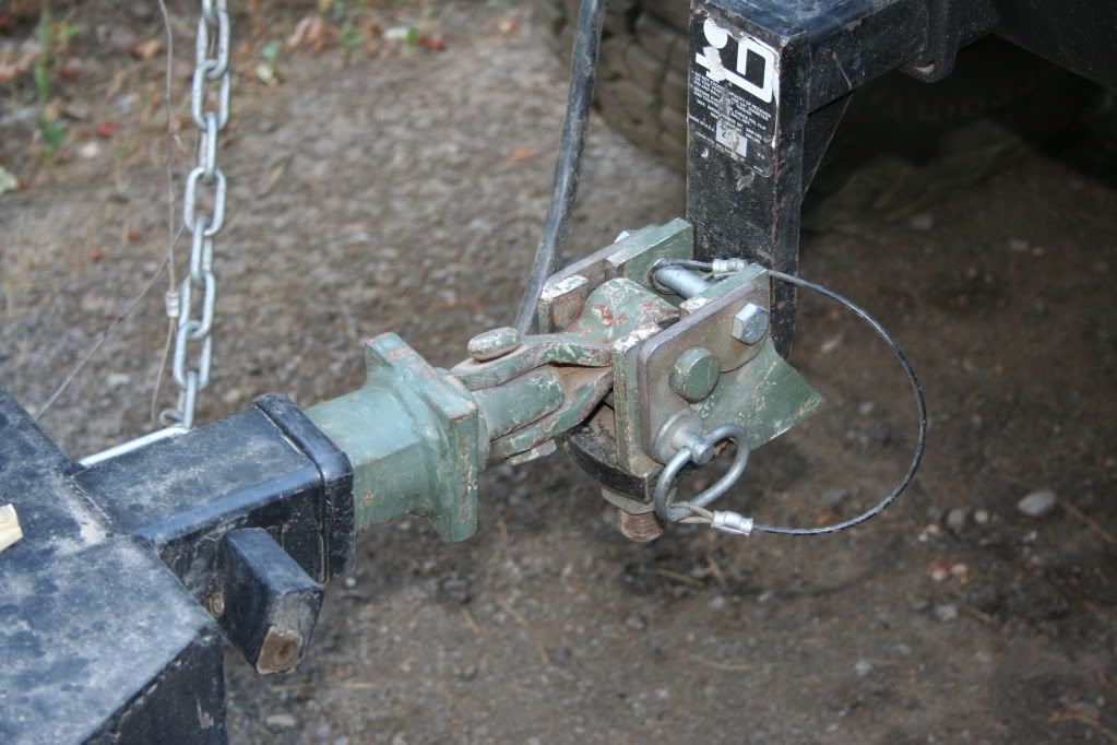

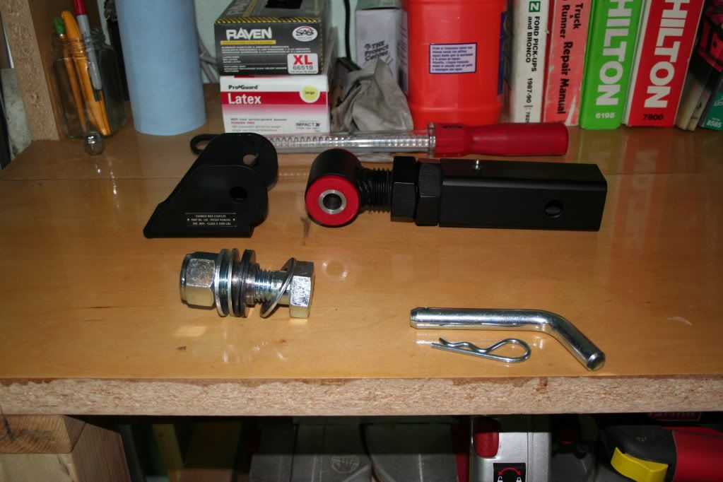

Ok, small update. I decided it was time for a new hitch. My old one was a Lock & Roll. Great hitch, worked well but I bent it before I knew your not suppose to jackknife the trailer.

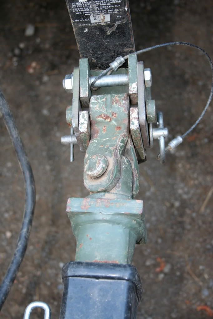

Here you can see the twist in the hitch.
I don't think it would have failed, and it was still very usable but a tad harder to get hooked up since it was bent.

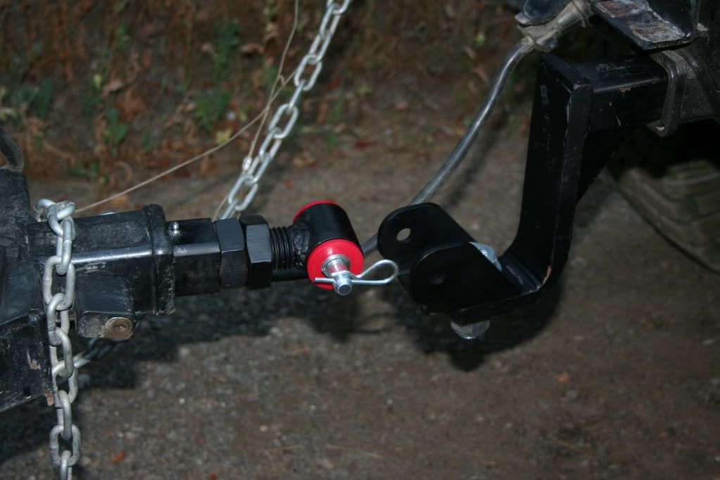

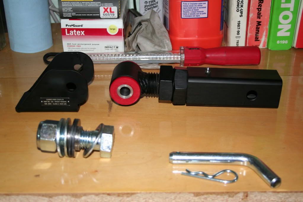

On to the new hitch. AT's multi-axis coupler.
As usual, fit and finish of this product is second to none (and I have a prototype, the production ones are even nicer). I can see how this is less likely to bind up, but I will not be jackknifing my trailer anymore to find out. I do see one small issue, it is a tad harder to hook up to the truck. You have to have the hole lined up perfectly to get the pin in. With the old L & R you just needed to be close and as you lowered the trailer jack you could "rock" the trailer and the hitch would drop into place. It may just take practice, we shall see. Either way I think it's a better coupler all around.

Yea, I try to never jackknife it either, but from time to time find myself in places where there is no other way out without unhooking the trailer. Guess I will be unhooking it.
As to the welds, it's a prototype. They are strong, which is all I am worried about. The production ones look much cleaner.

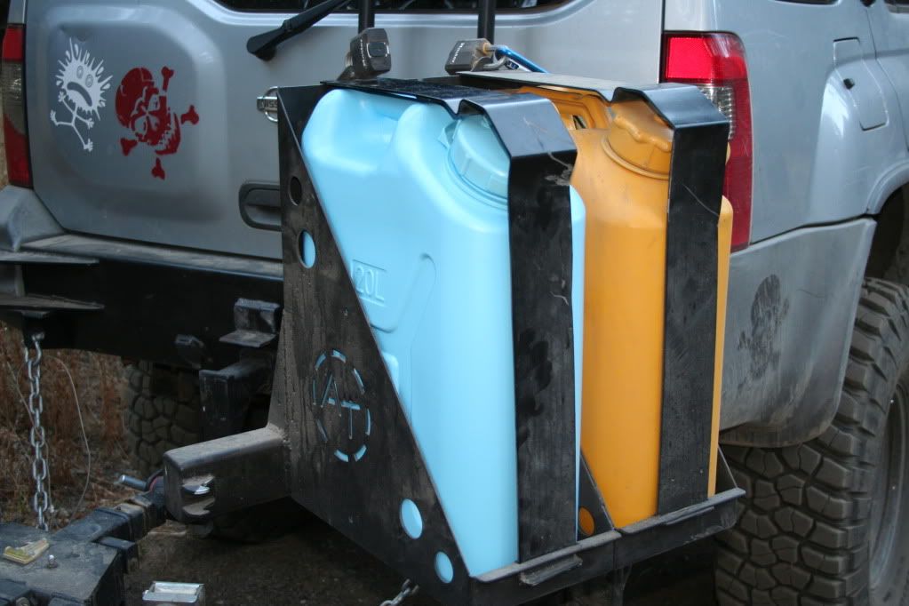

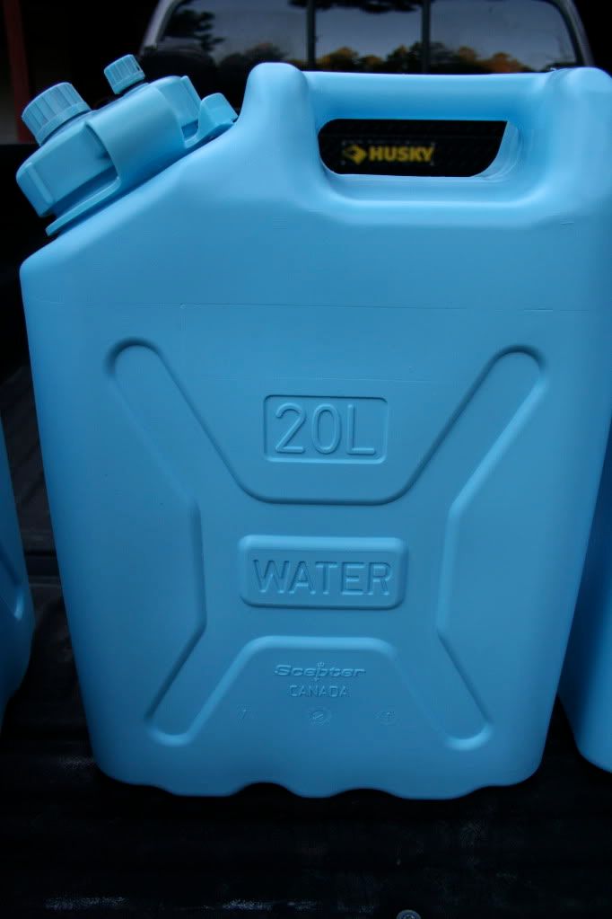

As I do quite a few trips a year where I don't need spare fuel, the 4 fuel cans I carry tend to be just "dead wieght" I also tend to wheel with a group that can be quite large and go through quite a bit of water. The said, I found a place that sells Scepter water cans. It took longer than I thought to get them (3 months)
So now I can carry 20 gallons of fuel, or 20 extra gallons of water, or any combination of the 2. :wings:
Not a big mod, but still a mob.

Grease, I thought I had it greased enough. Guess not. I will make sure to grease the new one more. I do have to say I don't think it is possible to bind this one.
