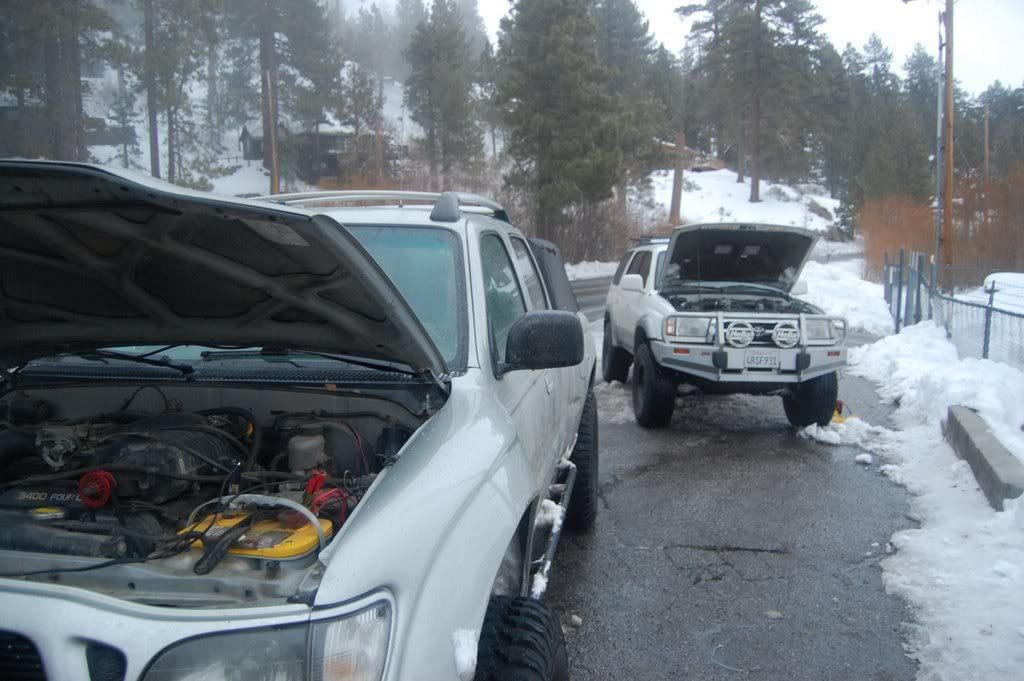

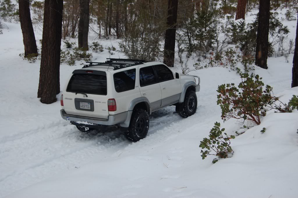

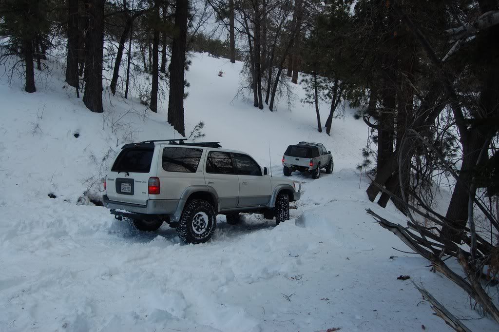

Went up to Big Bear for the day on Monday. Beautiful day full of sledding and back country driving. Visibility dropped significantly coming down the mountain; I'd guess 5-10 ft. on some stretches. Pretty sketchy but a good trip overall.
