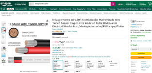

So after all this it seems I'll need to go to 6AWG cable in order to get the 20A charger to be able to put out max output. I presume something like this would work?
I like this one because it has double sheathing and the pos and neg cables are not separate, which should make it easier to install. I'm guessing I'll have to drill a bigger hole in the cab than the one I have for the 8AWG cable that's in there now, but at least now I have a likely culprit for my issue. Thanks for the help!

No prob. However... Why don't you just go 4Awg, and be ready for your eventual 30A or 50A charger? Totally worth the one time cost to do it correct once.
Also, you're still using those oooold FLA batteries! We get less than 2 years here in Phoenix from a car FLA battery before it doesn't charge right! I thought you had replaced with LFP ones. When you eventually DO, you're gonna want a 50A charger, so just get the 4AWG cable now, even the 20A is on the edge of needing 4awg at 30ft circuit already.
Between old FLA batteries and 8awg, I can see your charge issues easily.
