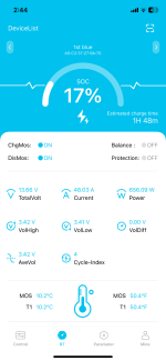

Martinjmper, the 13.32 volts seen on your charging screenshot is curious. My testing with an adjustable voltage power supply shows low charging amps until charging voltage seen on the bluetooth screen rises to about 13.8vdc. My batteries don't fully charge without voltage in the low fourteens.
burleyman
^^^^^Huh Oh! Wrong info in that post. The bluetooth voltage on mine is the voltage of the battery at present. It is NOT the charging voltage applied as mentioned above. You would need to test the charger voltage measured at the battery terminals to see if the charger voltage is high enough for charging. Smart charger maybe not. Adjustable charger below at 14.3vdc. 14.1vdc at the battery terminals
The pictures below show the difference. Values aren't identical, but ballpark.
