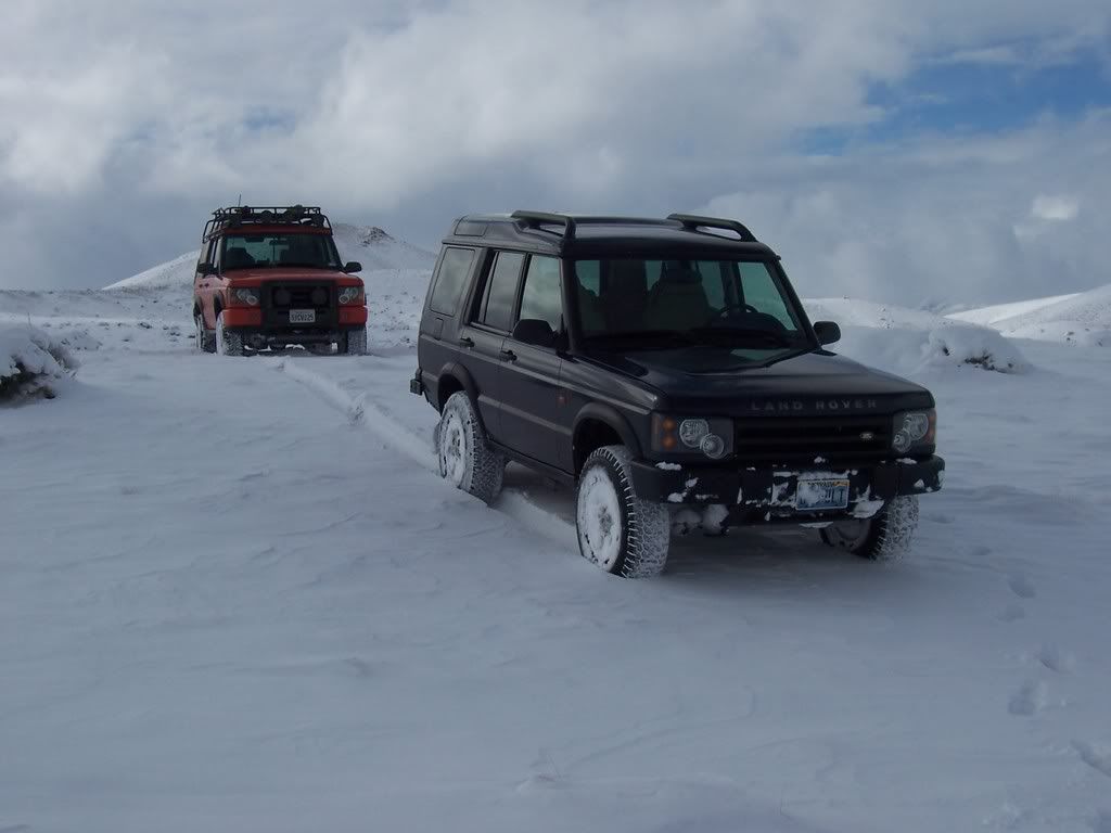

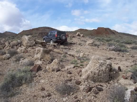

OK - My experiences so far:
I own a 2004 Discovery S model (no leather, no sls, no sunroofs, no leather, etc...). It's lifted about 3 inches, runs 265/75R-16 BFG TA, trimmed front bumper, rebuilt front prop shaft with serviceable u-joints, replaced rear bumper (wood), a couple of skid plates and homebuilt sliders)...At the moment it's at 65,000 miles (about 1/3 of that off-road) on the odometer (about 10% higher than that in reality due to the larger tires.
Veteran of 121 off-road treks mostly northern Nevada. Shortest trek about 75 miles, longest 670 miles. I have never had anything fail in the boonies!
I carry a fairly complete tool box and the following spares:
* Front prop shaft
* Rotoflex rear shaft coupling
* Serpentine belt
* Oil filter
* Air filter
* Old spark plugs
* Various fluids
Have never had to actually use any of the spares and don't expect to in the future.
A couple pics of my rig and the country that I drive in:
