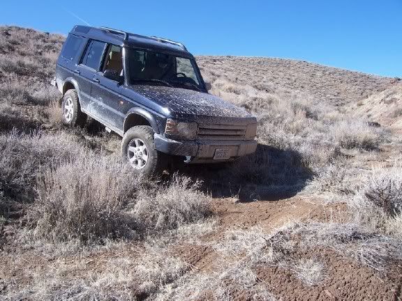

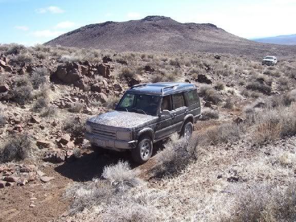

I do tread lightly - Those are all real trails; all on topo maps. Mind you some of the areas in northern Nevada haven't been re-mapped in 80 years so the trails may not have been used in a dozen years or so....
