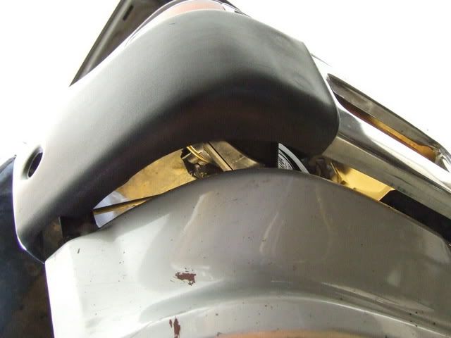

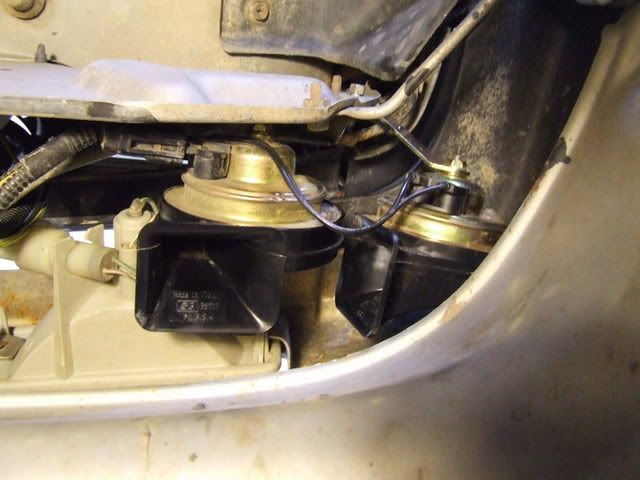

And since I'm feeling a little better about the wiring now, I decided to mount up the Fiamm 125db Horns.
At first I thought I wanted them up under the hood. Hardly any room there. All the fittings seem to be waterproof.....so I started looking under the front bumper.
I found the Perfect fit, right up under the passenger side front bumper. And there was even a magically placed Toyota Factory hole for me to bolt up too!
I'm going to make a shield out of aluminum roof flashing to help keep the rocks and crud from hitting the horns from the front tire. This can also screw into an existing hole.

I plugged in the Fiamm today!
It's just a direct two wire plug in to the old Toyota horn wires. Just put two female wire ends on the Fiamm horn wires and it plugs right in to the old Toyota horn Plug.
One hot.....one ground.
