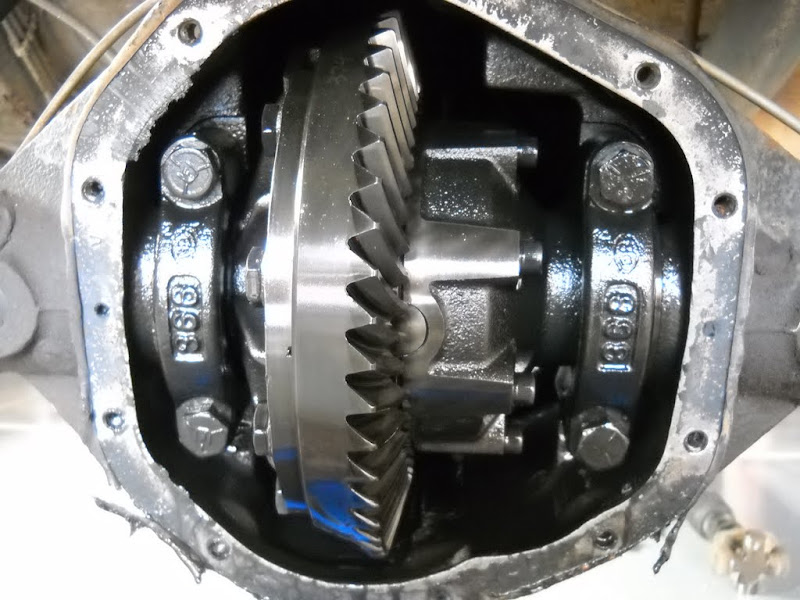

Finally got into the drivetrain last week, check out the latest installments of my build thread. Click the pic for link, the latest updates begin on post #40:
It won't be long now before I can drive him!
