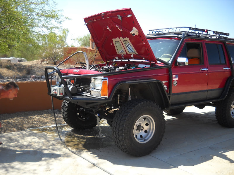

We had an over-heating issue a couple weeks ago while up in at Mingus Mountain. Click the 1st picture if you want to link back to the full write up on my build thread, go to post 168.
Here's something nobody wants to see:
That nor the fluid spew out of your hood vents while you're driving on a 2 lane highway...
Luckily, there's an easy trail repair and the part is cheap. This is something you might want to think about carrying if you drive a '92 XJ:

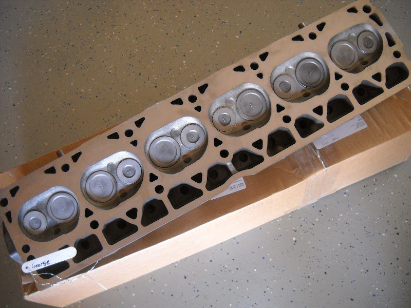

Running hot conditions continued this spring, with Clifford reaching the 252* mark on the way home from Red Creek in May. George decided it was time for the last ditch effort of pulling the head and having it checked, and did a bunch of other work while the engine is drained. I updated the build thread, and you can link back to it by clicking here: http://offroadpassport.com/forum/showthread.php?p=18286#post18286. The update begins at post 383.

Hey george, glad to see Clifford getting worked on. Its always been my insperation to build my Xj ExPo rig. I'm not on offroad passport, but I saw the comments on changing lifters & such! Figured I would help you out a bit there.
The lifters sit on the cam (flat tappet)& wear in a specific pattern. So if you took them out and didn't number where they came from, then you should buy new ones. As just putting the OGs back in will cause more/excessive wear & could cause a cam/lifter failure..reason is, is because the patterns will not match! New lifters & a used cam is 100% fine & done quite often. Starting new & wearing a specific pattern, vs having a pattern worn already & then wearing a new one...hope you understand?
When I built my 4.2L high compression mini stroker I used the stock cam & new Lunati lifters. Remember, "the lifter wears to the cam, not the cam to the lifter!"
So I would grab a set of sealed power lifters..stock replacements and drop them in! As stated on offroad passport they cost around 5 bucks or so off summitracing. I chose the Lunatis off recommendation...and then found this comparison.
http://www.jeepstrokers.com/forum/viewtopic.php?f=5&t=1262
Had I found this comparison before I bought the Ludnati's, I would have just gotten sealed power! Comp lifters have had a few failures/lifter collapses, and tend to be more noisy at low rpm/idle because they leak down..which can lead to excessive valve train wear.
Grab new lifters, soak them in oil -pre-install- & clean out the pushrods. You can also get a new mopar .043" head gasket compared to the stock .051". It'll bump up the compression a tiny bit & help out with power & efficiency & will be nothing other than buying it vs the 0.51" original. Its a worthy upgrade that won't cost you anything. Let me know if you can not find where to buy one.
