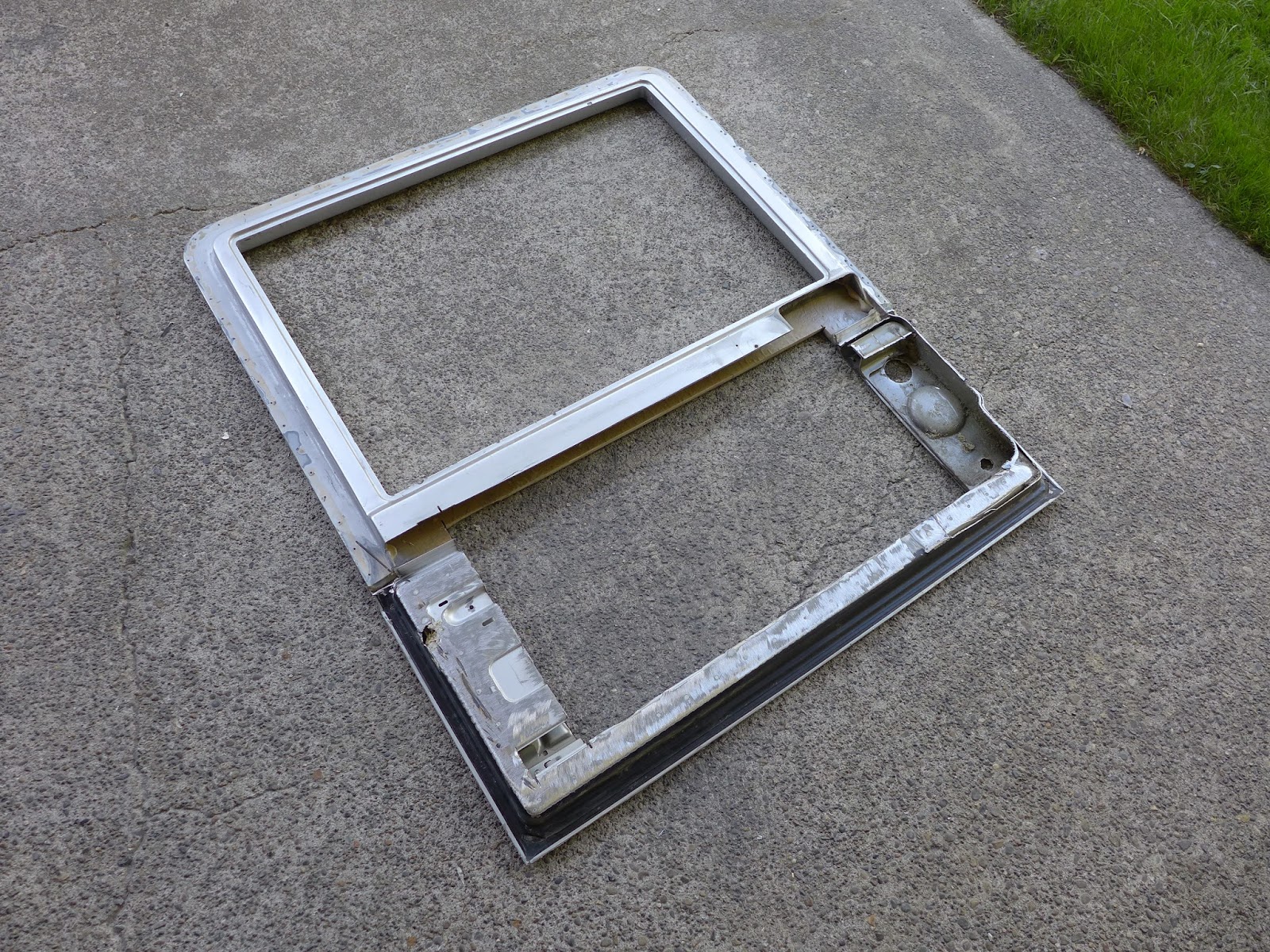

29 - Rear Door Cut-Out
(above) The Seitz rear window is pretty cool... Read more about them here> http://www.expeditionportal.com/forum/threads/56066-Seitz-Windows-101-Pros-Cons-and-their-Operation
The other rear cabin windows are tinted, which I like for their improved privacy, and reducing solar gain, so I took the Seitz window to the local window tint shop and had it filmed with the medium dark tint...

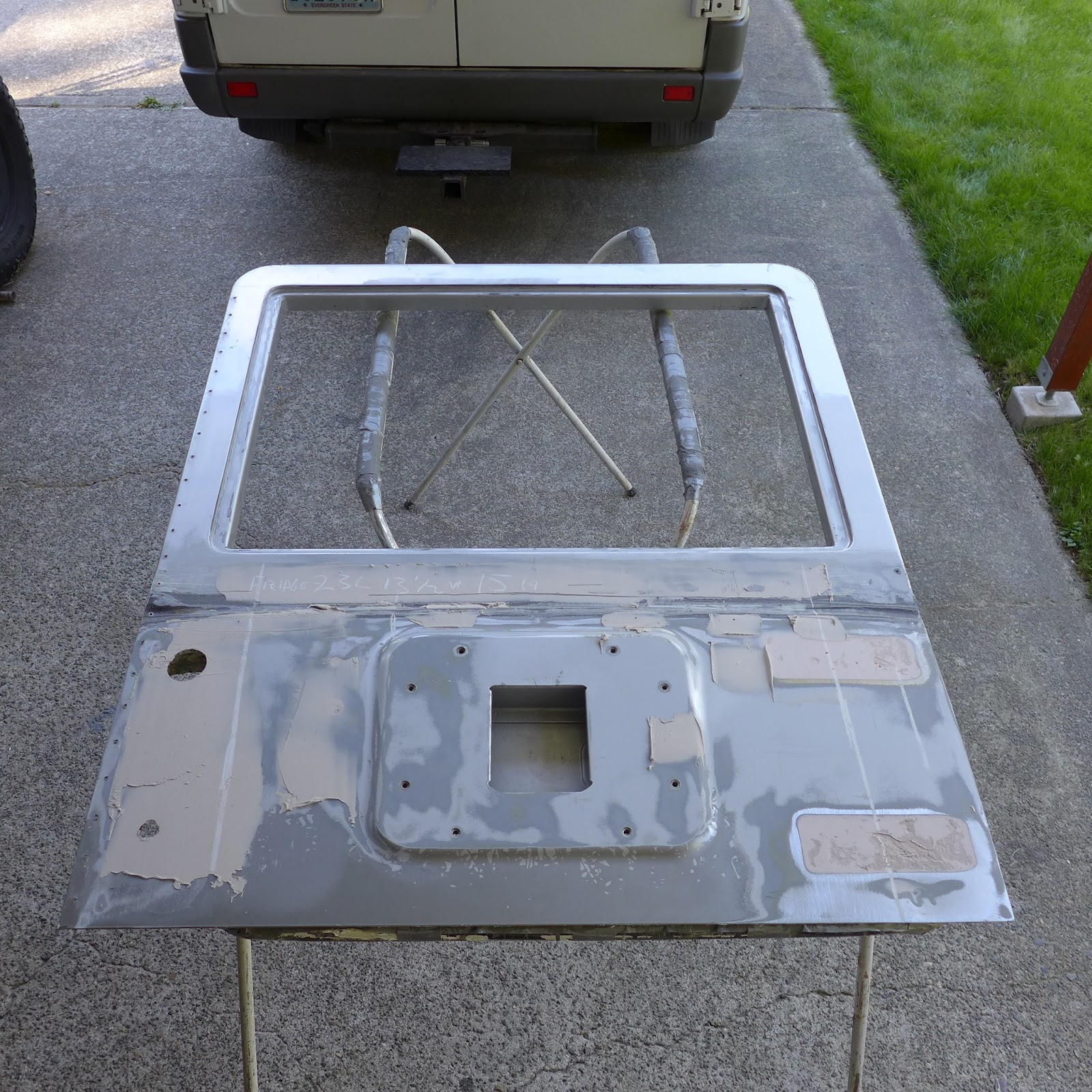

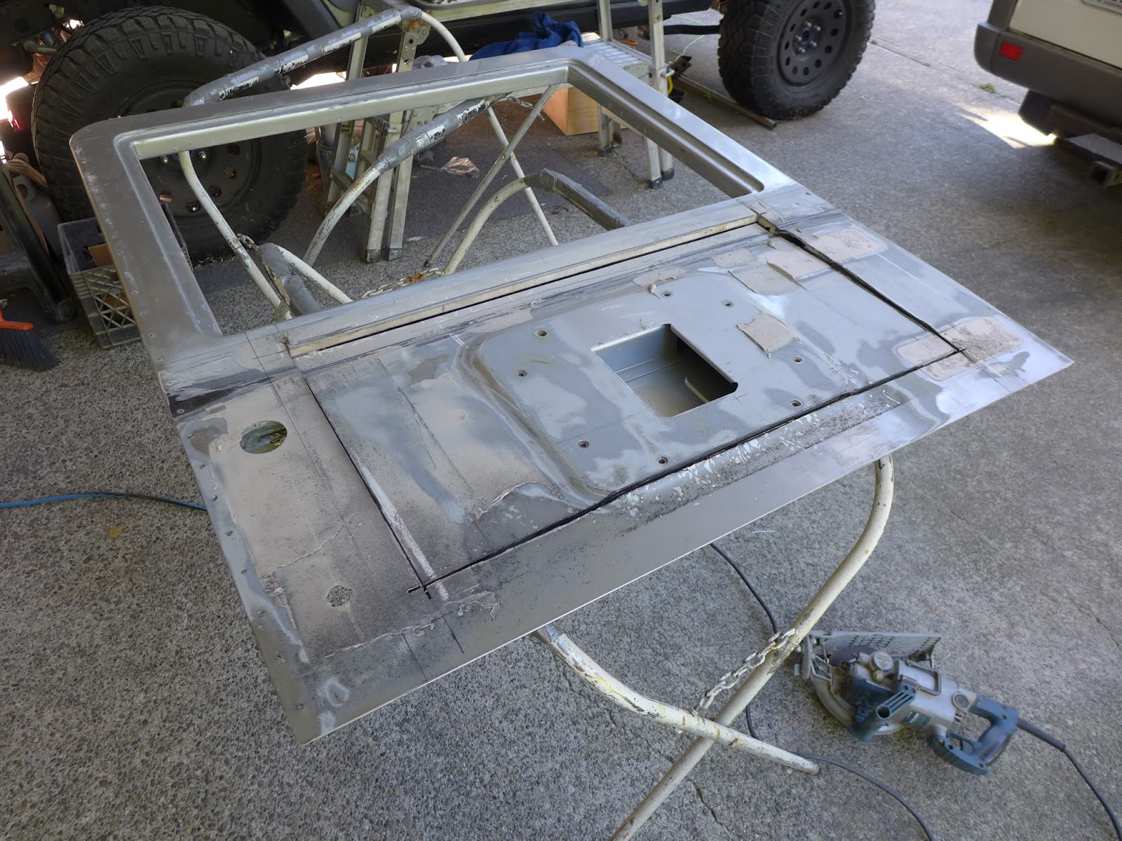

(above) The rear door was removed from the hinges so a cut-out for a permanent box could be made...
(above) A half hour with a metal cutting blade on a framing saw and the panel was almost all the way cut through...
(above) The final cut-out... The door is now at least 30# lighter...
(above) Flipped over it looks like this...

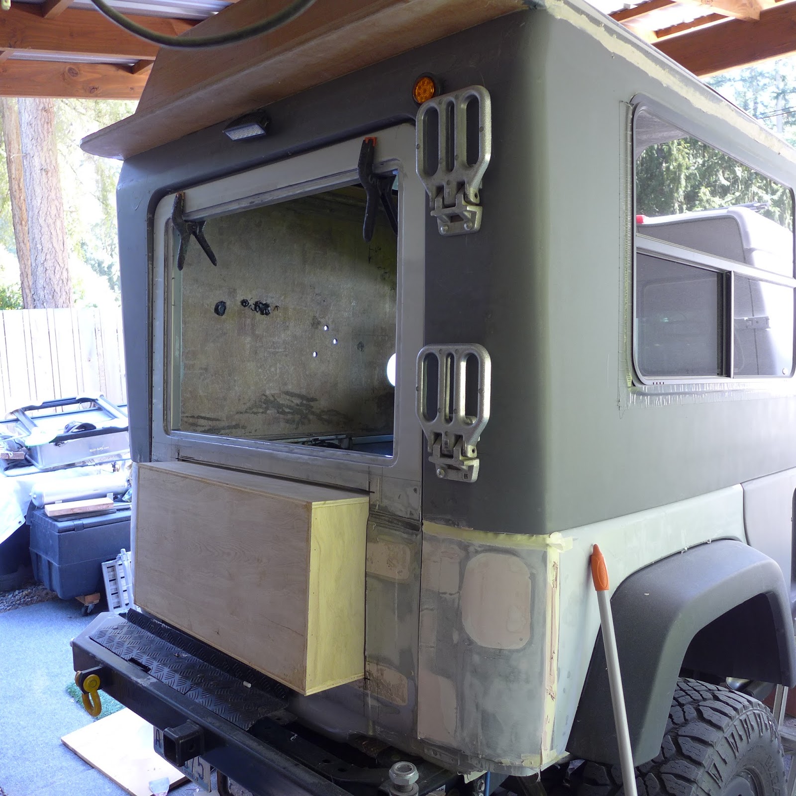

(above) A simple 1/2"plywood box was build for the cut-out... The rough size is 30" wide x 15" high x 7" deep... It will be fiberglassed by itself, then fiberglassed to the door...

(above) The plywood box for the door has been routered with a round over bit, sanded rough and given the preliminary fiberglass coat...
(above) As promised, the rear quarters get a final fiberglassing...

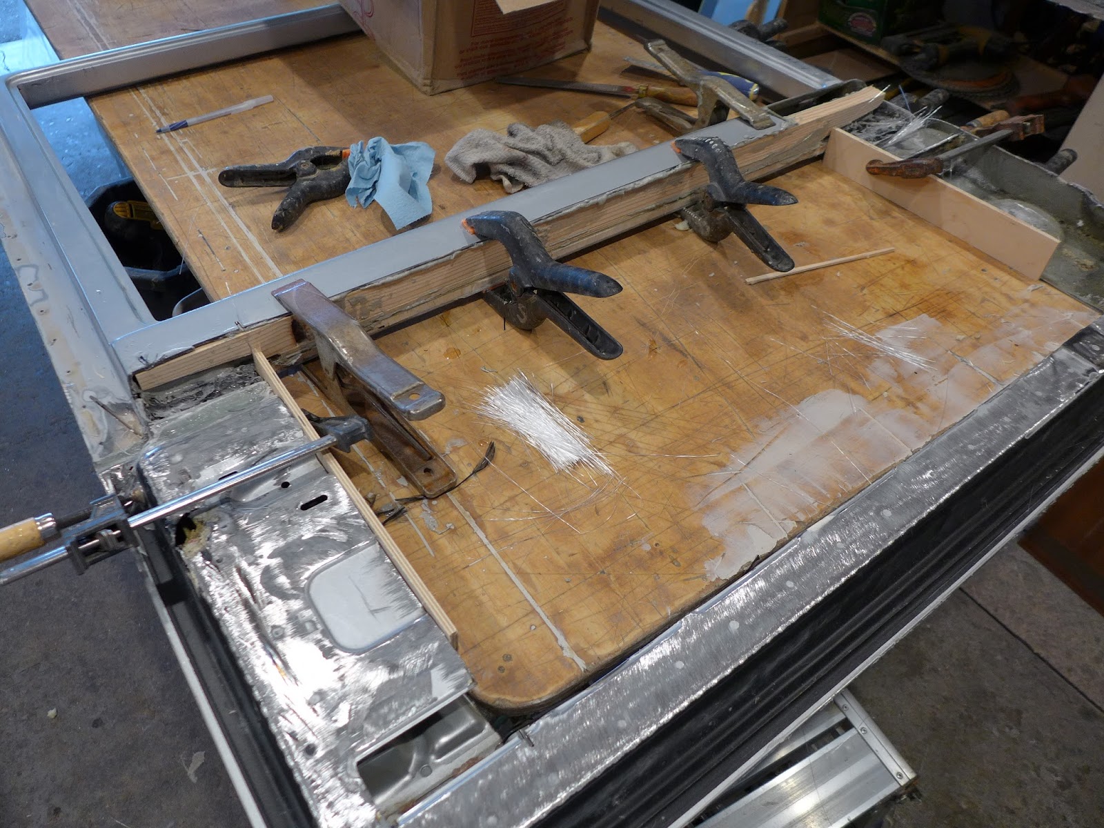

(above) The former door hinge points get stuffed with stranded carbon fiber and epoxy, several times, to build up some thickness and stiffness...
(above) Hinge side with five years of saved, frayed, C.F...
(above) Next day... Wood dams clamped on for more glassing...
(above) Later, every flex point solidified... All the rough sanded steel, epoxy coated to eliminate oxidization...

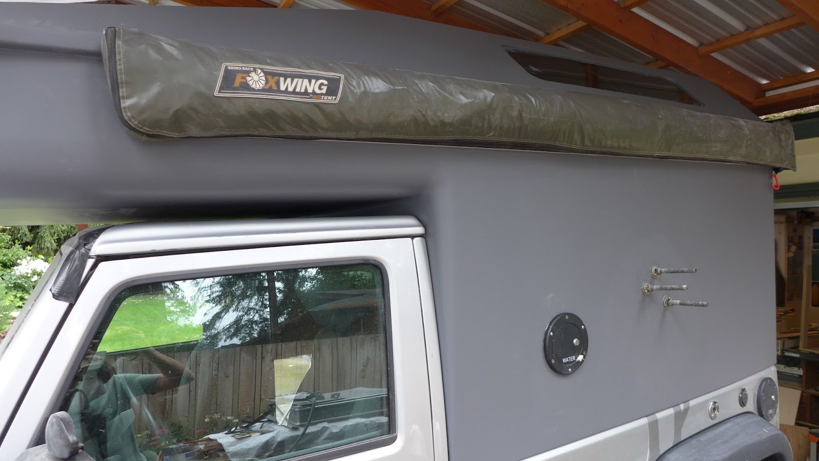

(above) The walls have three coats of paint... The awning is ready to mount... High quality flashing tape goes under the awning contact points... Can't hurt...
(above) Two big bolts hold it on...

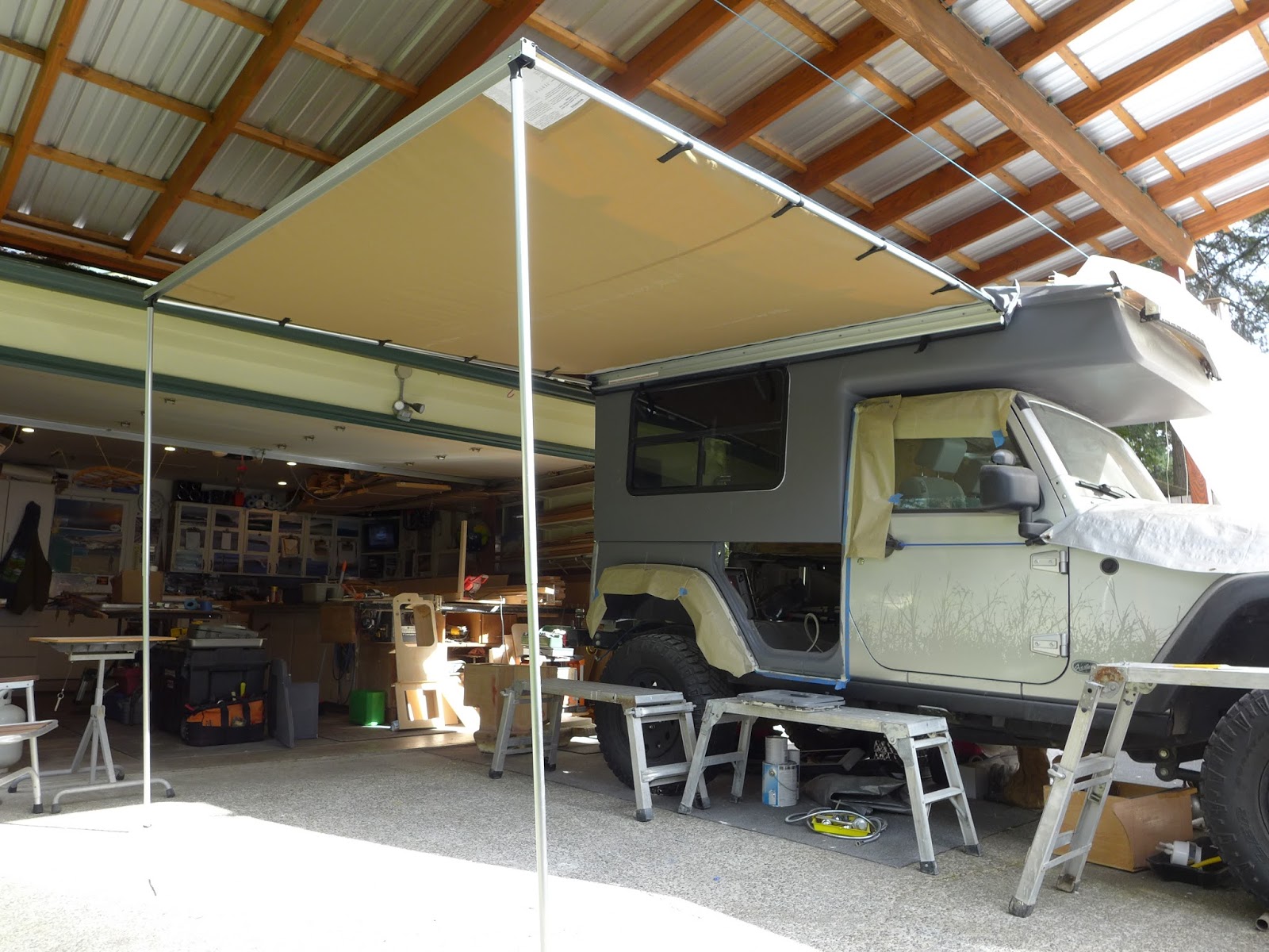

(above) Next, the straight pull awing is ready to be mounted...
( above) Six heavy duty SS screws are the connection...
Later both awnings will be caulked along the top edge...

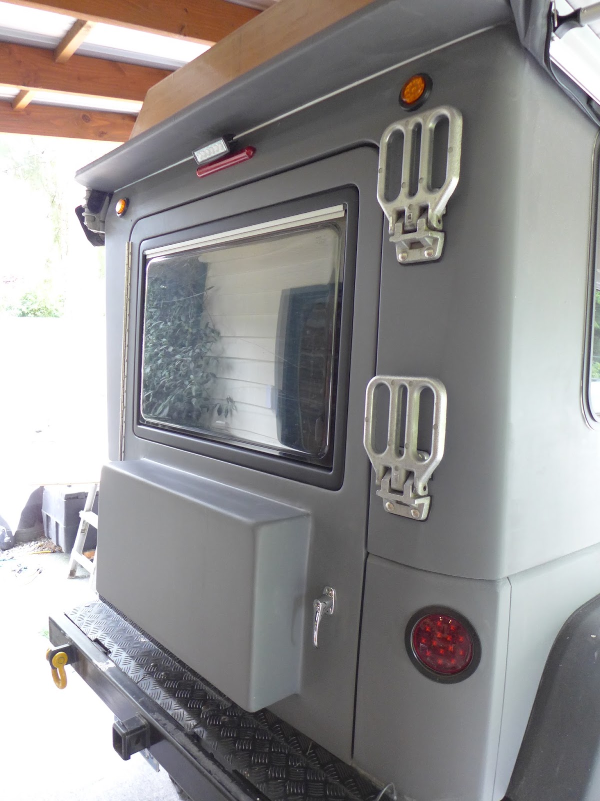

(above) Since the last post a lot of time went into getting the rear door to this point... A significant amount of focus was on getting the door straight and stiff... Now it is... Next,the rear box was fiberglassed to the door, in and out, after filling in the steel door with spray foam insulation, priming everything with epoxy, Bondoing where it was needed, and another layer of fiberglass and epoxy over everything... Finally the door was painted flat grey...
(above) Lights were added... New LED brake and turn, amber marker, and a third brake light were installed...
The window was fully dismantled, canded, cleaned and painted flat black... The shade and screen were also cleaned... As good as new...

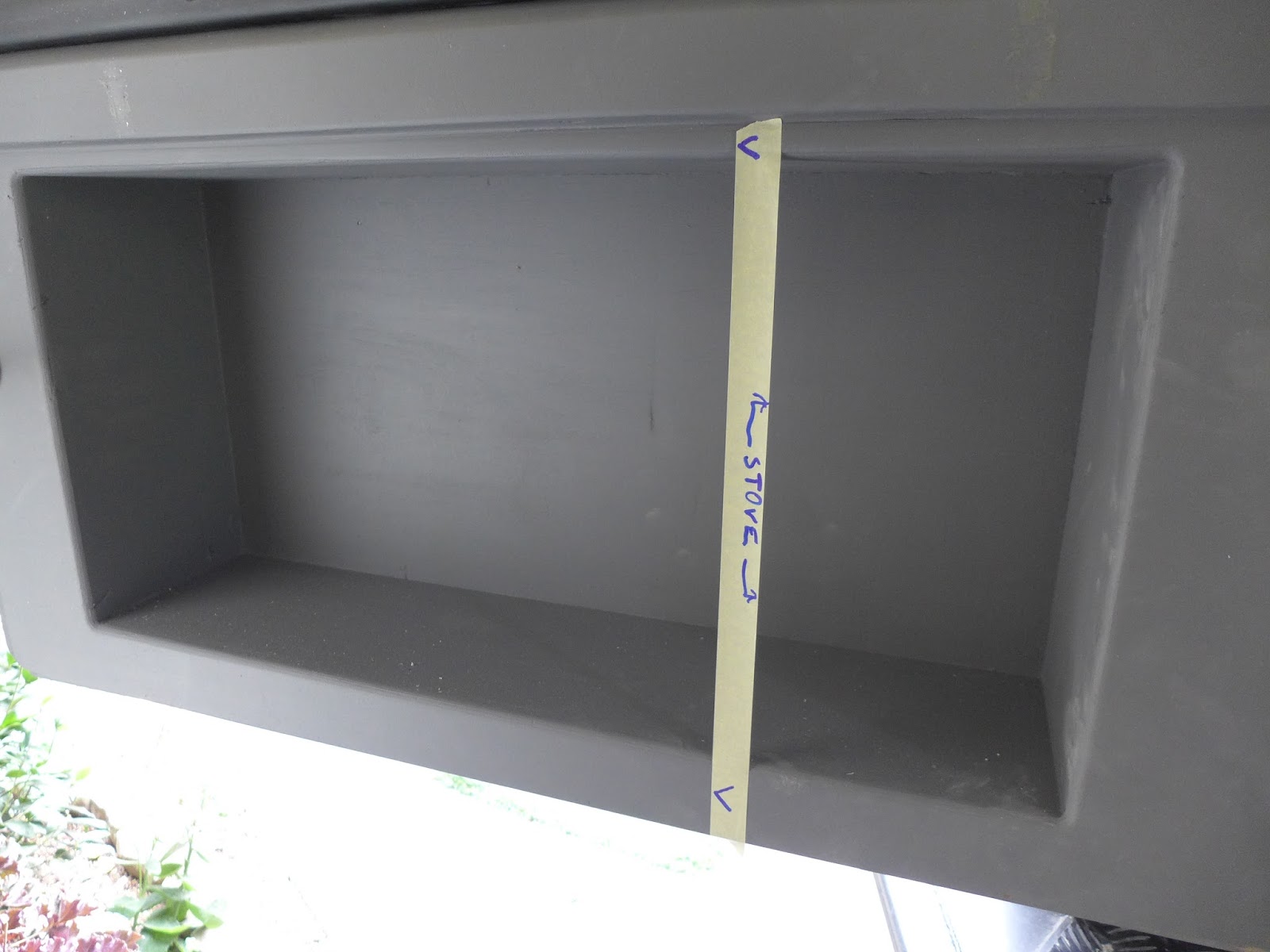

(above) The rear box will be the primary storage area for kitchen stuff...

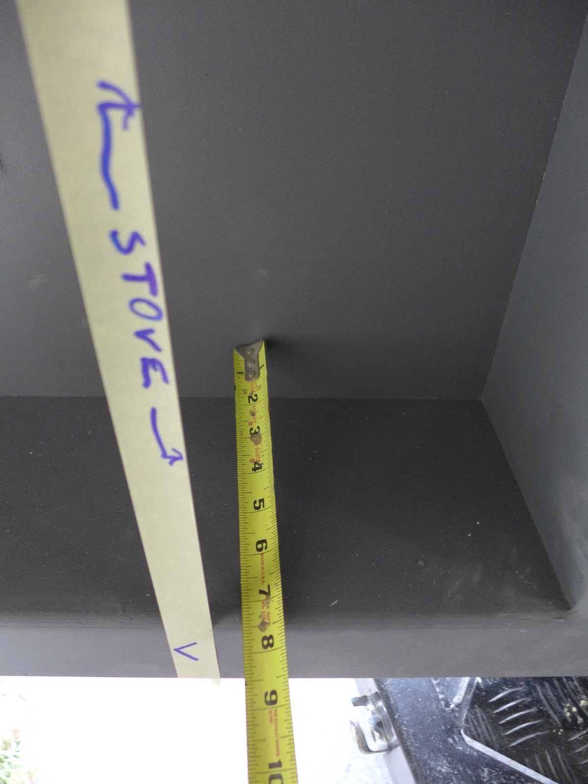

(above) There will be a drop down table here...
(above) The drop down will have two parts... One will be only opened with the door open... For a permanent' built in stove...The other side will be accessible from inside the cabin with the door closed, as well as with the door open for outside cooking...
(above) Not sure just yet how this will be finished off, but there are a lot of options...

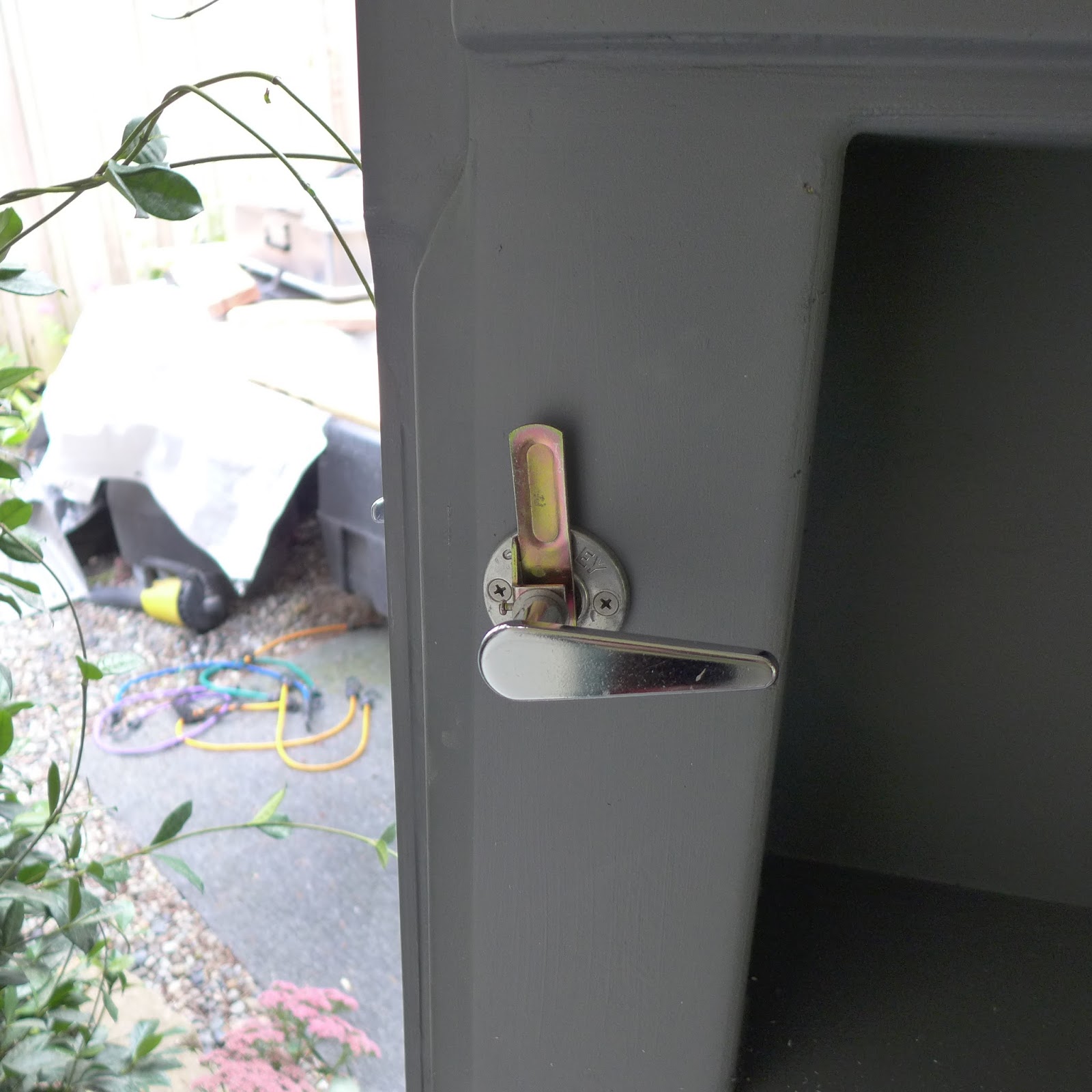

(above) Back to the door... The latch is similar to one used on lift up camper shell doors...
(above) The hinge was the one that supported the old roof... Heavy enough for that, just fine for here... The screws let me sleep well at night...

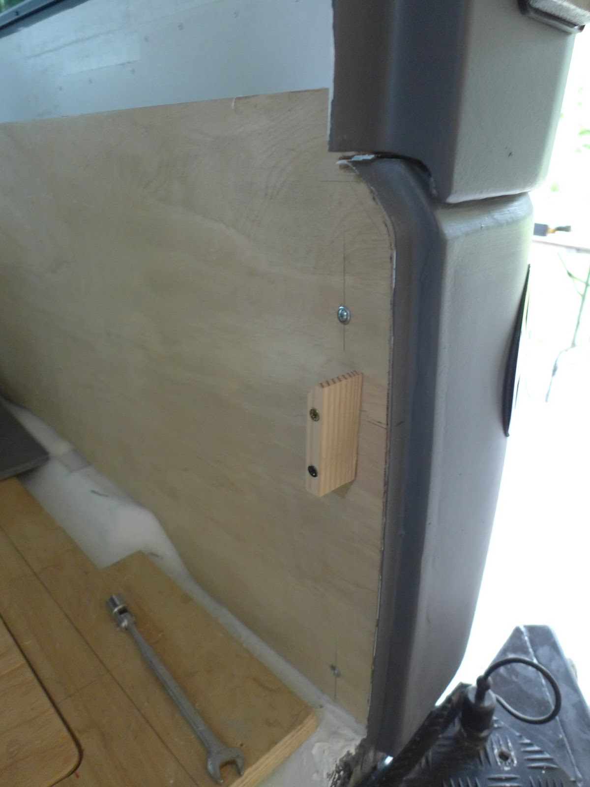

(above) Inside it finishes off like this... I was finally able to find a use for part of an old Stanley garage door handle, the escutcheon... Getting the matching handle to work was too time consuming to bother with... The inside latch will be supplemented with a pair of barrel bolt locks, high and low... For night security and extended trips away from home base...
(above) A temporary lock holder is on the wall... Later it will be steel. bolted through the wheel well...
