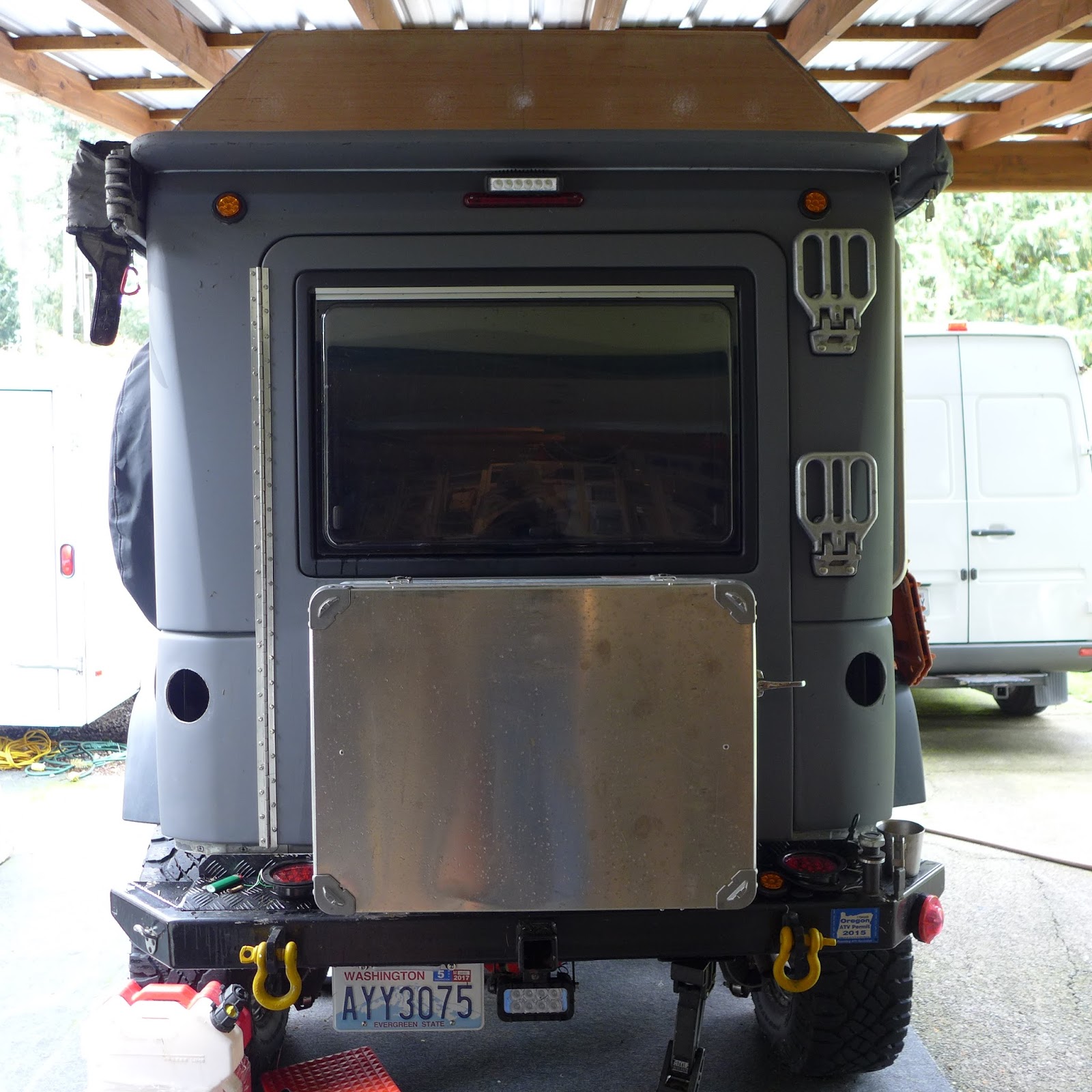

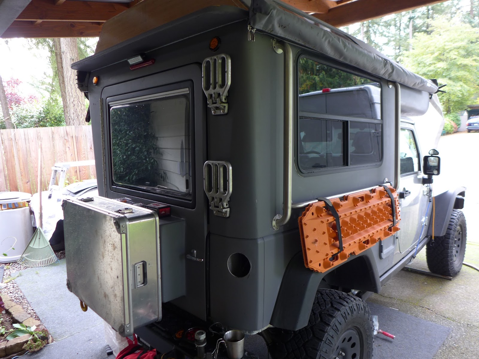

(above) Handicap grab bars were bolted on to the curb side cabin... Primarily to be a stand-on bar to access the roof rack and vertical bars are for hand holds to get up to the rack... As you can see the horizontal bar doubles as a traction-pad tie-down... The vertical bar nearest the propane locker will also have a detachable shower head mount...

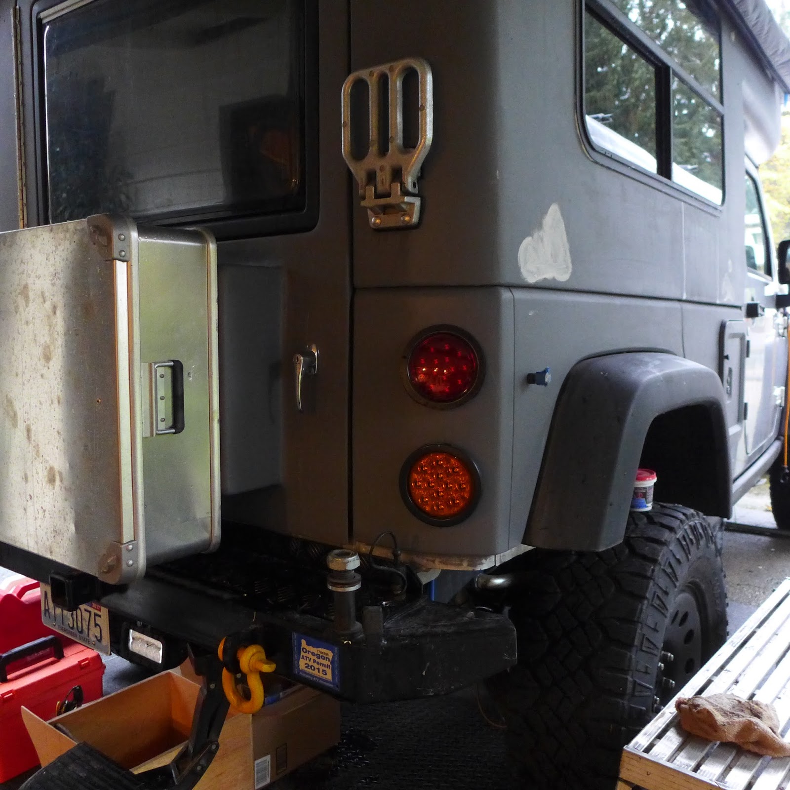

(above) Off the back an aluminum box was bolted to the door... It will likely be the dry food locker...
(above) The box lid will also function as a food prep area when opened up...

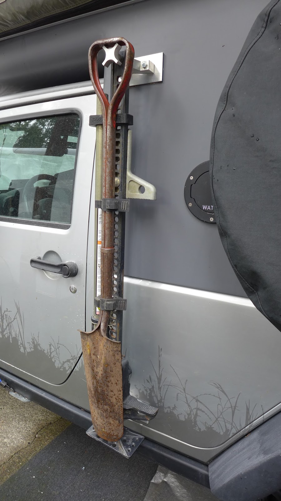

(above) On the driver side the hi-lift jack is mounted forward of the spare wheel... The jack base will fit inside the spare wheel rim...
(above) The jack has aluminum backing plates to disperse the pressure points on the shell... An all-steel post hole shovel (acquired from a toothless, Asian man who barely spoke English, on Route 66 in the California desert, for $5.00) , is mounted to the jack...
Haf-E
I like the side mounted spare. Nice to not have to open a swing out just to access the rear space.

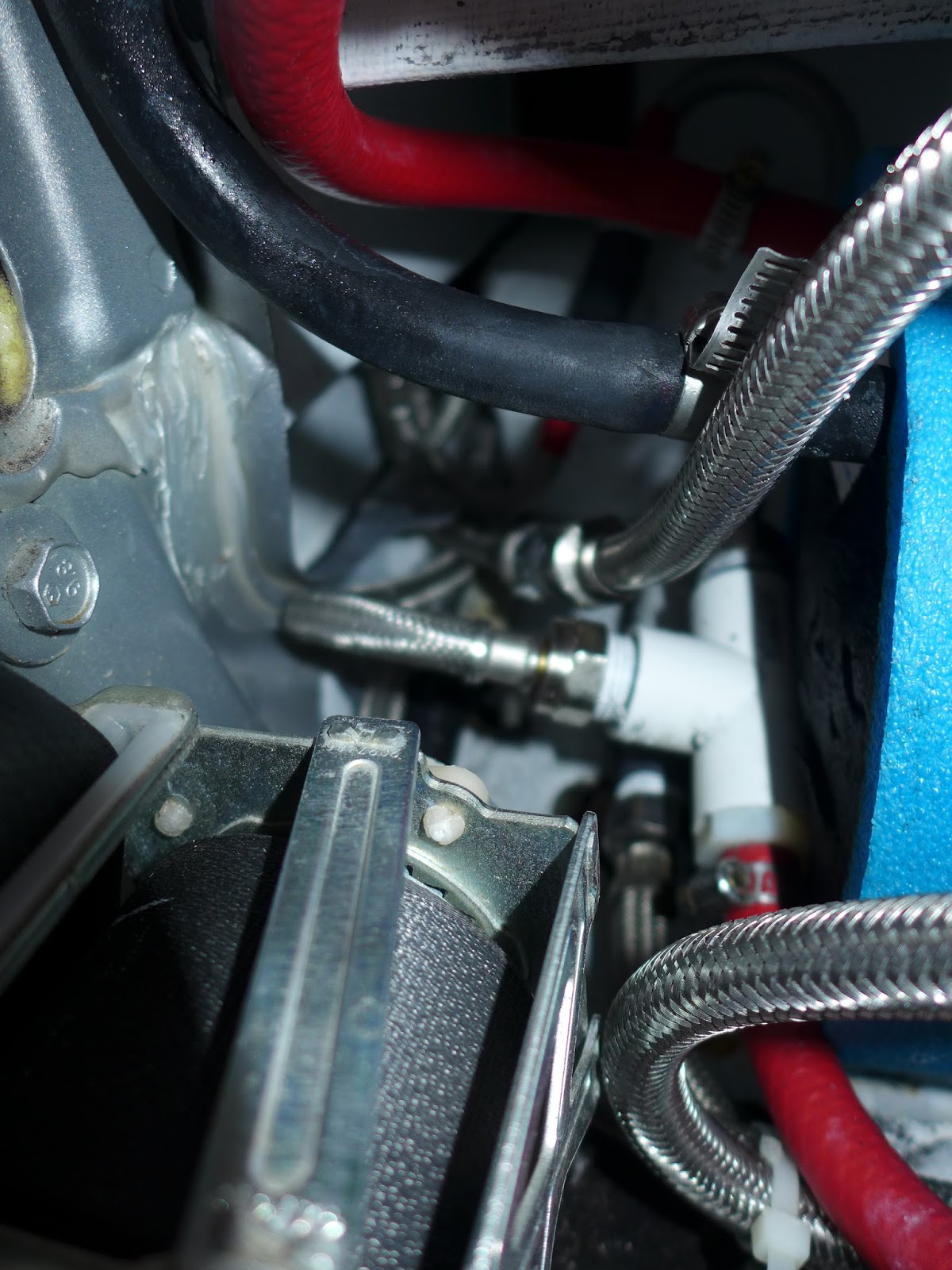

33 - Water System Finalization

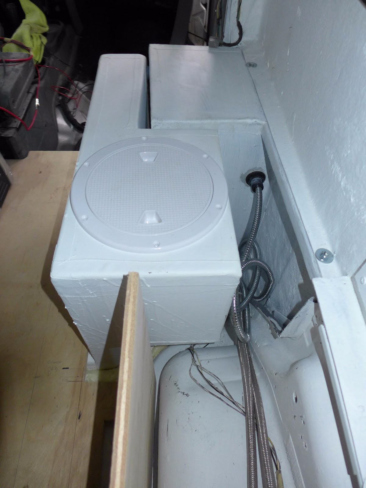

(above) Most of it fits under the passenger seat...
(above) A lot in a tight space, as usual...
(above) Propane locker on the left, water tank on the right...
(above) Shower hose coming out of the side...
(above) Propane locker with hot/cold shower...
(above) Locker door...
(above) Nothing to look at, keep moving...

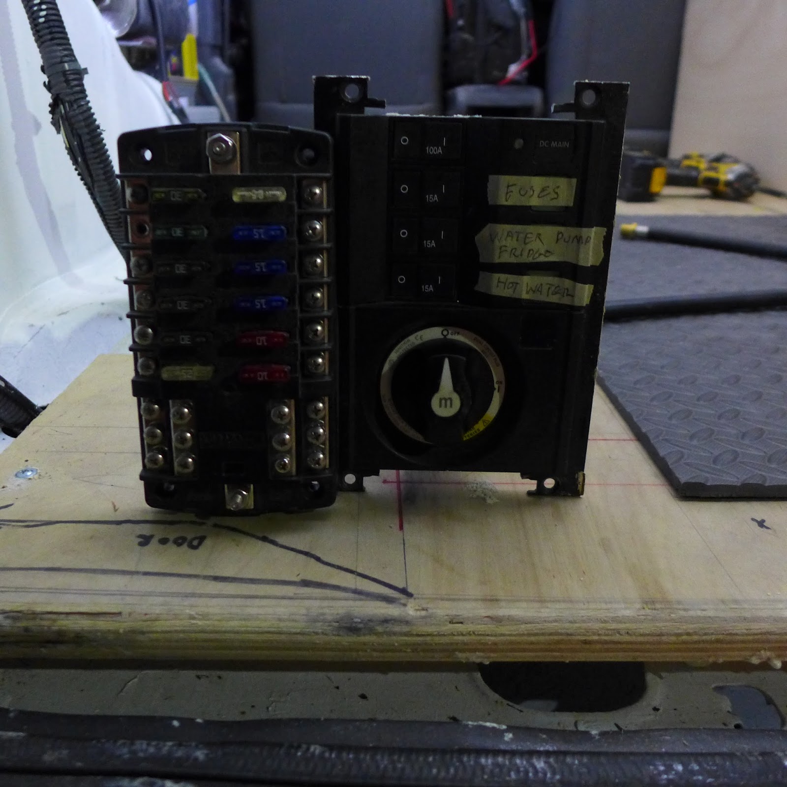

34 - Electrical Component Placement

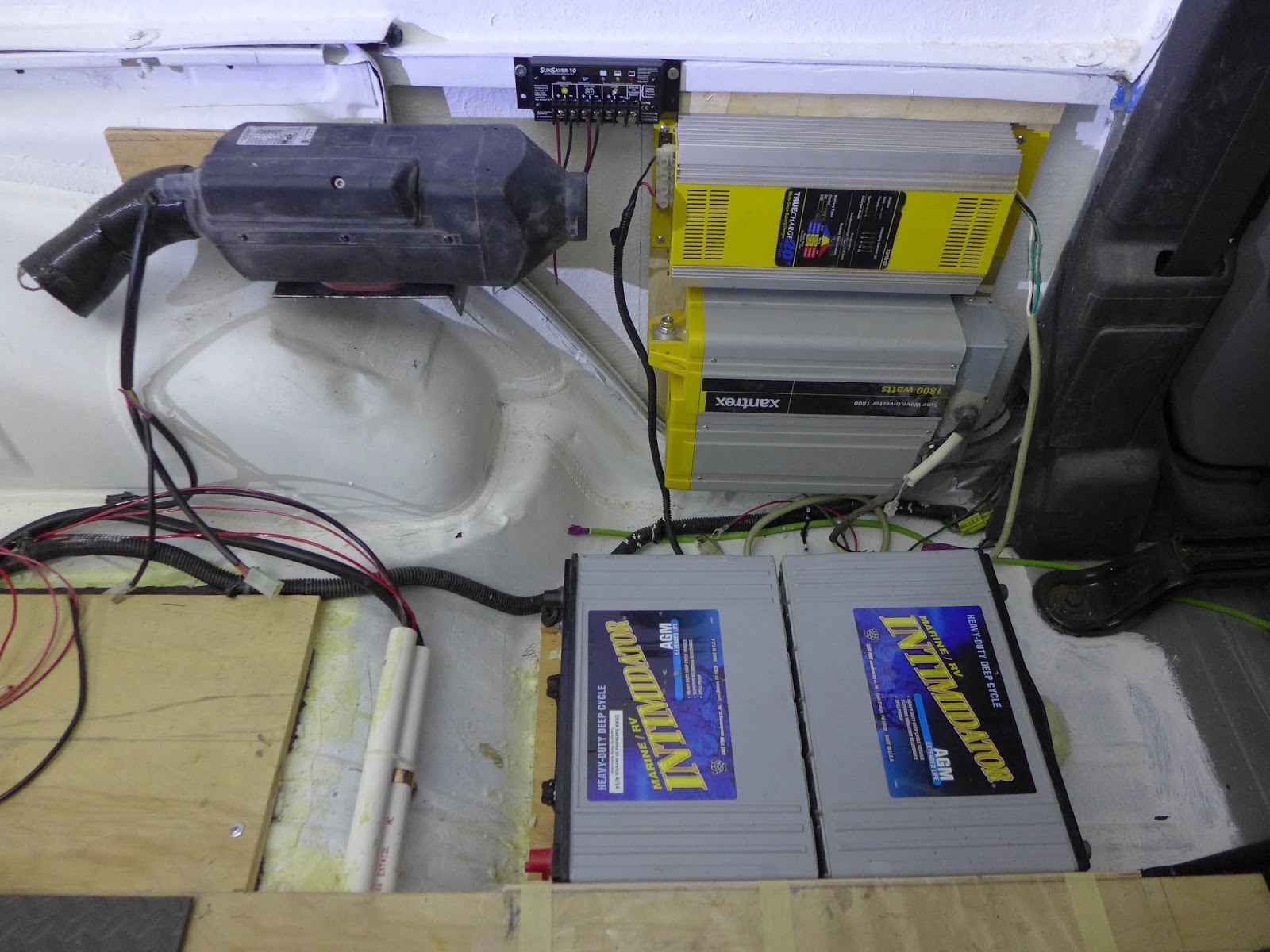

(above) Major progress on some important issues: Placement of Batteries, Battery charger, Inverter, Air heater, and Solar controller...
(above) This shows how things will fit within the area under the bench seat/bed... The larger black hose on the right side of the floor will be a secondary propane lead for the rear door kitchen...
(above) The fuses / breakers will be within a custom wood panel just inside of the rear door on the hinge side...
More to do, but getting these things located was a big deal to me...
