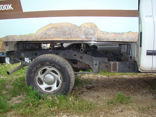

Let me lay out some general plans for the camper. It should be a very comfortable, but very capable expedition camper for short trips as well as long traveling. The engine as I mentioned is a V8, 4.7, automatic transmission, with shift on the fly 4X4. The rear axle will be replaced for full floating axle with disk brakes and e locker, custom rear leaf spring with an airbag support and probably OLD MAN EMU shocks. I want to give it max lift on the suspension of about 2.5 to 3 inches. The tires will be 255-85-16.
I plan to have a winch in the front and rear. There will be on board air, dual battery under the hood and two or three deep cycle batteries in the camper. Snorkel, propane heater and stove, CB and Ham radio because I finally passed my test and got the license.
I mentioned the subframe I built under the camper earlier and I called the space between the frame and camper "basement" and I'm going to try to install all equipment and heavy accessories in the basement to try to keep COG down.
If anybody has some suggestions they are always welcome. Nothing radical on the paint, probably some clean white with a silverish lower portion and maybe back of the camper.
Front bumper: It looks like ARB Sahara but after serious lyposuction and replacement of cheesy chrome tube with 1 3/4 inch DOM tubes.
Here are a few more pictures.
Here is the picture of the basement:
DSC05841.
