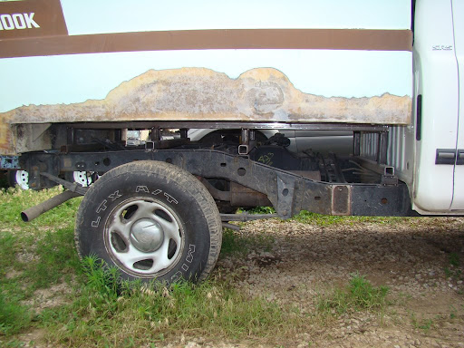

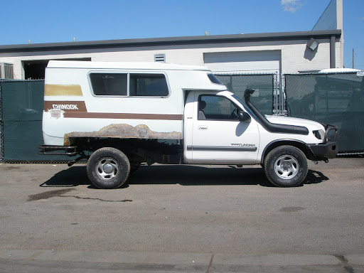

Now I'm coming back to the subframe. The subframe is built for several purposes. It is going to hold up the camper, stiffen the frame and prevent it from excessive twisting because the camper and the cab are going to be walk through. Like I said, I will also locate all of the accessories in the "basement". Here are some more pictures of it.

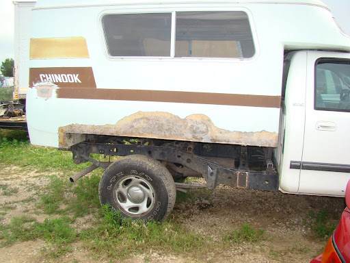

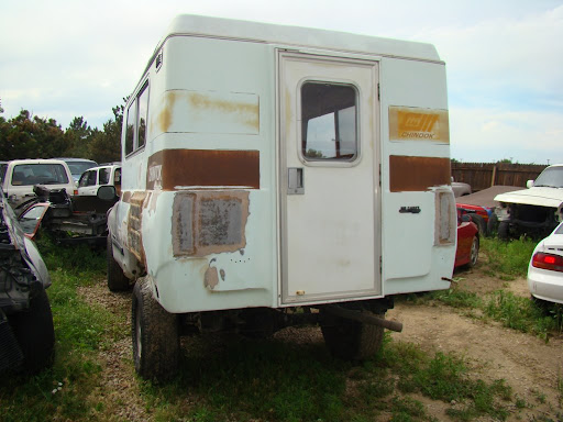

Here is the rear body shot with all of the holes re-fiberglassed.

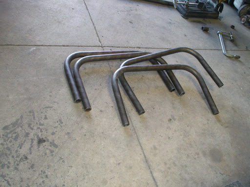

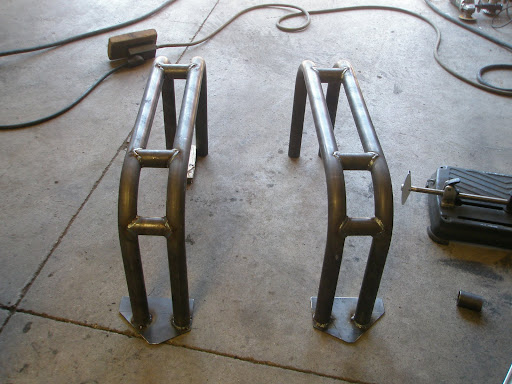

I started work on the rear bumper. The bumper is going to be incorporated into the frame and not removable. The hitch is built-in and for the corners I used the same 1-3/4 DOM tubes. First I built the center piece and welded it to the frame. I bent the four corner pieces:

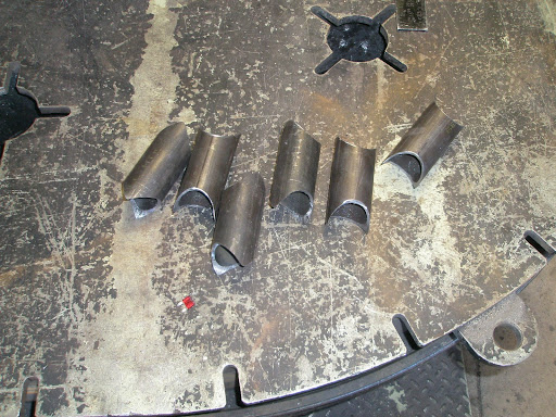

I cut six short pieces and fish-mouthed them.

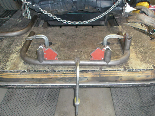

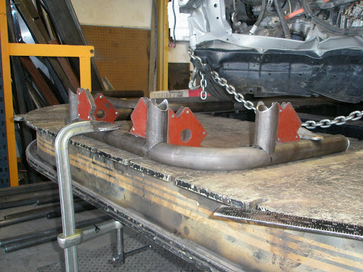

I used my frame machine as my welding table, clamped the corners to it and finished welding the corners.

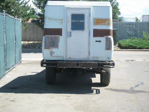

Here are the corners, fit and welded to the vehicle:

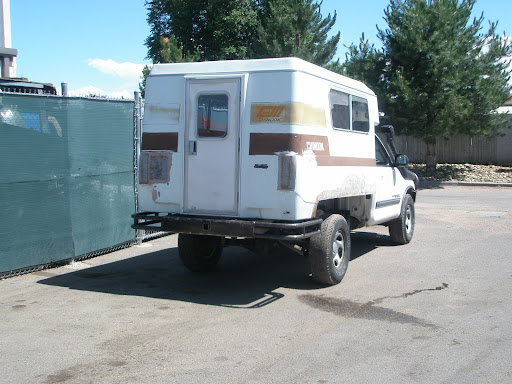

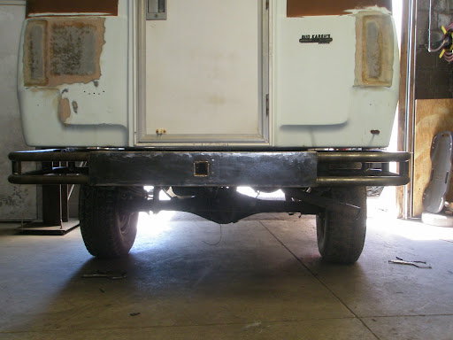

Here is how the vehicle looks with the complete bumper:
I know it's not much but that rear bumper took me all day.

I'm curious as to what you are using to cut your fish-mouths? I've been hand cutting and filing mine, but I'm facing a larger project and I am contemplating buying an ol' joint jigger.
