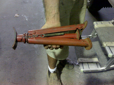

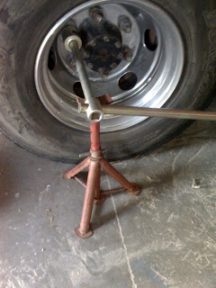

If I'm without an impact driver, I use the factory socket with a slightly longer bar and support the end of the socket. I carry a folding axle stand for this so you can put more weight on the bar safely. Then the axle stand goes under the truck during the wheel change for extra safety.
This is the axle stand that works for me. If you get one and the spacing holes are too far apart to get the correct adjustment use a couple of pieces of thin plywood as a pad to get the right height for the stand.
This one folds up.
If there is a proper tool for this as was mentioned that sounds great but this works really well and the correct rotational force can be applied to the nut without trying to twist off and damage something.
