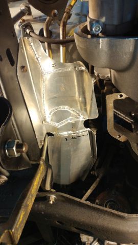

We left off at the exhaust. I will mention again how difficult it was to get all the cats to fit under the body, between the frame rails and around the transfer case. One area of concern was the plumbing that runs down the passenger side frame rail. The cats took up so much room over there that I was not comfortable leaving the fuel and brake lines alone. Turns out, I didn't get any pics of the plumbing, but I will make a note to take some.

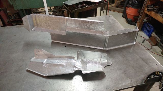

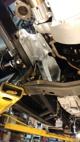

Heat shields come on just about every car or truck built in the last 50 years, and catalytic converters produce so much heat (about 1000 degrees F) that I knew we needed some on this truck. The driver side already has some that cover the exhaust, but the front heat shield on the driver side (up to the firewall) needed improvements.
These pics show the passenger side heat shield and how tight it is in that area. You can also see the fuel feed line, which I protected with fire sleeve.
Even with the new heat shields, I wanted more insulation. Using a heat barrier from Thermo-Tec, which is a peel and stick, on the underside of the heat shields, the temps above the cats should drop substantially.

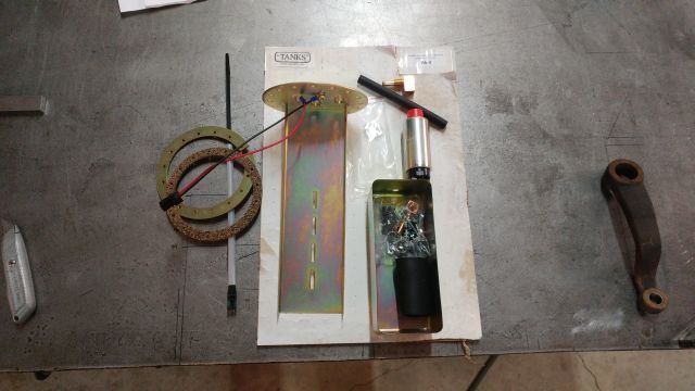

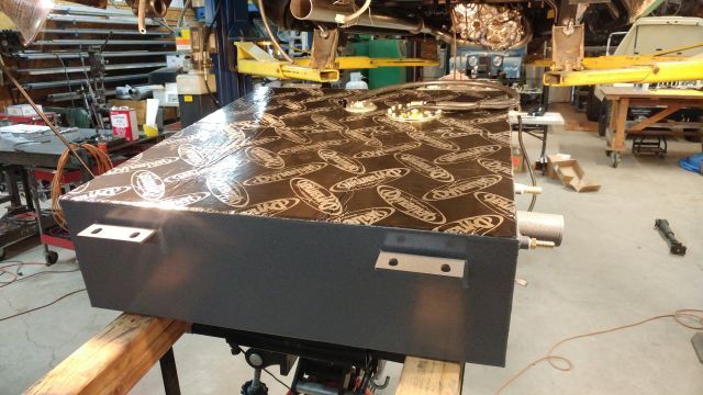

Using a 38 gallon fuel tank from Man-A-Fre makes sense with one of these trucks, no matter what engine you have. The stock 20 gallon tank is fairly small by today's standards. The new tank also offers a nice flat surface and built in sump to make mounting the new fuel pump module a snap.
Measurements taken and hole cut.
Add sound deadening insulation to the top of the tank.
Assemble and install the pump module.
Install the tank using a trans jack (these tanks are not light).

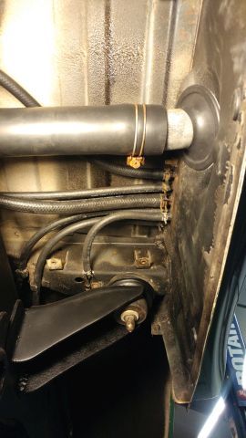

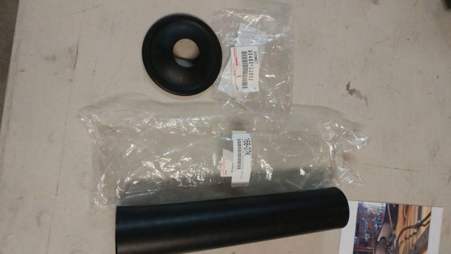

There are a couple items that see a lot of wear with age. The fuel filler tube hose and the filler neck grommet get hard and crack over time, so it makes sense to replace them at this point. Both are available new from Toyota.
