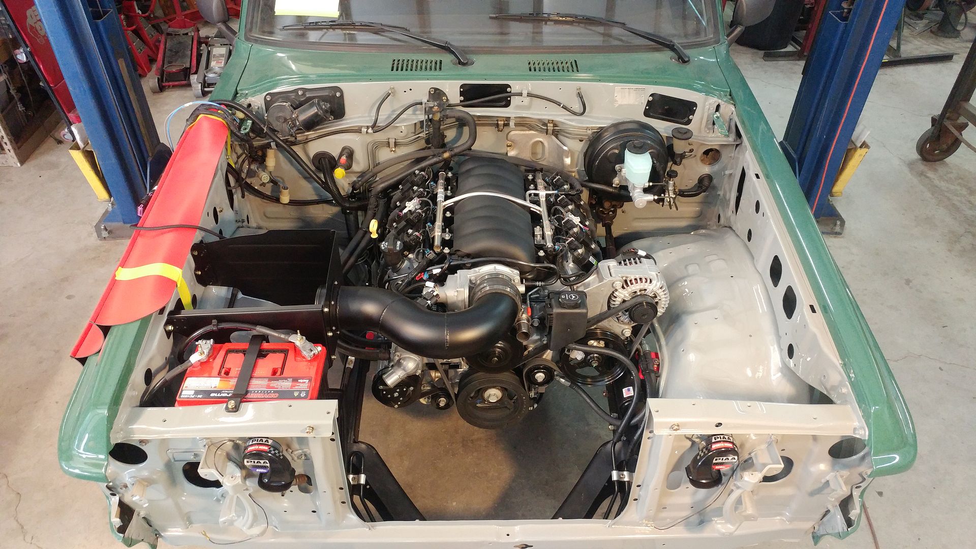

Getting to use quality new components that have been carefully thought out and put into a kit was a very exciting feature of the E-ROD. This not being my first rodeo with V8's in FJ60's, I figured it would be a slam dunk. Man, that couldn't be further from the truth. So many little things make every day an adventure on this job. Yes, there are a lot of details that remain the same from the past installs, but nothing is so similar that I can just make templates for every bracket, tube, mount or hole. I figure there should be four templates for these builds (which I will strive to develop as I build more of these): one for truck engine with manual trans, one for truck with auto, one for car style with manual trans and another for car engine with auto. They all have their unique characteristics.
With that in mind, and most of the fabrication work done, the details are starting to fall into place.

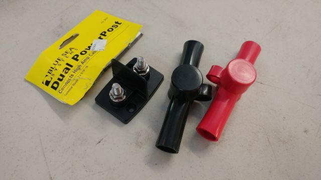

Underneath the fuse panel is where I like to make my battery connections. Since I do not like to have more than a couple cables going to each post on the battery itself, I use a power post as a junction block for extra connections, like the winch.
I may or may not buss these two post together. When I get to that point, I'll decide.

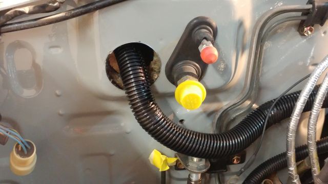

Fitting the ECM connectors through the firewall is a major challenge. There's really only one spot it can be done. On FJ62's, this hole is already there, but on FJ60's, it has to be punched out. I use my grandfather's electrical box knockout tools for this job, since they make a nice, round hole with only minor cleanup needed.
The hole is huge, and almost doesn't fit, but it has to be large or the ECM connectors will not fit through.
In the past, I have used OEM Toyota firewall grommets for the sealing of the hole, but the source of good ones is drying up and they tend to be on the small side. I still don't know what I am going to do to seal this hole, but I have a few aftermarket grommets on order and I'll try each one for fit. I wish someone sold OEM style firewall boots for large diameter holes. The majority of the grommets out there look like they belong in a billet '32 Ford roadster. That's not the look I'm going for...

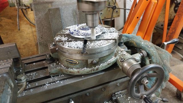

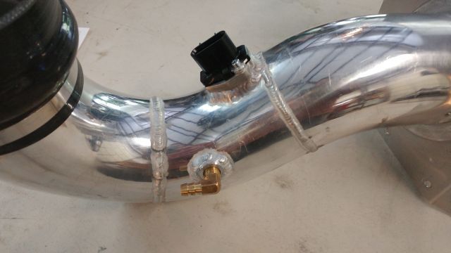

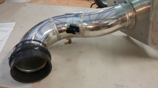

Machining the mounting ring for the air intake tube to air box connection.
The AFM boss and "foul air tube" (PCV) boss in the intake tube.

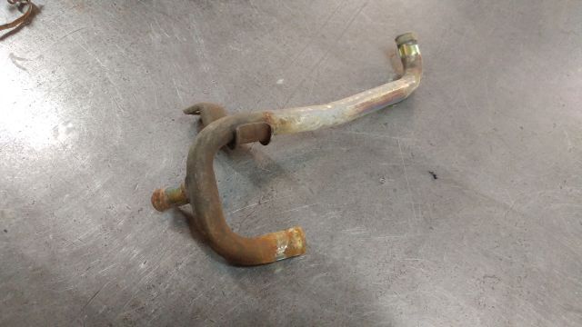

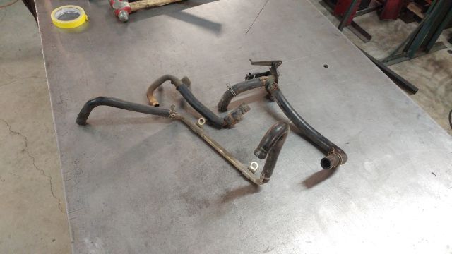

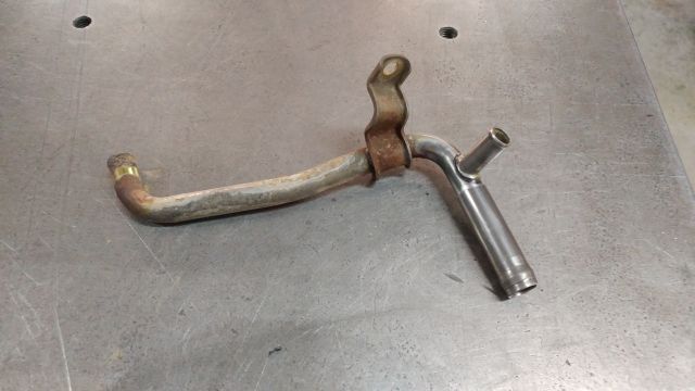

Starting on the heater hoses. Using the original steel hose connectors gives it that OEM look, but yes, they do need to be modified to fit.

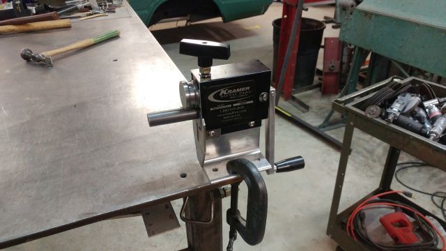

More bead rolling.

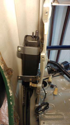

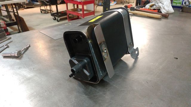

And lastly, for today, the EVAP canister.
Finding just the right place to mount this behemoth proved a challenge. I ended up finding the perfect spot.
First I had to make mounting brackets.
Here is where it ended up. Hidden but accessible.

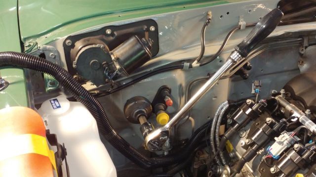

And to make sure everything fits, it's a good idea to fit everything together. Here's a new washer bottle that we used.
Hookingit

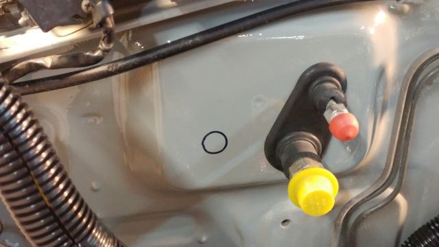

More progress has been made and I should be ready for disassembly and powder coating in the next couple of days. It is getting cramped in the engine bay, but I found a nice hiding spot for the A/C drier. Pics soon.
