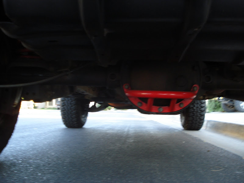

How much ground clearance do you get under the front skid and rear diff with the 245 75 16's and OME lift combination? I might as well be driving a Subaru mine is so low.

Not to sure on the front. FlyingWen has it at work today. Here's a pic of the rear diff:

On mine with 265-70-16 BFGs bottom of rear pumpkin is about 9.75 if I remember right, lowest point of the stock front skid is about 11.50 to 11.75, haven't measured for a while but it was right in that area
OME Heavy Duty Springs with 3 ring clevis and 1/4 inch top plate
