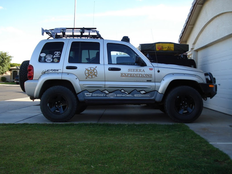

Thats a great looking Kj.:sombrero: Is that a RTT on the rack?
Nope just loaded for their vacation, we bumped into them near a dry salt flat on the way to Uluru (ayers rock).

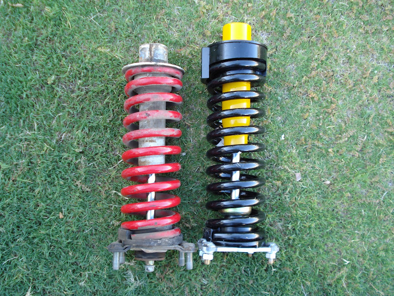

So I got everything off which was rather easy. Here you can see the old lift compared to the new lift for the front:

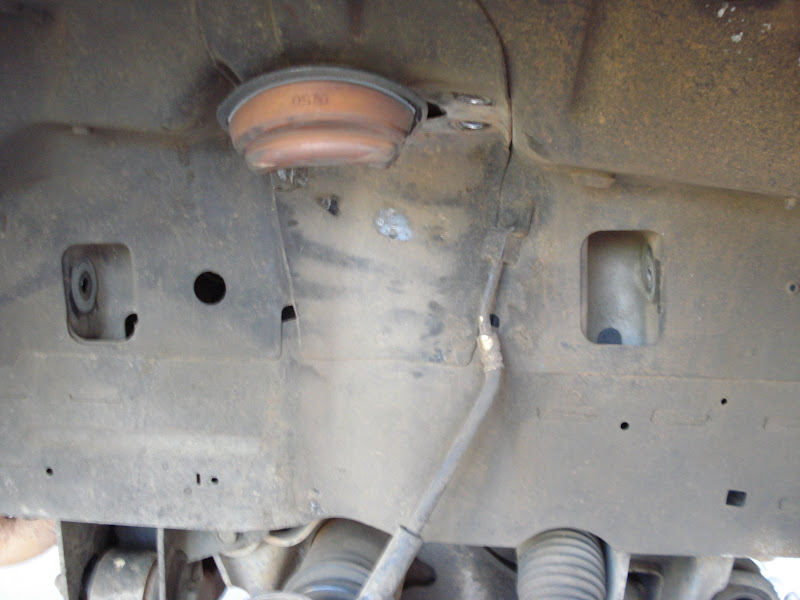

To allow for maximum travel on the front with the JBA 4.5 A arms, we needed to cut the pockets a bit more. Here is before and after:
Before:
After:
Testing with out the springs in allowed the A arms to go clear to the top and clear to the bottom (where it would interfere with the springs). So I hit it all with a coat a paint, and pounded a bit more of the pinch weld, and areas the 245/75R16 rubbed since we are now running 265/75R16's. Then hit it all with under coating after the paint had dried to touch. Will have to report if future rubbing issues occur.

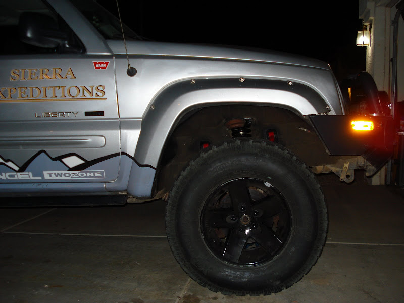

Got everything on and back together, and at this point it was getting late to be using air tools in the driveway, so only the front passenger side is done, but I am excited to get the other side complete and get the rear done.
Here is the best pic I could get at 10:00pm and as she sits now. I like!
