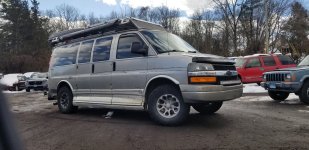

Well...It's done! Before and after shots of the Boulder Off-road Pro-Runner Plus Kit (Bilstein 5100's all around, plus 1300lbs stronger leaf springs). The van had clearly not had any suspension work done in 20yrs, and my poor mechanic had to battle the thing for 2.5days to get everything installed (torches, sledgehammers, and air chisels), and to handle a set of other work (ball joints, shackle links, oil change, etc, etc). This was definitely a buy once, cry once investment. Thankfully, I can say, that the work and the outcome was totally worth it. It's literally feels like a brand new van. The steering is tight, it rides silent and smooth - no clanks/bangs/jangles when I hit bumps, no rear end squat, body roll is gone in turns and when passed by semi's, and oddly enough, I'm getting 1 mpg better gas mileage (This one makes no sense, but I'll take it).
I wish I had the skill to do this kind of work myself, maybe on a newer less crusty van, but having it done by a professional was critical to this coming together. I wish I would have done it sooner.
Now onto ripping off fiberglass body foolishness and body work. I would have gotten more work done by now, but I use it too much for skiing and mtn biking. Best problem to have!
