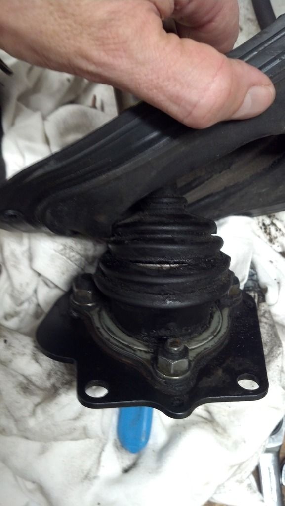

Ok, got my old lever out (red ball was long gone-nothing left). When I got the new (salvaged lever), I noticed the lowest most boot with the vent hole was split so that when the lever was in the 2wd position boot was wide open-see pic.
1st question, how important is this to be sealed?
2nd is there a way to patch; RTV or gorilla tape or should I pull the replacement off my old lever?

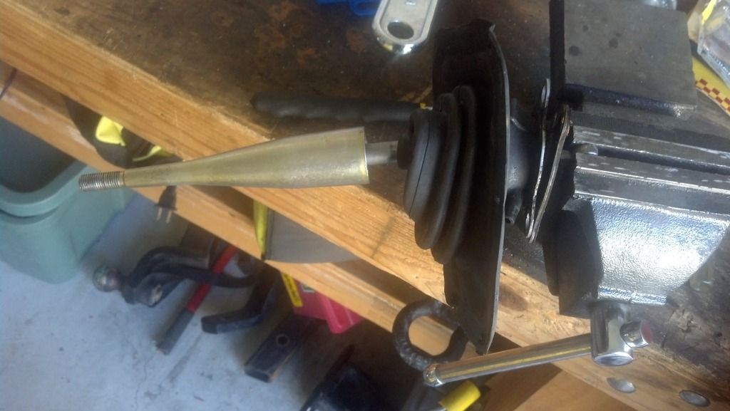

and 3rd-If I need to pull the replacement off my old lever how the heck do you separate the gold (outer lever) from the inner to get the boot off? I removed the c-clip and both washers but it doesn't seem to unscrew and tried driving it off with a punch no dice. Here are the parts I'm trying to separate.

Edit: well I separated the two levers glued with rubber bushings. Don't think I could comfortably strip down the new to me one w/o damaging it, so I think option 3 is off the table. Leaning toward rtv and cross fingers.

Is the boot stretchy enough to gently shoehorn over that gold lever?

There is a enough oil that splashes around in there that the split boot will ooze a bit over time. A piece of black gorilla tape, some RTV, or black silicone should be sufficient.
