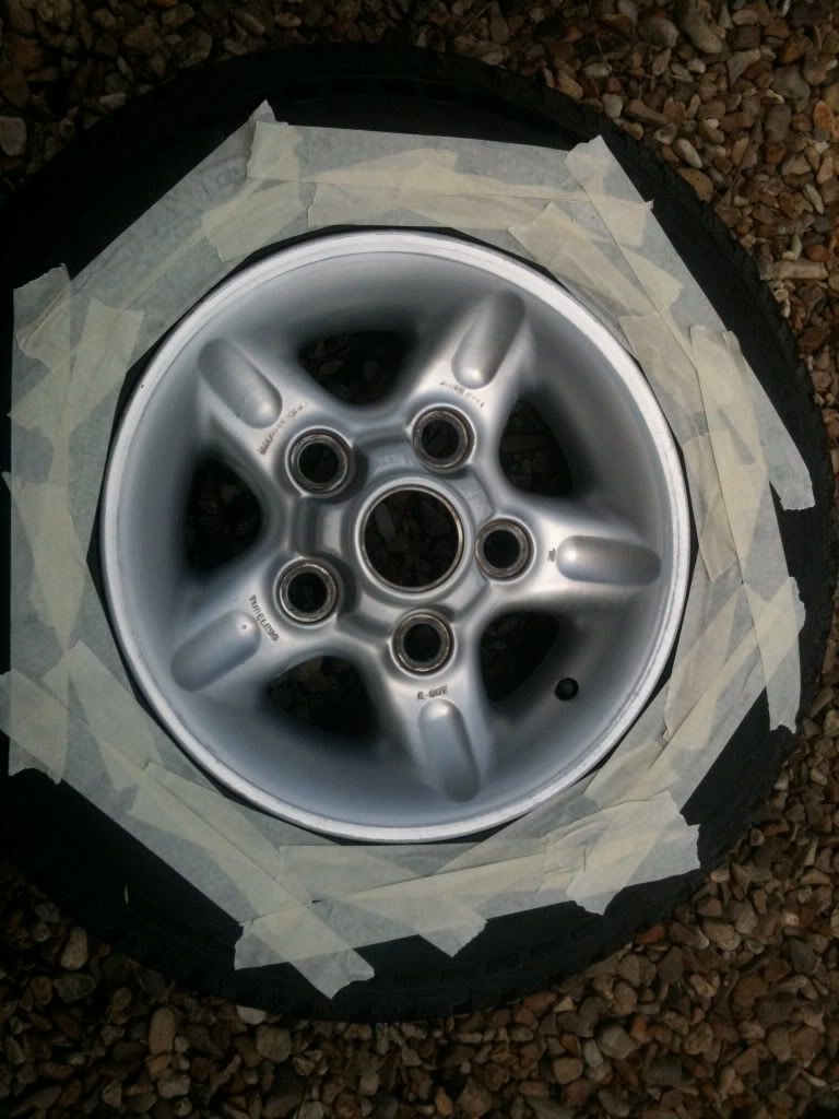

Looks good to me.. Sure id like some steelies but I have way better things I can spend money on. Such as new tires and bumper.
The paint holds up fine, and the best part is if they scratch or get banged up just recoat them.
I never use a gloss finish on m vehicles though I have on my friends "ricer" car which also held up fine.
As for painting. Its super easy. Most important part is sanding. Sand it all good. As for taping you dont have to cover every little bit of the tire. The paint comes off the tire with a little time. Not to mention its quite hard to see black on black. I got made fun of by the OP for this picture before with his " HUH HUH ROUND OBJECT SQUARE HOOLELEEL :sombrero:"
Its quick I did 5 wheels in an hour and it looks great, so honestly I dont give a fk :coffee:

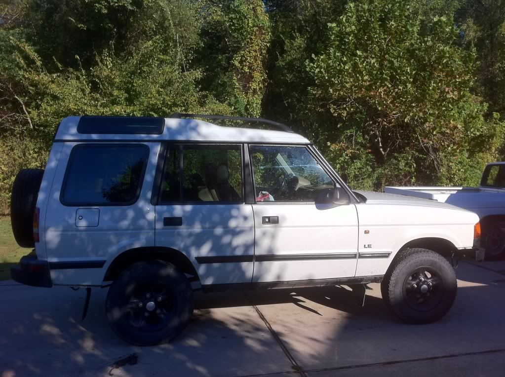

i painted my aluminum wheels black...come at me bro!!!
More power to you! It's your vehicle. I really don't understand why people are so concerned about what color you paint your wheels! Come on now! There are a lot more important issues. I remember when I first joined here, a guy was run off in part because he dared to paint his wheels black. Makes no practical difference, just aesthetic. It's a utility vehicle, so why not?
