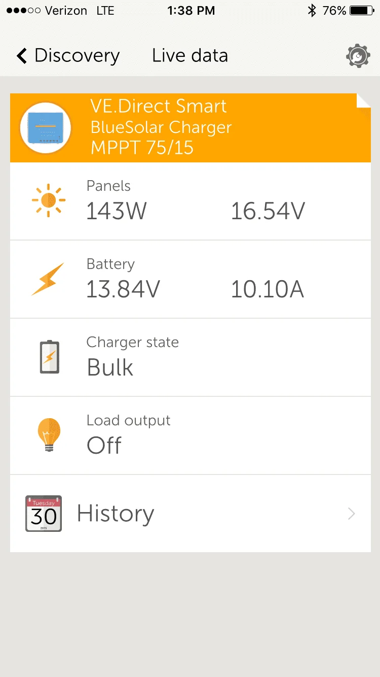

I am in the process of thinking through my solar build and I really like the looked of the Victron with the BT module...glad to see others are using it. Any issues with them? Any regrets?
Semi-Hex
Enfant Terrible
If you do read the above link, there was a long discussion about this controller. In my opinion, it works very well with my 100w Renogy suitcase but I will be moving up the the Grape 180w panel the group got when HD had a sale. The Blue Tooth dongle works very well and is very convenient to use. You can set the parameters you fit your battery. The blue tooth range has been surprisingly good.
AndrewP
The biggest advantage of the Victron in my view, is the ability to easily adjust charging paramenters. For instance, I set my absorb voltage to 14.8, and my float to 13.6. This seems to work extremely well for me with plain FLA batteries. You can also set this charger to equalize batteries, which I have done once to all of mine. This can help prevent/reverse the stratification of acid concentration you can get over time in flooded batteries. For the most part, I leave the equalize function off. But if you turn it on, and set the interval at one day, just hooking up the battery will initiate a charge cycle followed by and equalization cycle.
Anyway, there are lots of right ways to do solar, and it adds significantly to your ability to stay in 1 place for several days, and have plenty of power for your needs. I'm running 2 refrigerators these days and the extra power is nice.

hour
160 watts with seasonal tilt:
img_0267-jpg.1352282
Any up close pics of how you pulled off the tilt and latching of the panel? I'd greatly benefit from doing something similar to you but can't wrap my brain around the hardware involved. It'd also help me to be able to stash things underneath the panels, something I currently cannot do.
Anyway, my setup:
2 x 100w Renogy panels in series
Victron 75/15 with bluetooth module (this charge controller is amazing and the bluetooth rocks for checking stats from my chair at camp) - it only took me going through 4 junky PWMs!
~110ah SLA battery under my storage platform
I absolutely love this setup, and watching the fridge ramp up and start sucking power because someone rummaged in the fridge too long. Unless the sun is setting when this happens, the battery remains in float despite having over 5 amps pulled from it.
