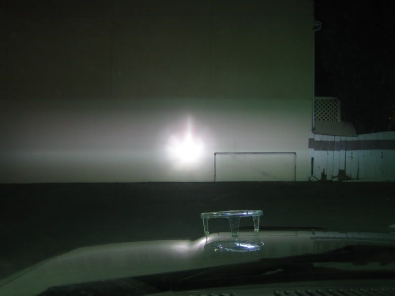

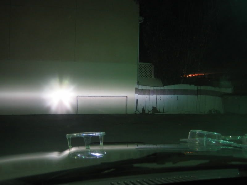

Rexsname, here are shots of the beam pattern of one 170 with a combo filter and the light was adjusted to full spot before installing the cover, the wall is about 40ft. away. There is a bunch of ambient light but you can still tell the beam pattern:
far left:
far right:
I forgot to do the dispersion filters, but I threw them on when I got back home and they are definately throw the light everywhere, not just side to side. They look like they will work great for tight trails though.
