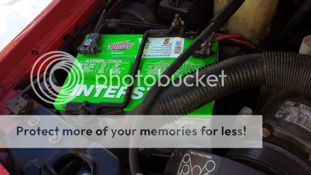

So I got a few things done last weekend. First was the rad, no pictures of that as I was rather busy. It was rather easy to do other than breaking the fitting that attached to the rad from the transmission. (10 dollar part plus a couple hose clamps) At the same time I put in a new battery as the old one wasn't holding a charge whatsoever.
Put in a interstate battery with 700 CC amps.
Here's a link to the rest of the info on it
http://www.interstatebatteries.com/...|Jeep_Cherokee|2000_Standard+Battery_L6/4.0L)

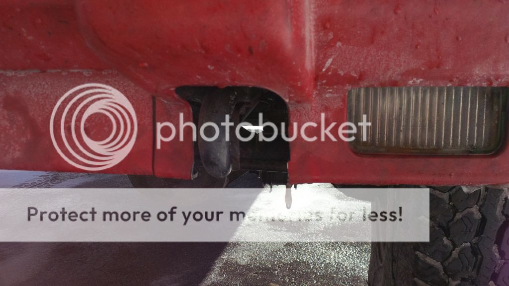

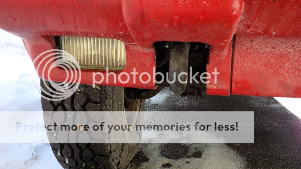

Also finally got these installed:
Wasn't so bad but I had to cut the plastic fairing below my bumper as they wouldn't fit through. They aren't the cleanest cuts and I probably will clean them up next time it needs an oil change.
Left side:
Right side:
I'm just happy to have tow hooks on the front now. Don't have to worry so much about getting stuck when goofing around in the snow and for the trails in the spring!

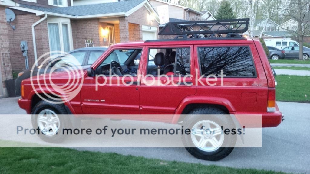

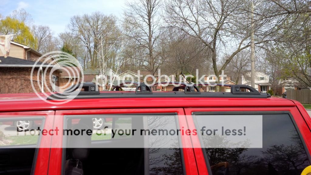

Did some clean up and prep today on the XJ for next weekend. I'm leaving Friday for bald Eagle State Forrest with my brother and his Xterra. Should be fun. I picked up some extra load bars for dirt cheap because I was getting a lot of noise with my tire up top. So I remounted the roof rack. It sits a lot higher now. Not sure if I like it. May look into another solution. Rain gutter mounts would be ideal but unable to find anything that doesn't cost an arm and a leg.
Anyway. Pictures:
vonguido
Have you looked into JCR offroad? They sell gutter mounts for cheap and are sturdy as heck. Idk how much it would run to have them shipped up to Canada though.
