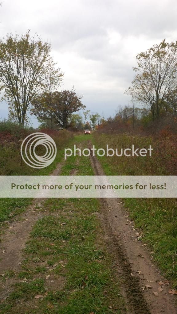

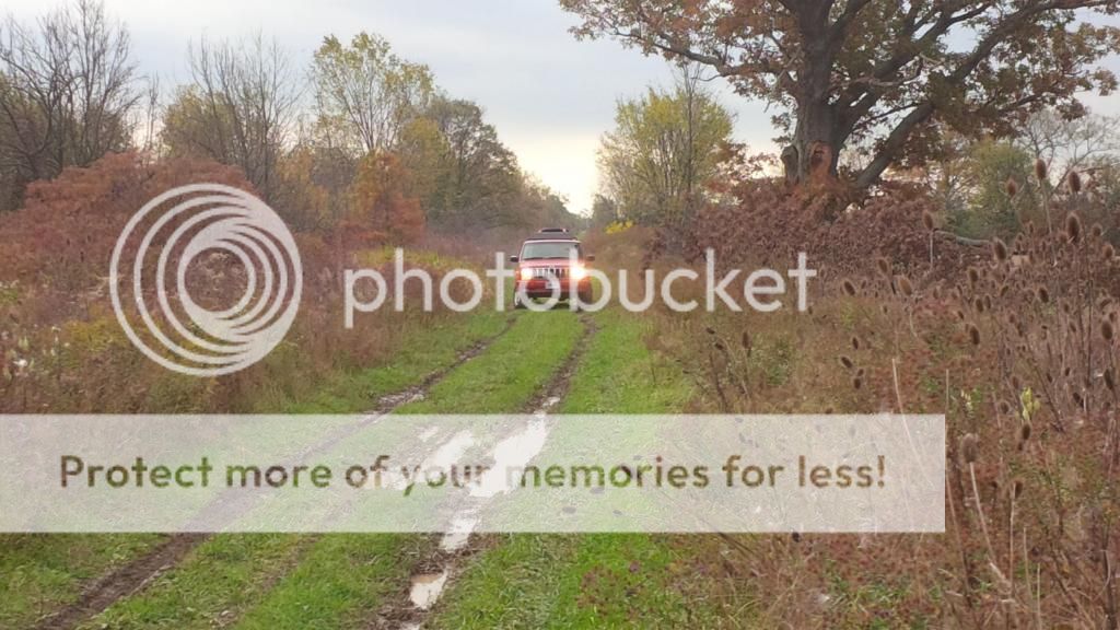

Went to my brothers in laws this weekend to oils pray the vehicle and do an oil change. But that wasn't the exciting part. There's a "road" nearby the runs between some farmers fields and it can get a little slippery and mucky out there so we figured we'd try the new tires out.
Let me tell you they are no where near as good as a MT is but they still surprised me!
Now for some pictures
My favourite picture so far:

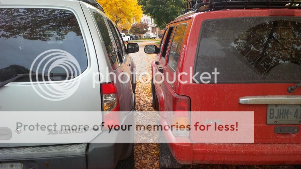

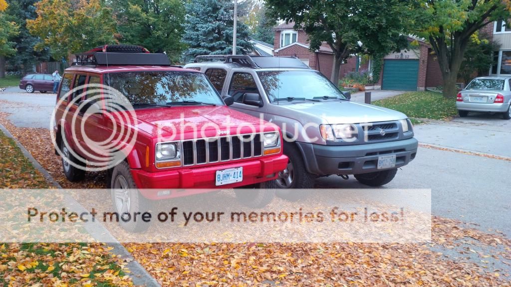

And here are some pictures of my brothers and I's rigs together. He has a 2001 Nissan Xterra with ~2" lift and some 235/85/r16's. As mentioned earlier we will be taking both of these vehicles down to Maine in the fall of next year for a week of camping, exploring, off-roading and hiking.
You can see the difference in width here. His 235s vs my 215s

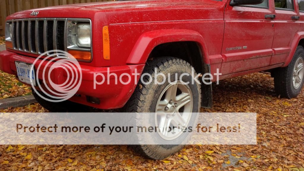

Muddy tire

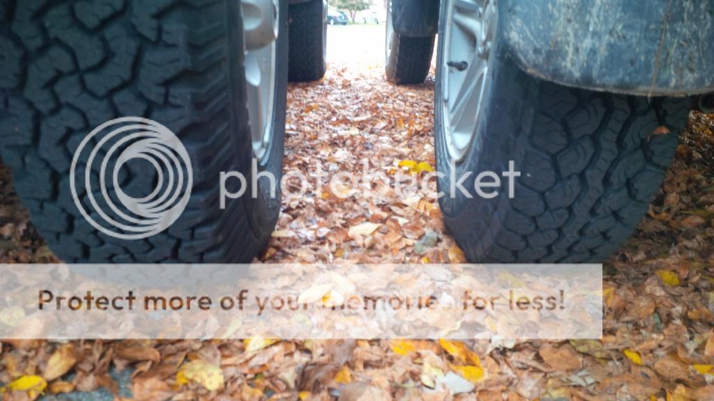

Close up of the tires

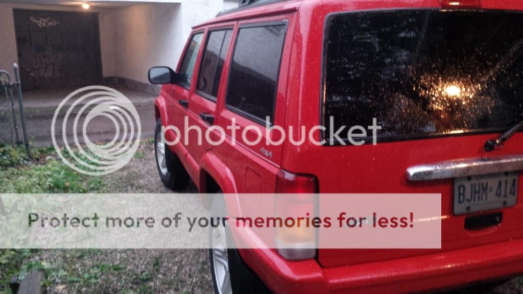

Inset from the fender a little to much for my liking. Will most likely get some spacers down the road.
Don't put them too far out there! You'll end up with the issue I had with the wheel/tire combo that came on my XJ. Muddy sides just from driving down a wet dirt road!
[/URL]
I swapped the wheels out for some stockers and it was much better!

Love those skinnies! kinda looks like 7.5 x16's?
Bet the XJ getting good mpg as well!
Thanks man! They are 8.5" wide on 16" rims they are 30.4" tall
Not to sure on MPG yet. Ill have to do a few long trips and report back. i was getting about 17 half highway half city. all highway I am getting more like 21/22mpg
Morticon
Don't put them too far out there! You'll end up with the issue I had with the wheel/tire combo that came on my XJ. Muddy sides just from driving down a wet dirt road! I'm digging your Jeep!
Thanks for the compliment on the truck! yeah I wont put them out much farther Probably just a 1" spacer

30-32psi would suffice, 40 is way overkill and you'll probably wipe out the center of the tread prematurely with the tires being over inflated. The high air pressure you're running explains why the traction was limited on the muddy 2 tracks you were on. The tires were too stiff and you were skating around like it was ice!
Morticon
No I totally understand that. I didnt air them down as it was a short little stretch and wasnt worth it.
As for the tire pressure for the road, I will be sure to check that the tread is fully touching and not running on just the centre. My point of reference is my brother running his 235/85s. He runs 45PSI with no issues.
