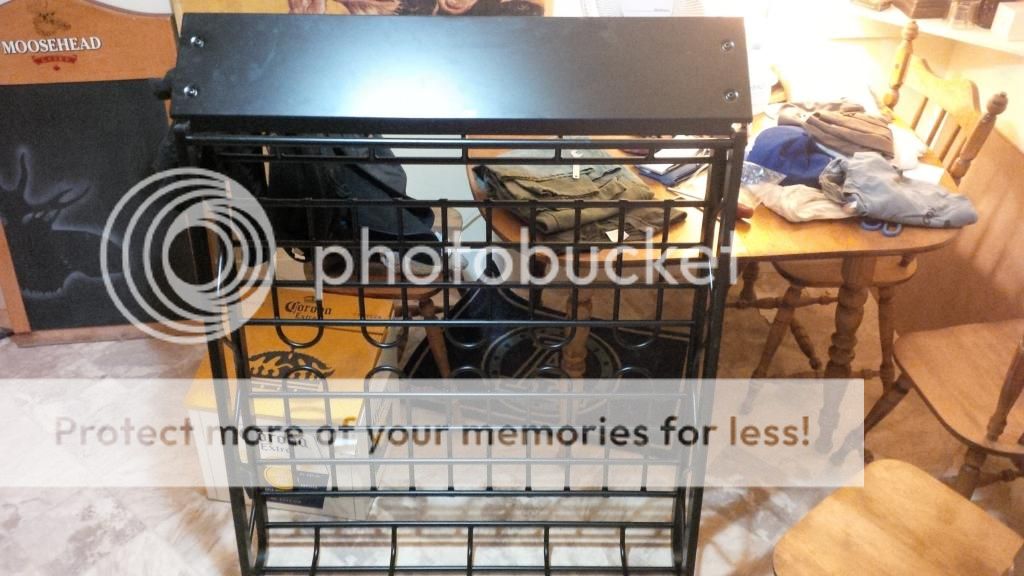

Here's the rack. Post assembly.

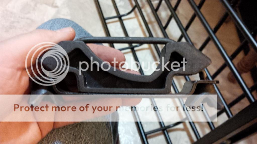

Here is the mounting hardware.

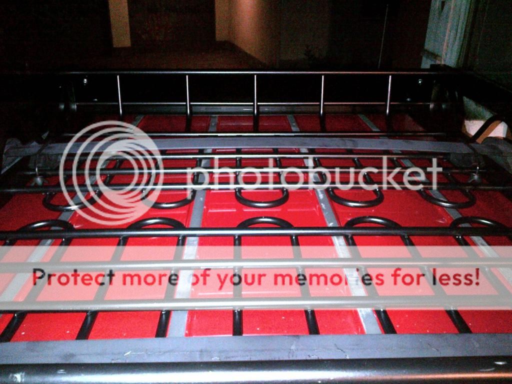

And here are some dark night shots! Haha.

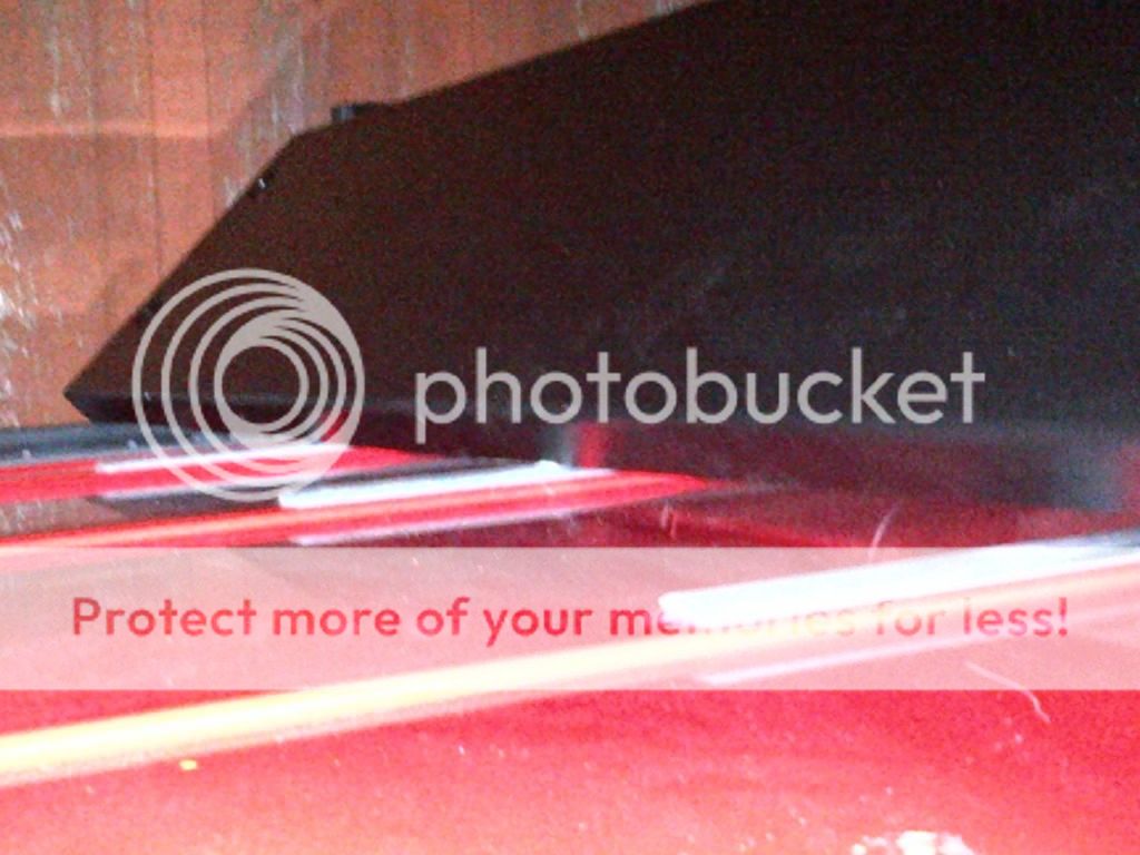

As you can seen there are some raised parts to the roof of the XJ. It pretty much sits on these plastic strips.

Top view
This just shows the cross bar going through the rack. It doesn't take up much space or effect putting stuff in the basket.

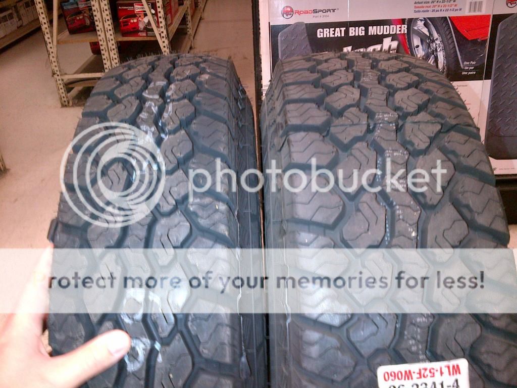

For now here are some side by side comparison shots of the two sizes.
You can see here how much skinnier the 215 is compared to the 245!
Height difference: the 215 edges out by a mm or 3 on the 245
