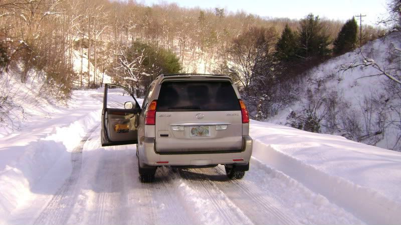

The GX only has 42K miles...never been off road, 'cept the below pic taken in Virginia after a blizzard while we were on vacation YET it is having issues with the radiator. It has a very slow leak...needs about a cup of fluid once a month. The Lexus dealers quoted us an insane amount to replace. I eventually will do it myself if it gets worse.
The leak area is on the drivers side, lower radiator "tank".
I mention this since yours received a new radiator...leaves me to believe the Yota radiators on these GXs are crap.
