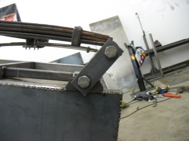

made my own shackles out of 1/4x3" stock. Had to cut it down to 2" wide. They are 6" long 4" center to center. I welded them too steep, I know. The flat springs dont move too much though so it's not a problem until I get better springs.
