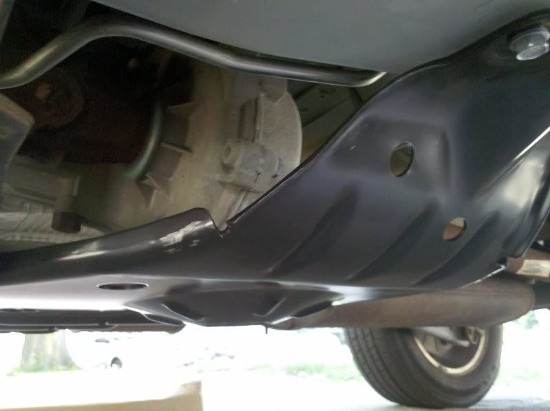

Also, my Limited didn't have any skid plate protection for the transfer case. I didn't want to attempt taking it off road without something underneath so I purchased the factory Up-Country transfer case skid plate kit. It came complete with the skid plate, nutserts to install into the uni-body, nutsert install tool, and bolts.
Unprotected transfer case
Factory skid
Installed
Since rocks are few and far between around here I figured it would hold up for now. If I need something beefier then I'll upgrade it when the time comes.

The Swiss
Factory skid
Installed
The factory skid is all I ever had; it did very well, a lot sturdier than what it appears.
