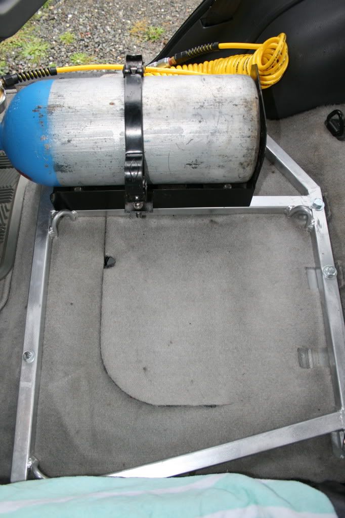

Truth be told im not sure, i know ARB says that whatever you use should be capable of actuating the locker three times without the compressor kicking on. Im hoping for that.
To be clear, im not using CO2 to actuate the locker, that tank will function as the strorage for the on board air, powered by my underhood compressor. On board air for filling tires will come in the form of a 10 lb CO2 tank. I still need for figure out a clean mount for it.

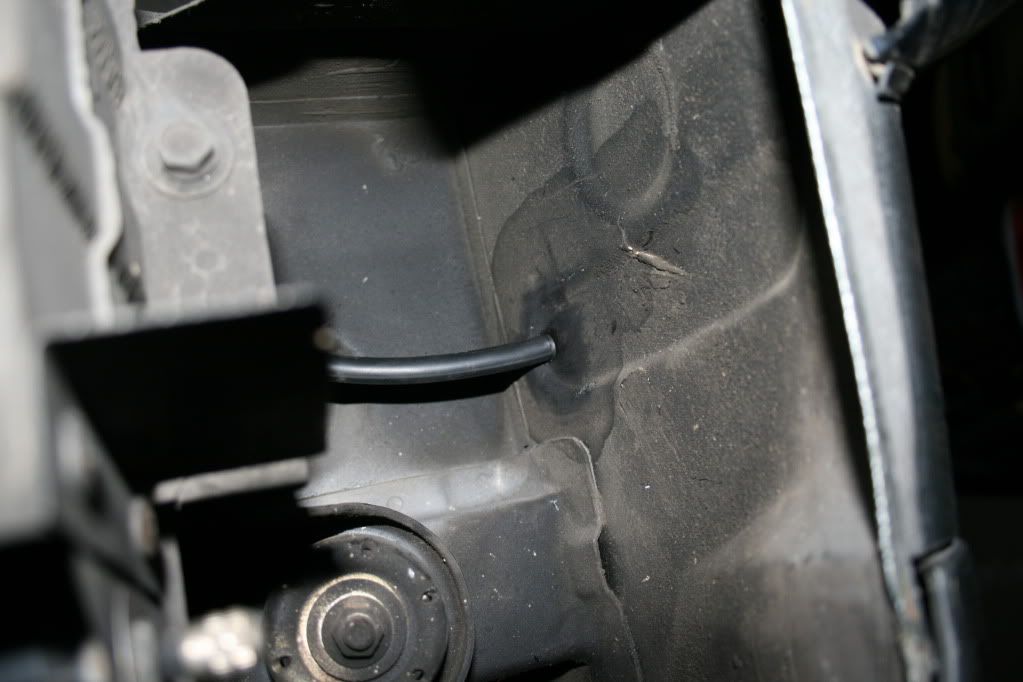

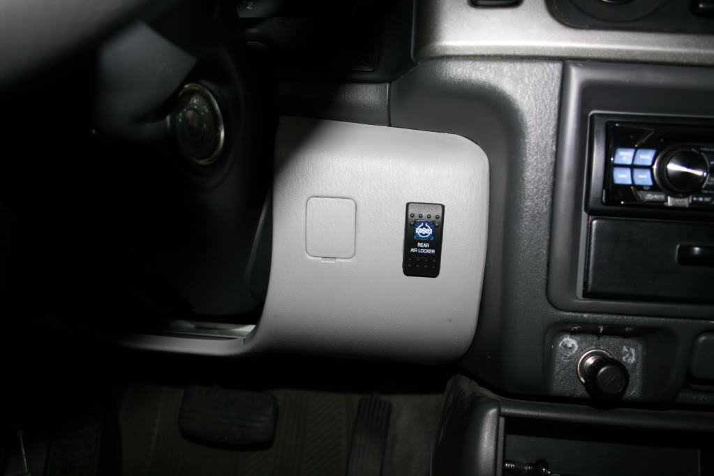

But i did get the ARB switch mounted and wired, along with plumbing the airline from the solenoid all the way down to the diff. I sleeved the airline in one long peice of rubber hose from where it exits the quarter panel down to the diff, hoping to fend off an abrasion to the air line.
I have a question for those who have wired up the ARB switches. I used the diagram that ARB suggested and everything works good, well almost everything; the dimmer function of the switch. I didn't want to hack into the factory harness and tap into the dimmer wire, my solution was to tap into the unused dimmer wire on my stereo wiring adapter. When i installed my alpine head unit, the dimmer wire was not used, how convenient! I connected the dimmer wire from the stereo adapter harness to the ARB switch and now the ARB switch dims opposite of the rest of the lights. When i turn the interior lights down, it gets brighter and vice versa?!?! any ideas?

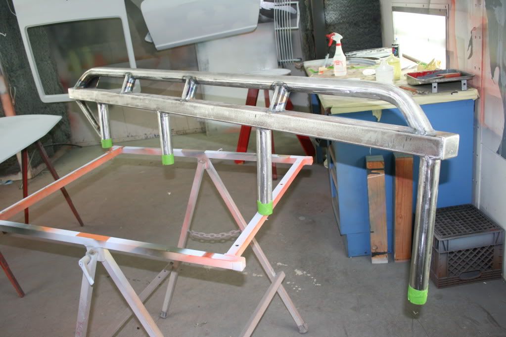

In other news, rocker gaurd progress has continued. I got the scab plates, all eight, TIG'd onto the frame, and have one side almost completely built, i just need to weld up the outer bar and gussets.

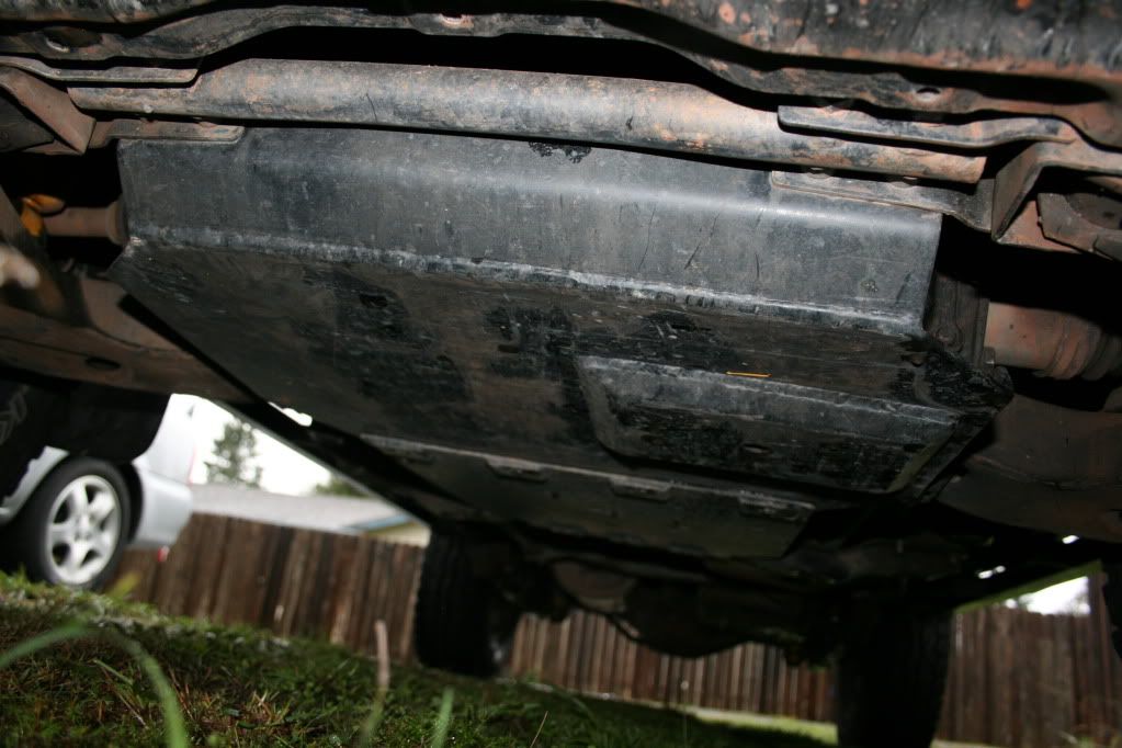

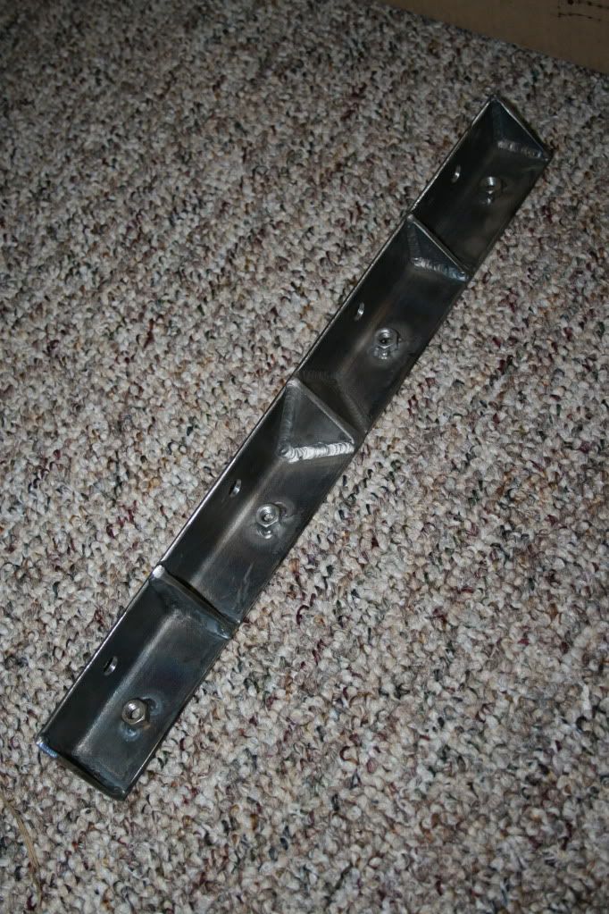

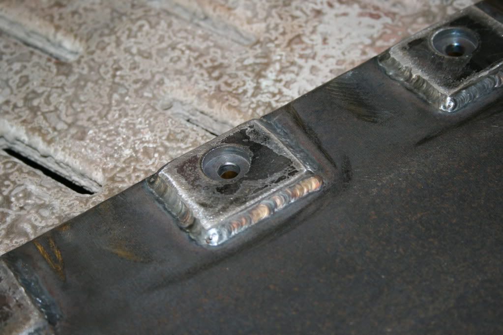

As time continues to tick by, my montero sits in my garage for the third week in a row while i wait for the shop to install my ARB. Because i lack all the cool tools in my own garage, progress has been minimal. But with some careful measuring i was able to finish building one of the rocker guards and my trans skid. Progress simply must happen faster, and im hoping it will. That pesky little thing called work keeps getting in the way. Pictures speak 1000 words:
Trans skid vehicle side:
Trans skid ground side
Close up of a bolt protector
Rocker guard getting ready from prime and paint.
Skid plate mounting bracket
Mike
shmabs
Metal Fab
off-roader,
That would be my handy work, its nice having access to a decently setup shop. I did just get done proving that once again, i can't vertically MIG very well, at all. I'm hoping the montero will be drivable soon so i can TIG the sliders on. I'm hoping for good news regarding the locker tomorrow.

-with my current air setup including the re-purposed C02 tank it looks like i will get about 6 actuations out of the locker before the compressor kicks on.

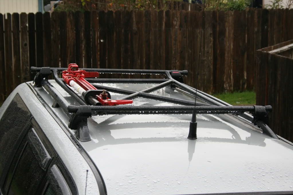

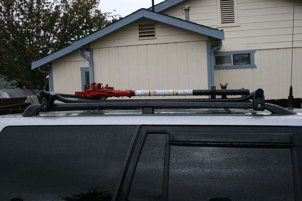

I got the roof rack finished up. I wanted somewhere to stow the high-lift, plus a platform for extra gear storage, while keeping it as low profile as possible. Given my time and budget crunch i used what i already had. The yakima mounts were given to my by a friend, they don't fit perfect, but they work quite well. I bought some tube to replace the yakima crossbars that would serve as a foundation for the rest of the rack. Hold you laughs please.......the rest of the rack is made from conduit!!! Not an ideal material choice, but this rack was originally just supposed to be a proof of concept, it actually worked quite well.Two corner gussets with with nuts welded on the back side would provide the mounting points for the highlift. Some poly leaf spring bushings and some long "wing-bolts" that were previous project left-overs, and my highlift mount was complete. Four small rings were added to each corner to serve as tie down points. My friend and i both stood on top of it (looking for my brother on kane springs) and there wasn't any noticeable deflection. A wind fairing is in the works.

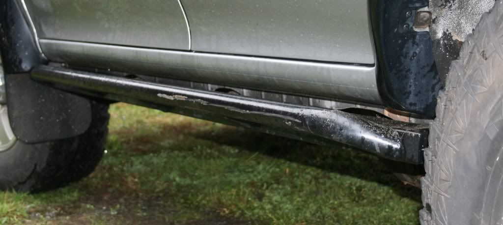

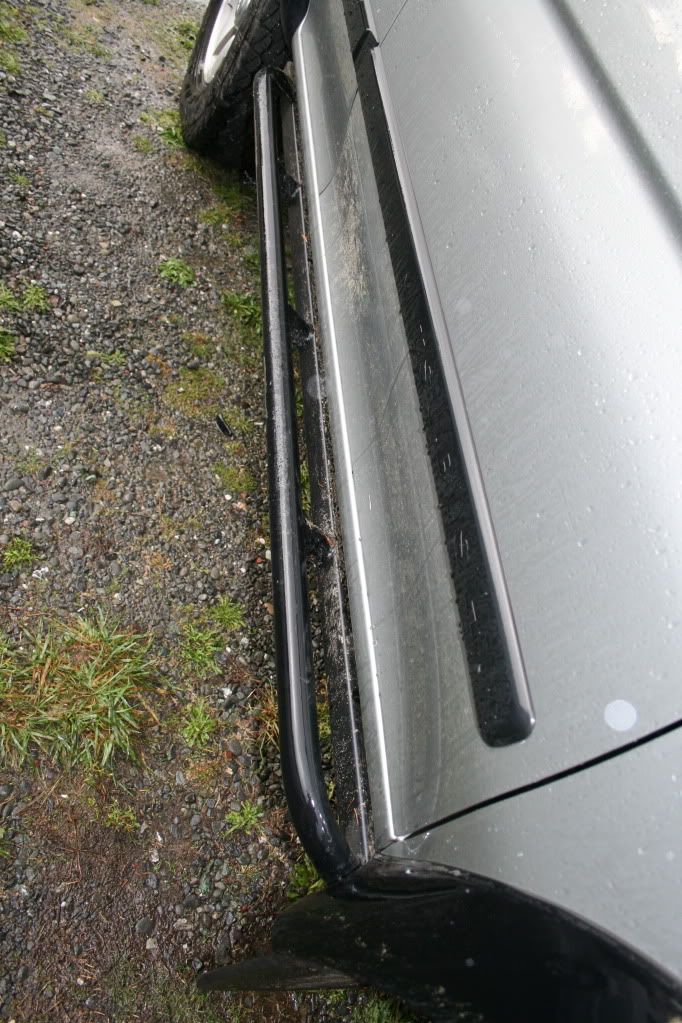

The sliders got painted and welded onto the scab plates i had previously welded to the frame. My lack of a 220 MIG meant i had to do my best contortionist (sp?) impression to get them TIG welded on. After some gusseting on both sides and painting the rest of the legs, they were done. On several occasions in Moab they proved to be a valuable piece of armor, if it weren't for them i would not be able to open any of my doors. If i could do it over, i would have mounted them a little bit higher, even though i notched my pinch seam for clearance, i think i could have got them 1/2 inch higher or so. sorry for the dirty pictures
A secure C02 Tank mount was quite the problem for me, i went back and forth many times trying to figure out what is best. Ultimately my solution was satisfactory, and provided a good cooler/tool mounting area, but it came at the price of removing part of the rear seat. I built a rack that picked up all the seat and seat belt mounting bolts of the removed portion of rear seat. I welded in some "cross members" on the outer passenger side to pick up the mounting holes for a fire extinguisher bracket. There are also tie down points at the corners for the cooler/tools, on the plus side my new pelican case fits there almost perfect.
