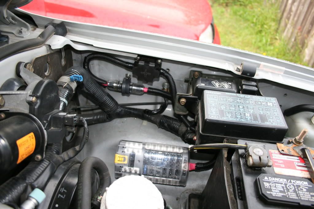

I knew i wanted a good quality aux fuse box for this build, after searching around my local area i found the blue sea systems 12 circuit negative bus unit at a local marine store. Being that it was the only one they had in stock, and for a good price, i grabbed it. Originally i wasn't planning on using a negative bus bar fuse box, but after some thought, i think i will like it. If i choose to run my power and ground back to one spot it will make the initial wiring slightly more difficult, but trouble shooting will be a breeze.
I also wanted a high capacity, yet small size 100 amp fuse for the whole box itself (blue sea recommends a 125 amp max) I found the mini ANL style fuses and holder and a local stereo shop. While changing the fuse wont be a 30 second task, i like small size of it, and ease of mounting.
The small black power box is something i removed from a mid 90's gm pickup. I liked the idea of a separate power tap, it made the install a lot easier, and future maintenance/fuse changes easier. With another slightly longer bolt i could add another high amp connection.
All wiring is 4 guage, crimped and heat shrunk. For the main power i tapped directly off of the battery. The whole idea is to have a minimum amount of cables running off of the positive lead, hence the additional power point and fuse box itself. Currently there are the factory two, and my one additional. Marine/HD style terminals are in my future for sure.

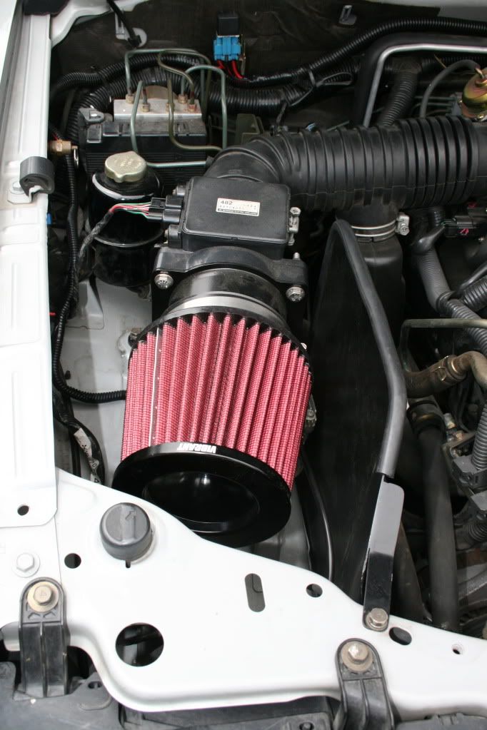

I also got my simple intake built to make room for the compressor which will eventually run my ARB. I dont have any good pics yet, but it a pretty simple MAF adapter, a Vibrant Air filter and heat shield. The compressor, and eventually pressure accumulator for the system will live beneath the air filter, which was the whole reason for ditching the stock airbox in the first place. Feels good to make progress, even if its very minor.

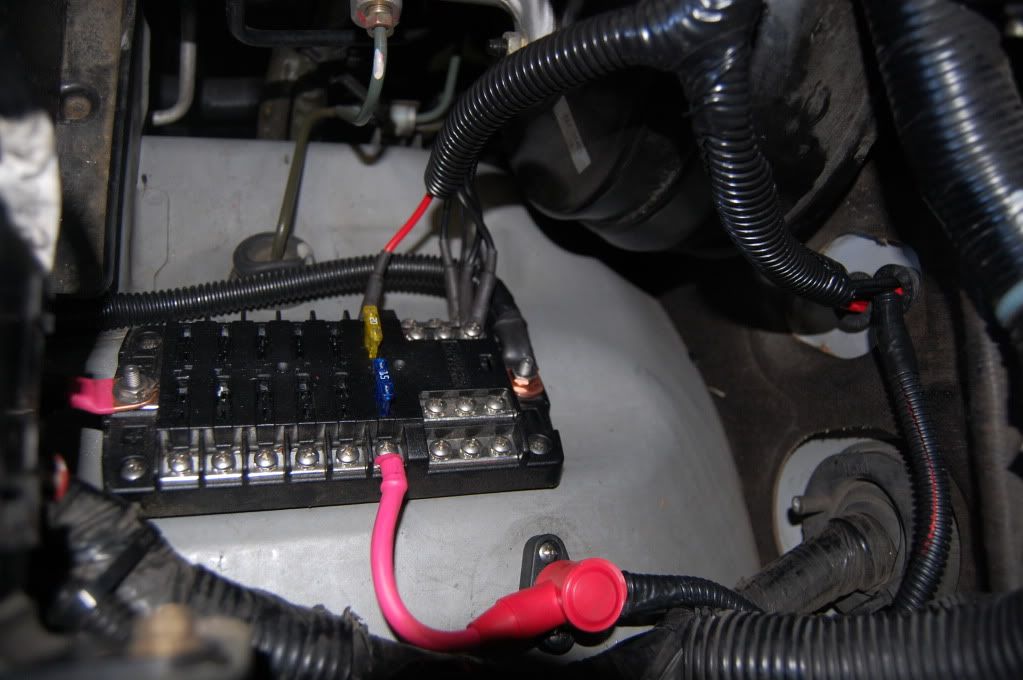

First is a simple stainless steel bar i made when i upgraded to the marine style battery terminals. I simple peice of .125 flat bar and some .250 SS bolts cut off and welded to the bar. I originally had it mounted stud side up, but it was a little too close to the hood for my comfort. Luckily it worked well flipped over. Also the neg terminal was upgraded.
Here is shot of the fuse box doing its thing, i installed a blue sea systems power post next to the box. This will be used provide the power for the relay "triggers". You can also see were i ran the wires for the switches throught the firewall.

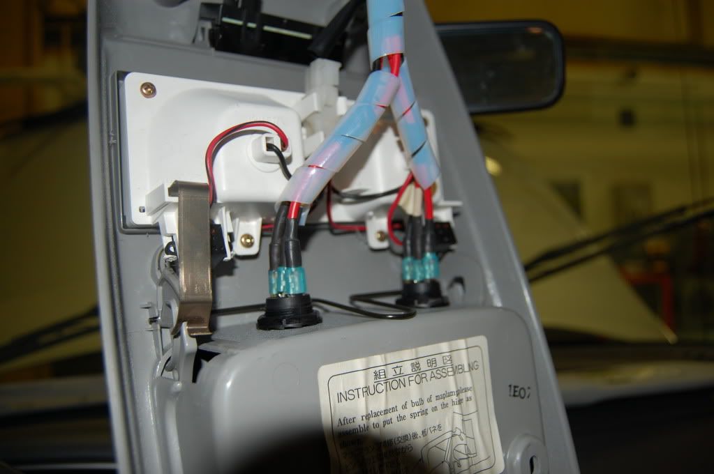

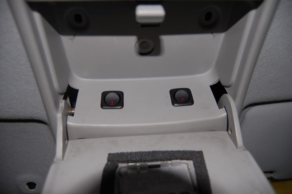

Speaking of switches, here are the two that i ran into the overhead console. They live in the garage door opener space, as it is the only compartment in the overhead console i dont use. One is used to control the compressor, the other is blank for now. I ran wires for both switches behind the headliner down the a pillar and out through the firewall.

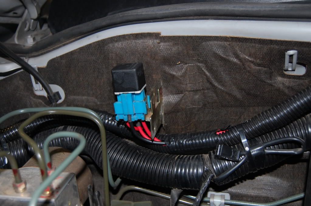

I thought long and hard about where and how to mount the relays, i knew i would be using at least two in the near future and wanted a clean solution for them. Budget is always a concern and after looking around at relay mounts i returned to my assorted electrical drawer in my vidmar. Its full of stuff i have grabbed while junkyard scrounging. Greeting me was a relay holder bracket that i removed from some older german car (im thinking BMW E28). Upon closer inspection i was elated to see that the back half of the relay sockets was easily dismanteled, allowing me to wire it as i choose and having the option of SPST, or SPDT relays. I pulled it all apart, mounted it and rewired as i needed. It got mounted on the passenger side of the firewall with some stainless 10-32 screws. (they are commonplace in my electrical upgrades underhood).

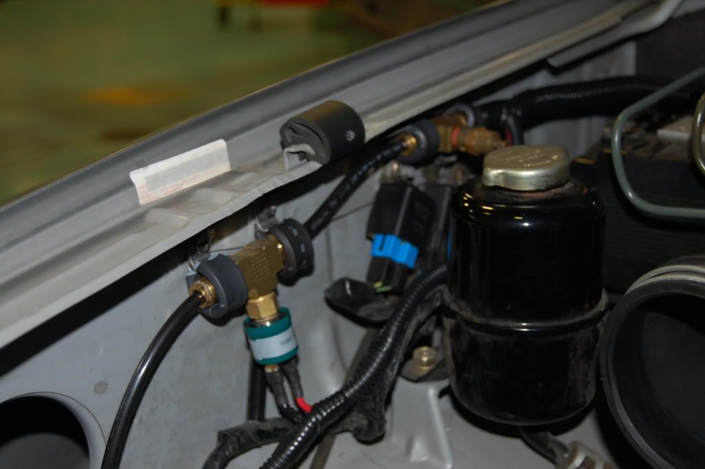

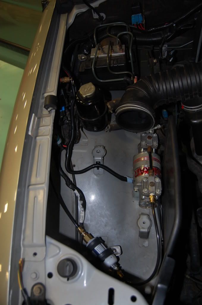

here is a good shot of my compressor mounted, along with the filter/dryer. The filter/dryer is attached via some high strength adel clamps to a stainless steel flat bar mount that picks up one of the factory airbox mounting holes. I used .250 air line all around with push lock fittings. In my days working on trucks i grew quite fond of such setup.
Here is a shot showing the pressure switch (on at 90 and off at 120), along with my pressure relief valve. Both are mounted with 10-32 SS machine screws and adel clamps. I dont care much for self tapping screws.
And a shot showing the simple intake and heat sheild setup i had to build to make room for all this stuff.

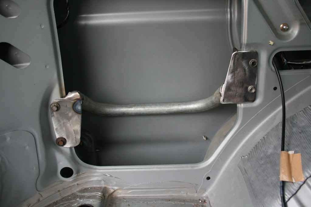

The air tank itself provided another challenge. I wanted a decent size tank, mounted somewhere unobtrusive. Again i returned to my garage after an unsucessful week of searching locally and online for the "right" tank. Sometime ago i bought a make your own soda kit a at a thrift shop becuase it had a nice 7lb aluminum tank, meant for CO2. I tend to be a bit of a scrounger/picker, which helps when operating on a budget. Im into the tank, fittings, and hose clamps for about $9. I fabbed a simple bracket to pickup four factory holes that are found behind the cubby in the trim panel. Ideally i didn't want to lose any of that cubby space, but i ended up losing the lower inch or two. Excuse the old crappy hardware, it was only used for mockup. You can also see the ARB solenoid in the top right corner. I still have to plumb from there to the locker itself, im still not sure if im going to use that solenoid.
