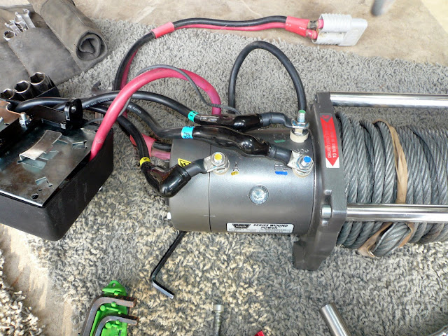

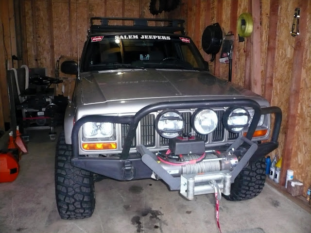

winch update...
since got the winch back, figured I would freshen up a bit the carrier & get everything put back together...

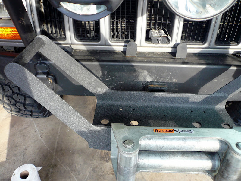

Wires & Bracket
Paint came out pretty good, nice texture to it...
All back together... (WARN stickers on windshield)
I'm loving the stickers...

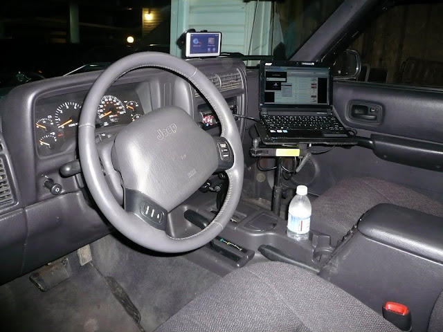

JOTTO DESK install...
Seems like everyone is getting themselves as comfortable as they can with various hook-ups, including laptop/notebook mounts.
I came across a used JottoDesk setup off a police Chevy Malibu. Figured with a little modification, I could make it work...
Will need to do some extra mods as far as getting it to perfection (not getting into passenger leg space), but other then that cant complain.
Anyways, here's what we have...

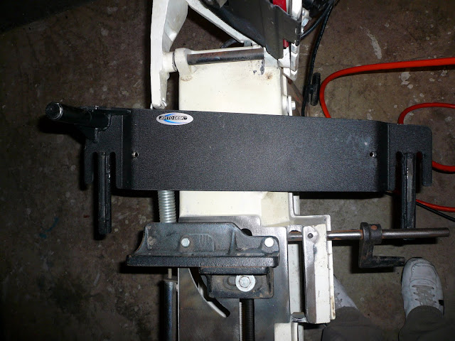

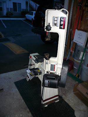

Jet Bandsaw - used off Craigslist (figured $200 was a good deal)

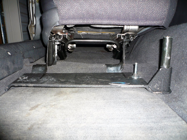

Bottom Mount plate
Edges cut to fit XJ's floor...
Front view (floor mat even fits right under it...)

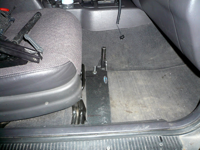

Will have to get couple of grade8 bolts/nuts on the bigger side to hold it all together.
Drilled the floor and bolt put from underneath, had to fight carpeting a bit (was getting wrapped up around the drill bit).
Bolt / lock washer / washer from the outside, and on the inside a washer / lock washer / nut to secure the actual bolt. Another washer / lockwasher / nut on top of the mounting bracket. Figured that will do a better job supporting it.

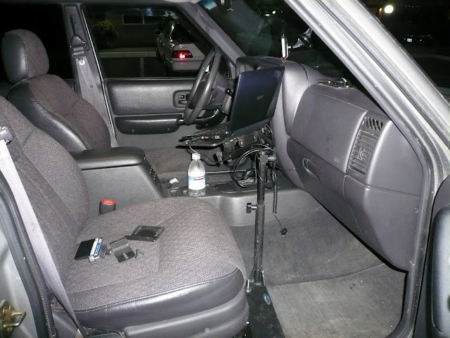

When upper stand is removed, its NOT even there...
All put together...

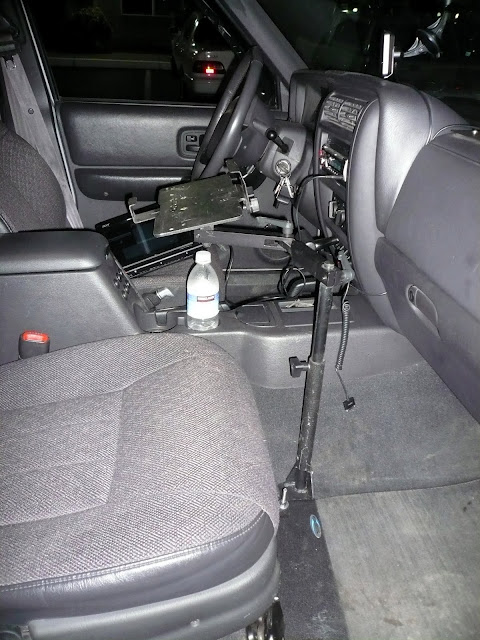

Driver's View
Passenger's View

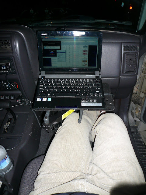

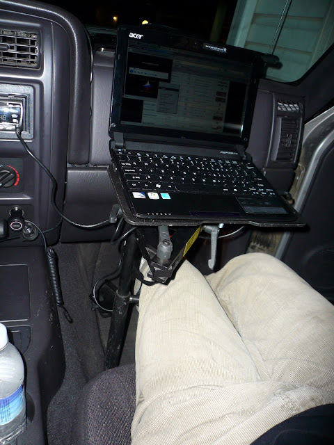

How it looks with passenger's legs there...
SWbySWesty
Fauxverland Extraodinaire
neat laptop mount. Seems slightly intrusive on a larger passenger's legs though...maybe a little kink in the tubing would help? You obviously have the skills!
Nikson
This specific unit was pulled from a police car while back, thus I dont think there was much concern for passenger's leg room, or could have been that design for that car was okay in this type of setup...
I figured that on short trips (for now) it will be fine... and in time - I will do as you said with the location of the STUB for the mount, move it closer to the center, so its not as intrusive as it is now...

That kind of mount is usually kind of inconvenient for your passengers. Yours might not be as bad though because you've only got the one mount, the police cars I put toughbooks in had a couple things over there.
Nikson
They were definitely built without consideration for passenger's... :)
I'll mod it a bit, and see what I'll come up with sometime soon here...

Those are just regular stainless steel screws.
I've pre-drilled with a 1/8 bit (through flare to mounting bracket)...
Then screw them in and secure them. This will basically secure the flares to the mounting plates. Once that done, just put your flares back on the XJ & secure the 10mm nuts.
When done, tighten the screws by hand with a screwdriver until you feel it is safe & you are not overtightening & bending flares too much...
