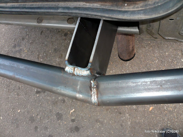

So the build continues on to the rear bumper...
I've configured it to be similar to the front, so this way XJ looks very neat in its appearance. Bumper is configured to use winch on its receiver, as well as consideration for the rear tire carrier setup (that is yet to be done).

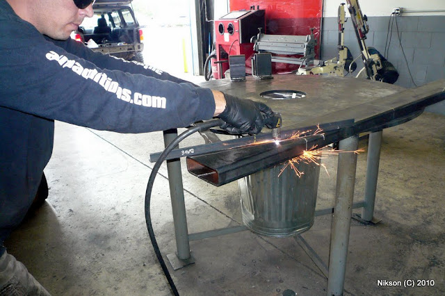

LETS CUT 'ER...
SIDE VIEW
PRE-WELDS / PRE-CUTS
MOUNTS (from left overs of the beam)
HITCH SETUP

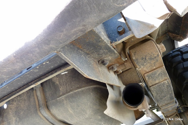

Rear Quarter TRIMS
Had to get rid of some extra's on the bottom of the quarter.
After putting on the bumper, bottom pieces just didnt fit right as they were.
Cutting them on sides and folding inside (as some have done)... wasn't my ideal plan. Had a buddy custom fab / laZer cut out of some 12ga. metal. Came out just as good as I've hoped.
With spring rolling around, will finish them up with welding some plates on the front/rear sides to finish the look of it...
Pictures worth 1000 words... as they say... so I think you'll get a basic idea on this mod.

WARNING: METAL CUTTER / BENDER in use... :)

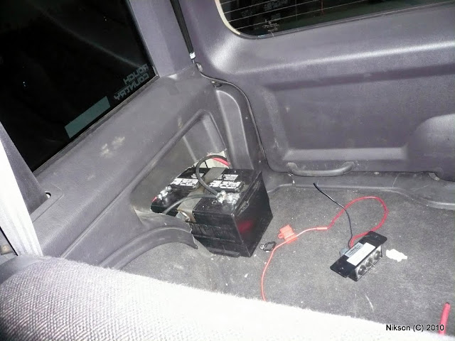

2nd (REAR) battery

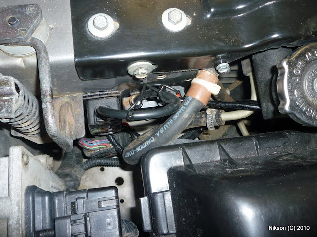

With WARN been considered as a hitch receiver type, power needed to be ran into the rear part of vehicle.
Ran positive from the switch under the hood and connected it to the one in the rear. Not sure how / why / what / when... as far as all the "breakers" & monitors that others install.
I understand that my setup might be done in a very simple and not-very-thought-through way, but it works. I dont consider myself an expert electrician by any means, but believe to have common sense on most of things that I install. Feel free to ask questions...

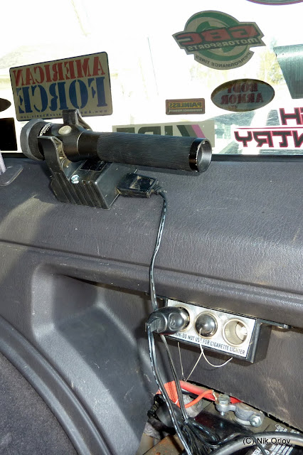

As of now (almost 12mo. later), everything works and both batteries seem to operate just fine, keeping the winch running as well as other electrical things in the XJ. I have a LED flashlight that is connected into a cigarette plug which is connected directly to the rear battery.
Winch runs great both front / back, without any issues with electrical or charging system.
As always, pictures... :)
Rear Winch plug...
Just a quick "trim" and all done. Will have a panel made at a later time to cover it all up.
BATTERY SWITCH...
Find it very simple and easy to use... in case anything goes wrong, the breaker will turn off connection between batteries...
On previous trips, disconnected the batteries, and RAN everything off the rear battery - all 3 plugs on the connections were taken up by charging batteries on cellphones, laptop, DSLR, video, flashlights... Battery never went dead. In the morning, I would just start up the engine, turn on the breaker, and keep driving... next night would be same "charging" process of all accessories...

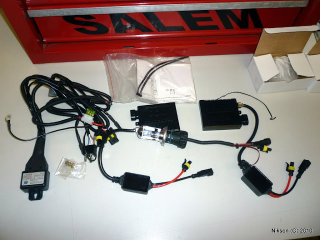

Hid install
with time going by, IPF lights didnt seem to do the job I was hoping to get out of the headlights. Now days everyone seem to be taking the HID route, at times a bit extreme with (8500k + bulbs)... and not properly configured headlight units.
from what i've been told, the VISION-X aluminum housing headlamp units are perfect candidates for such job. Cool a lot faster then others (aluminum), and glass is clean with reflector having the design of light dispersion rather then the glass itself.
Here are the install pictures...
KIT COMPONENTS (DDM TUNNING)

Bumper update
Here is a little update on some gusset work & extra support on bumpers...
I guess I might be overkilling it, but I dont think extra "security" hurts...
FRONT HITCH support on clip
UPPER VIEW of the REAR bumper...
Second battery hook-up & flashlight charge station...
