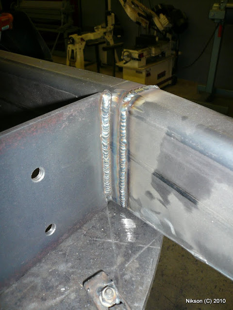

Here we go...

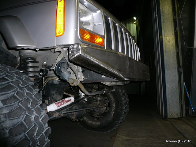

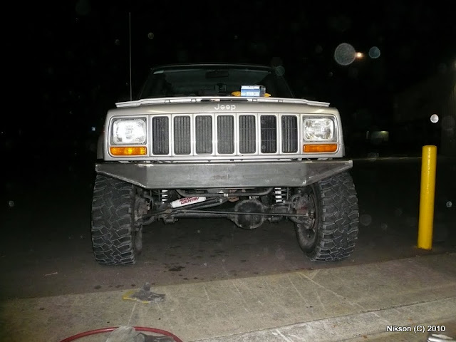

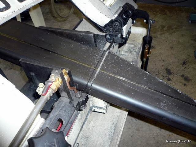

For about $50 you can get a piece of a 3/16th 2x6 steel beam in the width of an XJ. I've ended up buying it in a larger quantity, since we had to build total of 4 bumpers...
Basic ideas was to give a good "pushy" type look to protect yourself in an event of collision with another subject, weather its another car / light pole / rock / tree stump, or a larger size "wildlife".
Hitch receiver was also incorporated in order to be able to use winch front / rear. This has been a proven route, since this isnt the "first" bumper I've build in this exact way.

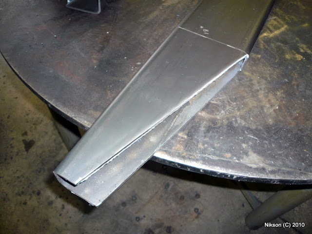

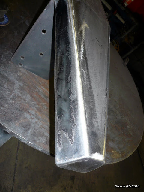

IDEA OF THE "ANGLE" ON THE SIDES...
"V-CUT" on the back side, to give it a little SHAPE
dont like the look of just flat-straight beam.
ABOUT LIKE THIS?

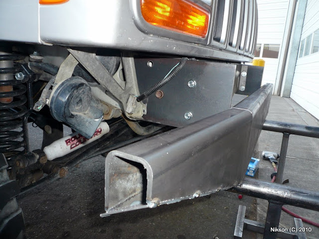

A LITTLE EXCITED
FRAME BRACKETS (1/4") WELDED along with V-CUT

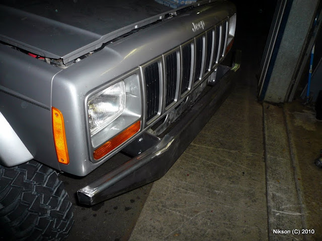

ENDS WELDED / GRINDED / SHINY :)
ALMOST FINISHED

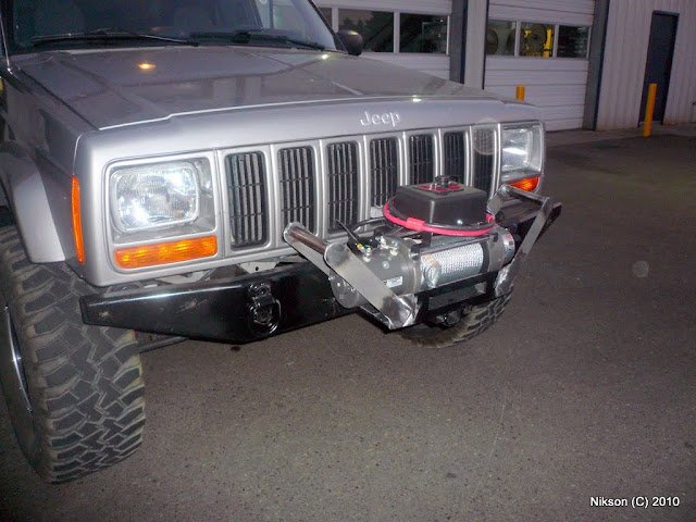

Front Bumper... - Receiver & D-Rings

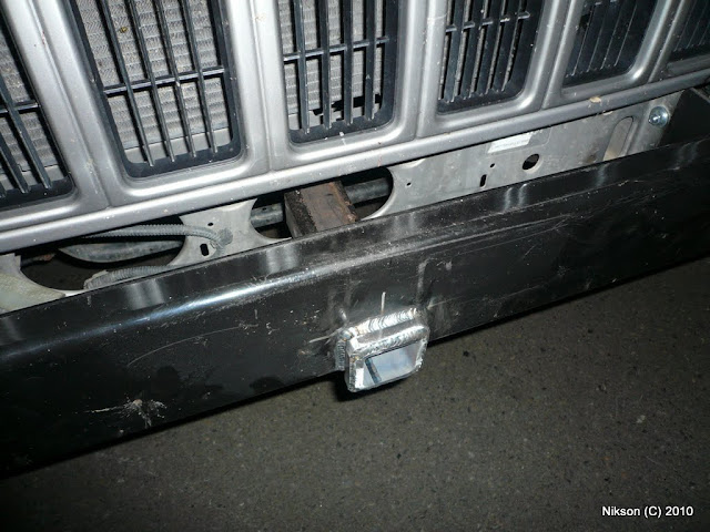

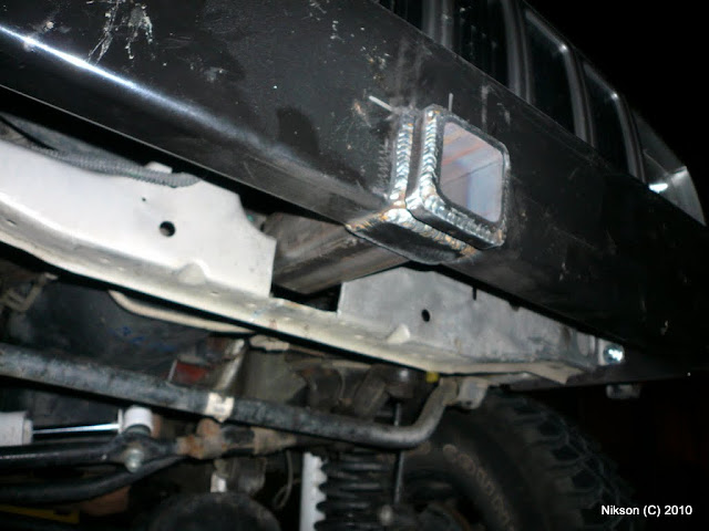

RECEIVER...
Cut out the middle-bottom portion, cut to fit (length) on the receiver square tubing & weld it in place...
ADDED some D-RINGS

Bumpers are on and working perfect... more build pics coming as soon as we get some more time for that... :)

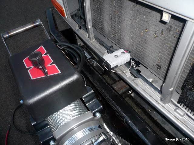

Winch setup
shall we continue??? :)
Decision.
I believe this is one of the bigger deals during the setup of any off-road vehicle. How to mount it, how it will be used, and what it will be used for. For my personal situation it was a simple " I NEED WINCH " ... Didnt really like the idea of being stuck somewhere in the middle of the woods either in the snow or else, and not have any means of getting myself out, other then a Hi-Jack & a shovel.
Once that was out of the way, i've decided that winch needed to be reasonably priced as well as not an "overkill" in LB. rating. XJ loaded with some of the gear, averages about 4500lbs, thus a 6000 lbs winch would really probably be enough for the occasional "yank" here and there, in hard times a SNATCH BLOCK can be used to ease the process...
With that said, prices differences between a 6000 & 8000 lbs winch isnt that great, so my choice was made on a WARN M8000, which still was in that perfect LB rating considering weight of the XJ, since I had expected that my winch would get used more then "average" one.
(for the record, in less then a year on my XJ, i've used it close to 100 times)
Location.
Winch is usually mounted on the front bumper and is used to winch a truck forward direction, or used to pull another vehicle out of a ditch or similar. In my case, I didnt have too many plans to pull others, since where I go, usually I am the only one there, so had to plan ahead.
Stationary front mount didnt seems to be too promising for me, so decision was made to make it mount on a receiver plate, so it can be used both front/rear as needed. To this day I am happy with that decision, being that I've winched myself out from the rear probably more then from the front...
Now that you know the story and understand whats going on... come pictures of what/how it was done.

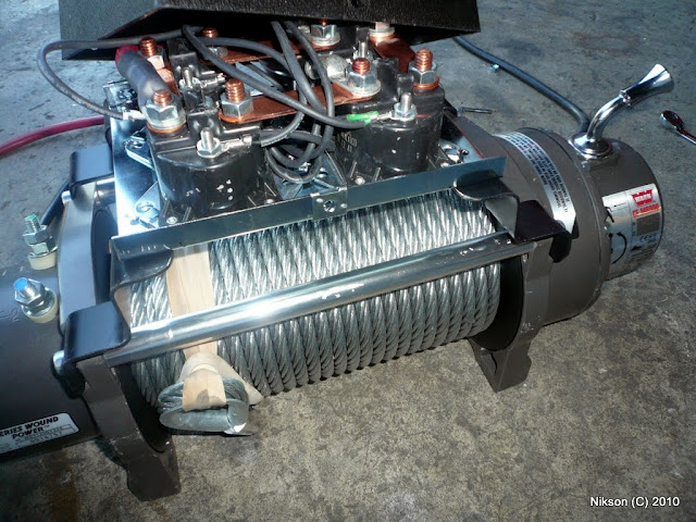

NEW OUT OF THE BOX
CONTROL BOX MOUNT
SWITCH/ELECTRICAL FOR REAR BATTERY & QUICK DISCO

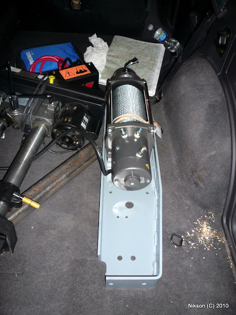

SETUP
Took a regular winch plate, cut it in length, bracketed the handles and here is the result. Ran wires from the REDTOP to the front (grill removed) and setup quick disconnect plugs (very easy plug-ins)
FINISHED CLEAN LOOK
JOB WELL DONE w/minor left overs... :)
