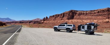

Got any pics of the trailer on your Tacoma?
4000lbsOfGoat
Well-known member
Here is the truck by itself with Icon RXT springs, set up in the heaviest configuration:
And here is the truck and trailer, with those springs, after a couple thousand miles pulling the trailer. You can see that it doesn't sit quite so proud anymore...The trailer is clearly a bit low on the tongue end. It started out level...
And here is the truck and trailer after a couple thousand miles with Deaver Expedition Stage III springs. Possibly not the best angle, but the rear of the truck clearly sits higher, and the trailer is now a bit high on the tongue end. Truck and trailer are loaded up the same amount in both picks.
