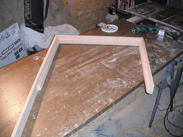

Once I got back to work I started on the bed supports instead of finishing the drawers, they were the reason for screwing up my back so I was keeping a close eye on them.
After getting it cut and fitted it was removed and epoxy/screwed together and a coat of epoxy all over and set to dry.
