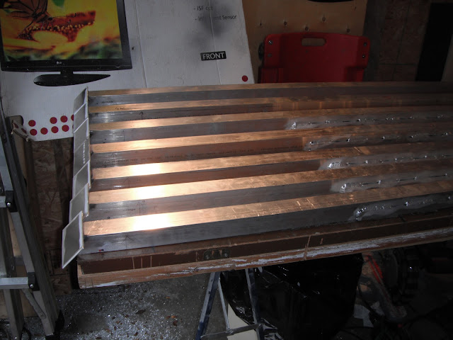

What I came up with was to build a roof rack exo-skeleton type of thing, so I started with the cross beams,
These are pre-stressed with an arch and while they were arched an ell bracket was welded on in the middle of the span for attachment. The extreme heat while welding made them stay in the arch with a 1/2"+ deflection from flat.
End caps welded on, I made them long to be able to flex them a bit to fine tune the mounting of a rub rail and trim piece, note also the holes drilled for water egress.
Here they are almost ready to be installed.

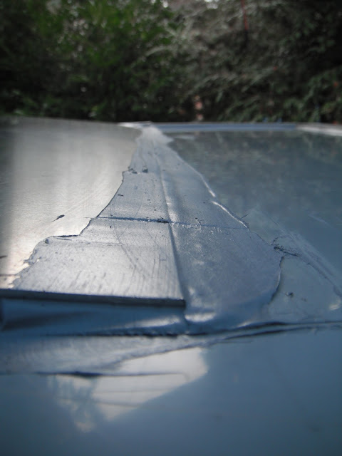

And the leading edge of the sheet was Sikaflexed onto the roof and also tapered to smooth the transition to the roof.
Then on went the uni solar flexible stick on panels, stuck onto the camper roof at the leading edge and onto the aluminum sheet on the rest which in my crazed mind gave me the ability to still get under the panels if needed and having the front stuck onto the roof would ensure it can't fold back in the airflow while driving. Under the aluminumsheet I filled the void with foam to eliminate and slapping while driving.
