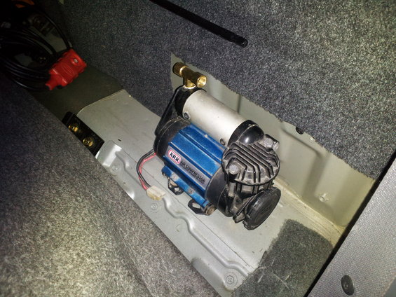

So I had a little time yesterday and a little time today to start on the compressor install. I had spent alot of time trying to figure out how and where I wanted to mount the compressor. I finally decided to put it behind the back seat. There is just enough room on the floor to mount it between the back seat and the back of the cab. This will definately keep it away from the elements and heat. (my first concern). The next thing I was worried about was vibration/noise. This lead me to try the following approach.

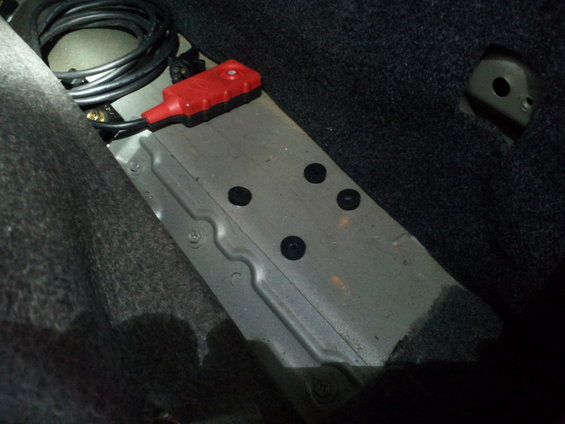

I picked up some "well nuts" from Lowes.
I figured four will be plenty solid to hold the compressor steady, and the rubber housing should help isolate things.
Bolted down the compressor bracket.
Finally bolted down the compressor.

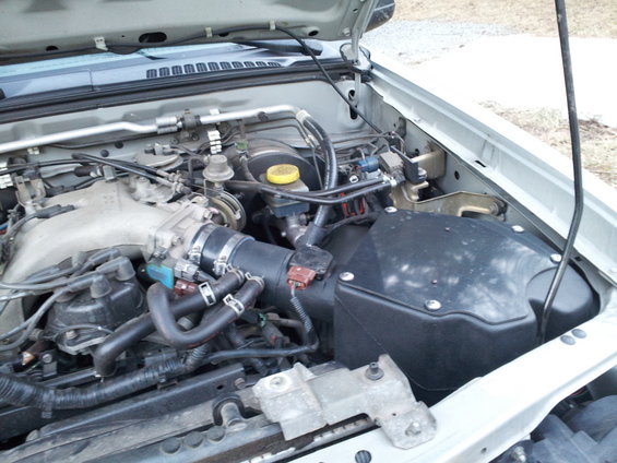

Finally found a a used Volant cold air intake in my price range, so i snatched it up and got it installed yesterday. Very easy install .

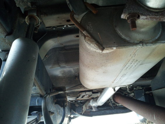

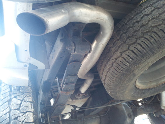

I went ahead and got some custom exhaust installed on the truck. I went with 2-1/4" pipe from where the two pipes come together just behind the cat's.

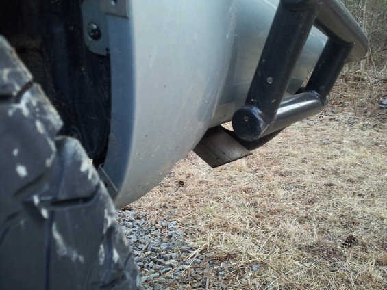

Chose a Flowmaster 40 series muffler and tucked the exit up high and tight near the bumper.
