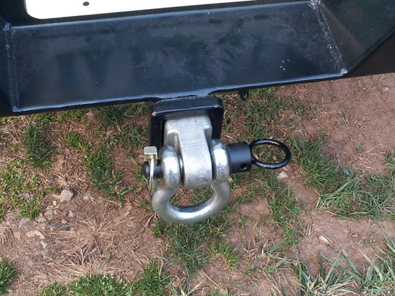

I picked up one of those hitch mounted clevis' the other day. I liked it pretty well , but everything needs some kind of modification right ?
Did some tweaking.....

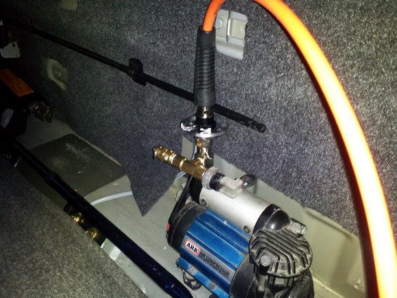

Finally got around to finish up wiring the power to the aux. use panel. This was all I was lacking to get the compressor up and running.
I picked up one of scoshe kits with some heavy gauge power wire and an inline fuse to run the power to the aux. fuse panel. Picked up power direct from the battery and went through the firewall and under the carpet ,
Anyway I was excited to try out the compressor. With power now to the compressor all I had to do was mount up the ARB Pump Up kit.
Gonna be great to have the piece of mind of having a reliable air source to air back up when I get back to the pavement.

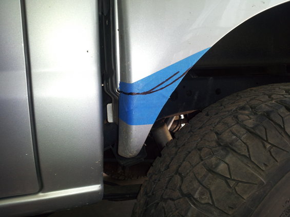

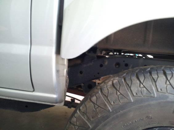

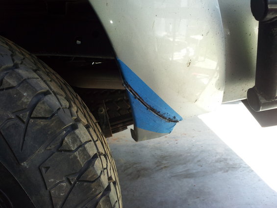

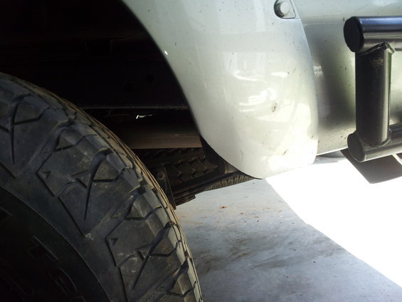

A couple weeks ago I was out playing a little bit and starting noticing the rear tires making contact with the fender flares under full tuck. At one point the right rear must have contacted pretty good and pulled the flare loose from one of the mounting screws. I didn't want to risk completely ripping off a flare so I did a little creative trimming.
The contact was happening at the very front bottom of the flare and at the rear bottom of the flare. So here's what I came up with.

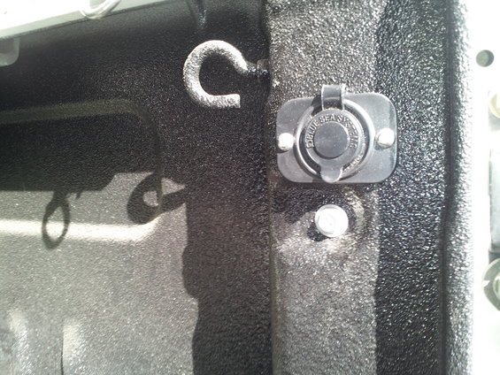

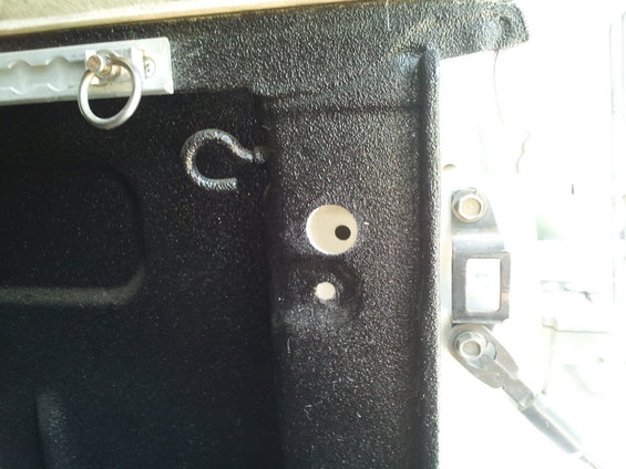

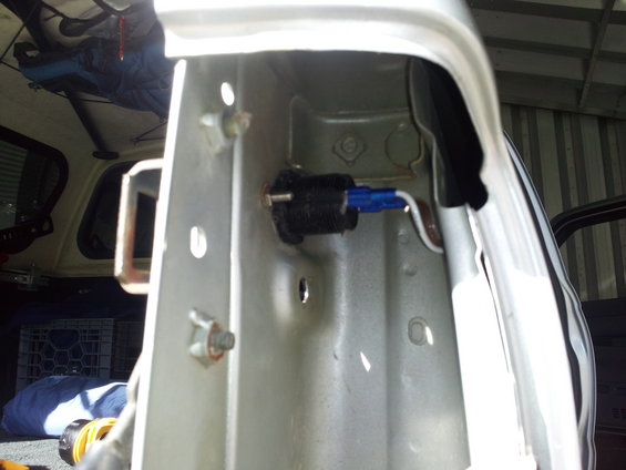

I needed to come up with a way to power my edgestar fridge while in the bed of the truck , so I picked up a aux. outlet from Blue Sea to mount in the bed.
Found a decent spot to mount it at the rear corner of the bed , picked up a hole saw to cut the hole.
The hole comes out into the recess behind the taillight which made the perfect place to cleanly hide the wiring.

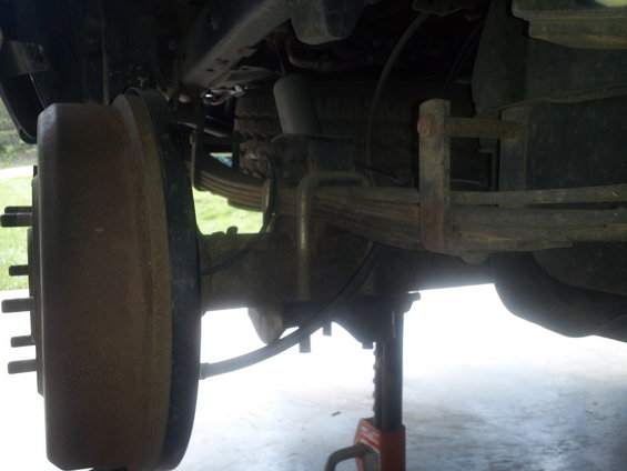

Serviced the truck this week, so I decided I better rotate the tires today. I was VERY disappointed to find the reason for the recent list I had noticed in the trucks stance. AC 3 leaf , add a leaf pack is already ******t canned. Less than a year old.:violent-smiley-031:
Has anyone running AC stuff had this problem? Do they offer any warranty?
The other side is not nearly as pronounced but is definitely on its way out.
I am very unhappy. And will not be replacing with AC stuff. So lets hear it with some recomendations.
I have run Deavers in my crawler for years with zero problems and excellent performance. So I'll be checking with them first, but would love to hear what is working for others.

Old Man Emu MD leaf pack with 1.5" shackles or OME HD leaf pack. Nice ride, great load carrying abilities, and they're bulletproof. Definitely flexier and better quality than stock. Straight bolt in job.
partsflyin
Hey Diver how much lift did you net with that set up ? I reread your thread last night and found that you saw 1" from leaves but I missed the final height after addition of the shackles. Thanks for the input .
After a couple hours searching last night , I was coming to the conclusion that the OME setup was going to be my best bet. Just concerned that I wont get enough lift for my tire setup.
I suppose I could go with the OME leaf pack, shackles and a 1" block . I would much prefer to get by without a block though.

OME has an add a leaf for their XJ leaf springs. Maybe there is an add an leaf they could supply for your application.
Sent from my SCH-I510 using Tapatalk 2
I have OME MD leafs and 1.5" AC shackles. That setup got me 2.25" overall. I know Co-opski got 2.5" out of his HD OME packs.
Co-opski
I'll have to check what they settled out to. The HDs still ride ruff but they can hold a ton of weight. No problems with the leafs themselves but I may need to replace the bushings as they are getting old now and have 80k miles on them. I replace the Ranchos that I put on at the same time last spring with some Bilstiens and they did well through the winter.
